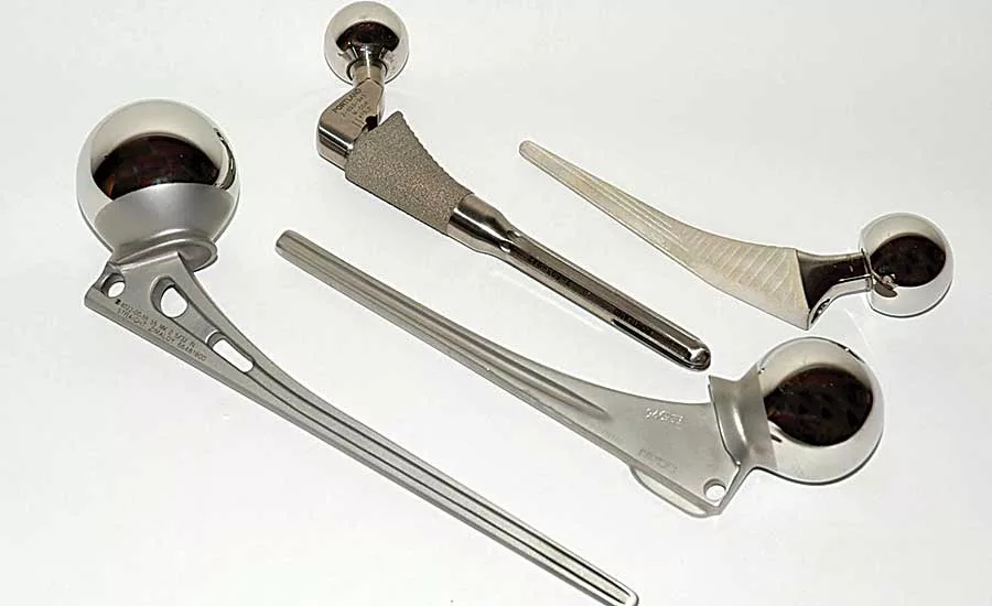

Titanium has long been established as being safe for use in devices such as these hip replacement joints. But, engineers may need to be concerned about the biocompatibility of any coatings that are applied the parts. Photo courtesy IMR Test Labs

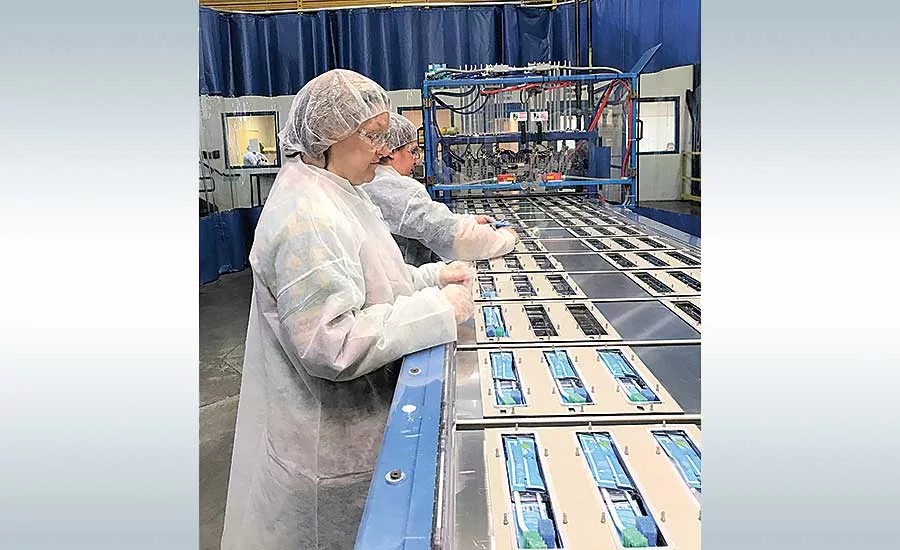

Biocompatibility testing must be done on the fully assembled, packaged and sterilized device. Photo courtesy Deufol North America

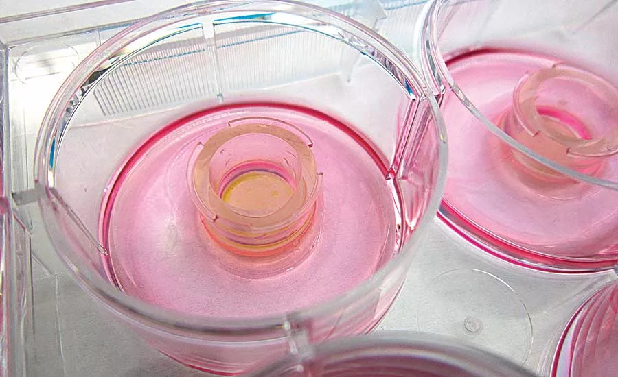

Biocompatibility assessment can include tests for genotoxicity, hemocompatibility and pyrogenicity. Photo courtesy Nelson Laboratories LLC

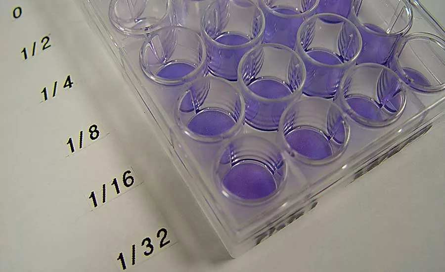

ISO 10993-1-2018 may enable manufacturers to skip some biocompatibility tests—as long as they can provide solid evidence for doing so. Photo courtesy Surgical Materials Testing Laboratory

Biocompatibility testing is done on the final device design, rather than parts or prototypes. Testing must be done on the fully assembled, packaged and sterilized device.
