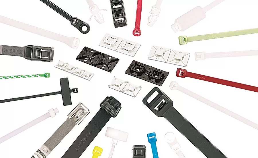

With one global standard for wire management products, suppliers can spend less time on testing and keeping up with documentation. Photo courtesy Panduit

The ERT3M-C20 releasable cable tie is UV-proof and highly flexible. Photo courtesy Panduit

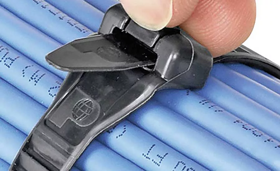

The Pan-Steel self-locking cable tie installs quickly thanks to a unique self-locking head design that locks into any part of the tie. Smooth surfaces and rounded edges are safe for both the cable and the installer. Photo courtesy Panduit

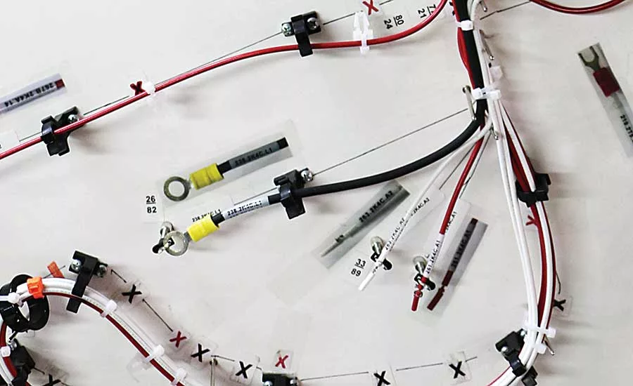

When countries around the world establish different standards for wire harness components, harness manufacturers are forced to test multiple products for multiple markets. Photo courtesy IMS Electrol
