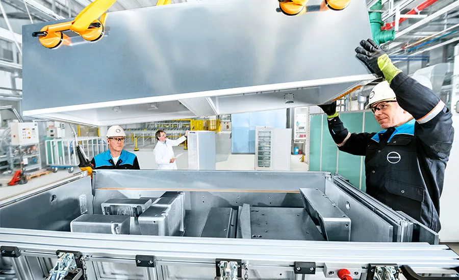

OEM Foaming Operation
Insulating household refrigeration cabinets and doors with polyurethane foam is a unique process at the OEM. It is the step between the pre-foam assembly operation, which creates the metal shell, wiring, lights and liner, and the final product assembly operations, where the doors, compressors, evaporators, and other components are added. In the insulation step, the OEM combines liquid polyurethane raw materials to make the finished polyurethane foam.
The pre-foamed cabinet or door is placed within a fixture to limit the expansion of the polyurethane foam. During the foaming process, the interior of each cabinet and door is where the chemicals react and the polyurethane foam is produced. The raw material suppliers will generally establish process conditions for the OEMs to allow manufacturing of the correct finished product with the required properties.
The total residence time in the foaming operation may be relatively brief, but many things happen during the process. Before the raw materials are pumped into the cabinet or door, the part is brought into the fixture, the fixture closes and then the mixhead is aligned. The raw materials are then metered, mixed and automatically poured. The pour generally takes less than five seconds. The reaction begins with mixing and the foam flows and fills the space between the inner and outer shells in less than 30 seconds. The thickness of the cavity and what the cabinet designer has placed within the cavity and the cavity configuration largely influence what happens in those few seconds between pour and fill.
There are many processes occurring simultaneously when a cabinet is filling with polyurethane foam. Polymerization of the raw materials is occurring, carbon dioxide is being generated by the reaction of chemicals and water, heat is released from the reactions, and the physical blowing agent is being vaporized. This causes bubbles to form within the liquid. The gases within the bubbles expand due to heat. The air in the cavity is displaced as the foam expands, and the viscosity of the foam increases as the reactions proceed toward completion and the liquid raw materials react and turn into a solid foam.
After the foaming process, the cabinet and door stays within the fixture for a specified amount of time (typically two to seven minutes) before it is demolded. The time between the initial shot of liquid raw materials until the fixture is opened so the part can exit is the demold time for the part. After demolding the part, the fixture is opened, the part removed, and the process repeats with the next part. The total residence time may be five to 20 minutes, with the demold time comprising a portion of the total residence time.
