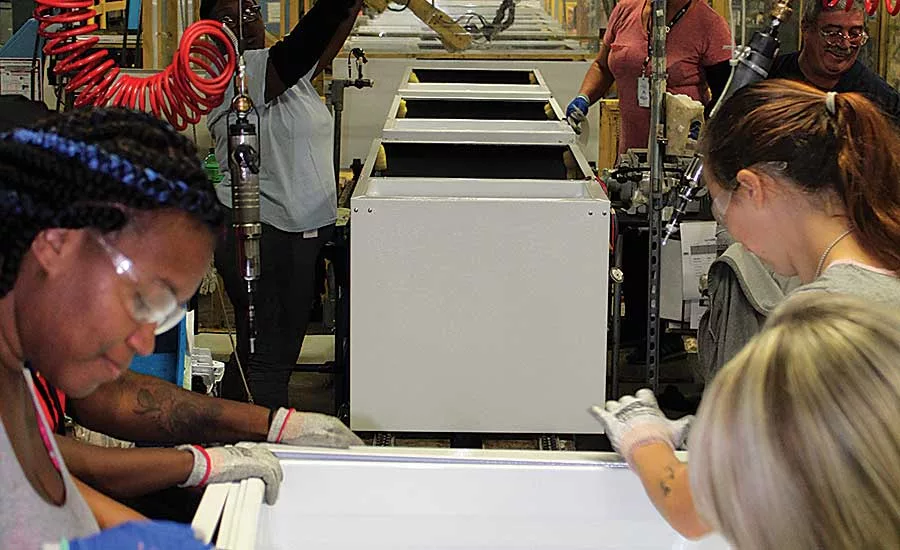

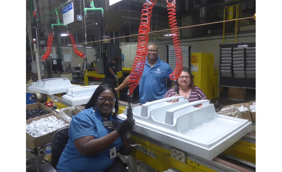

Engineers maintain a list of assembly tasks that present ergonomic issues or challenges, such as excessive bending and awkward postures. Photo by Austin Weber
Refrigerator Production Heats Up at GE Appliances

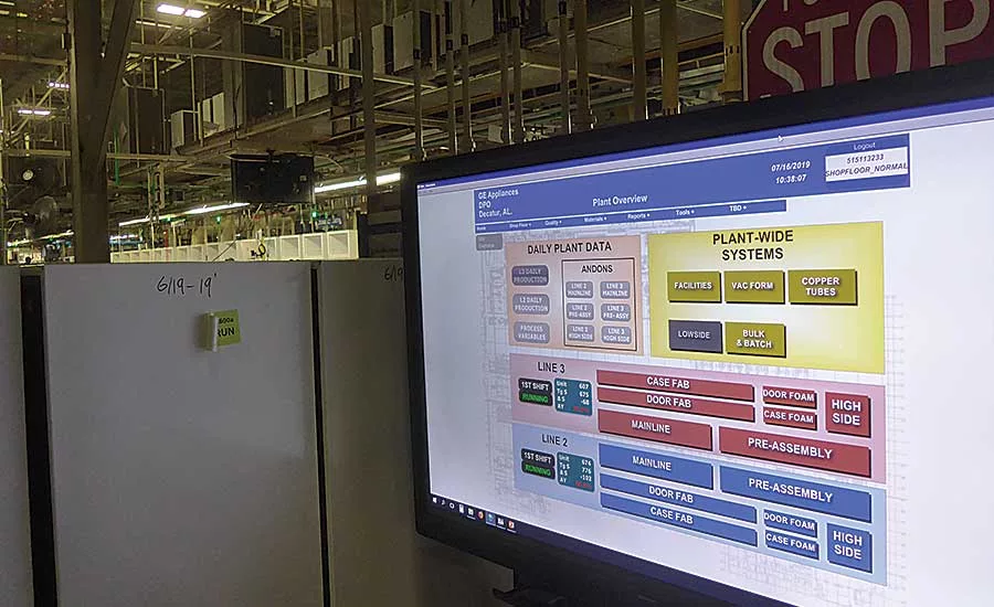

The 2019 Assembly Plant of the Year recently unveiled 55-inch electronic smart boards along its main assembly lines. Photo by Austin Weber

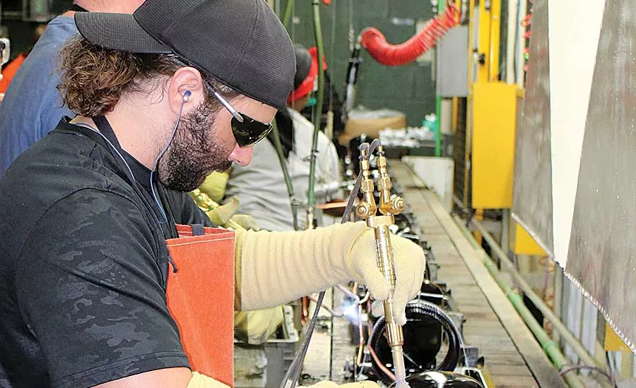

Brazing is an important step in the refrigerator assembly process. Photo courtesy GE Appliances

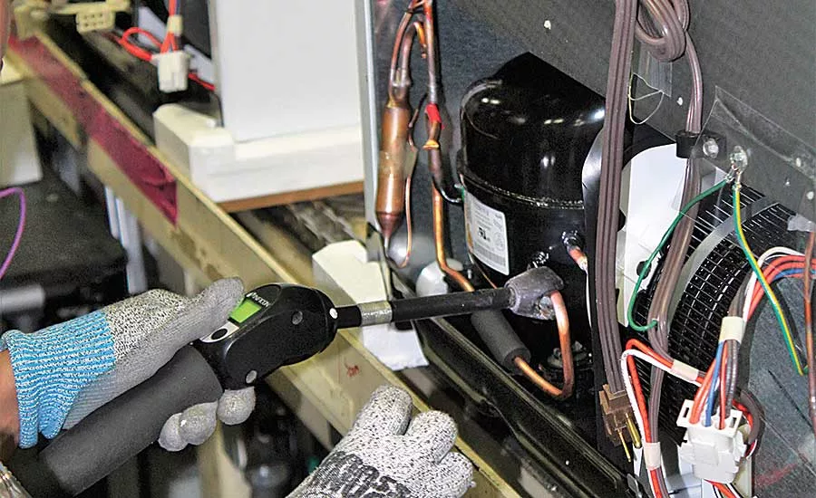

At the end of the final assembly line, each refrigerator undergoes a series of tests, including helium leak testing. Photo courtesy GE Appliances

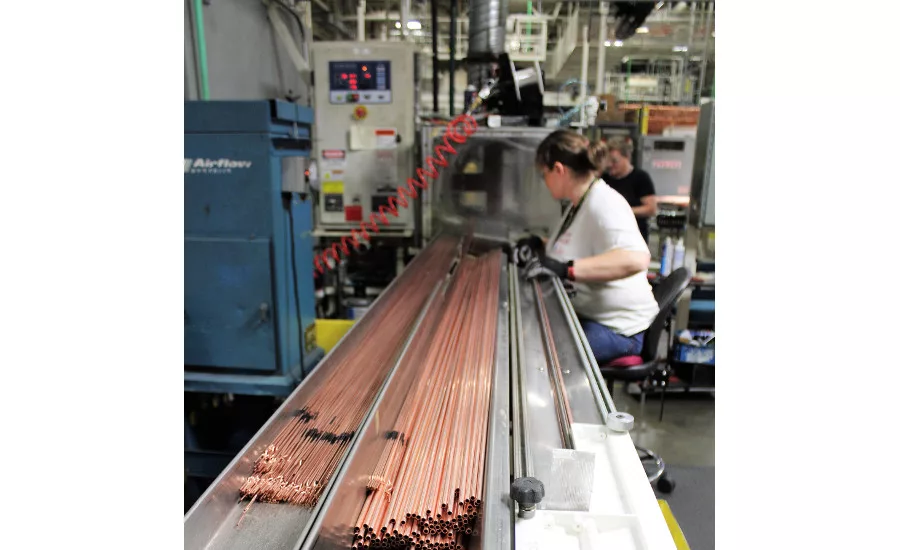

Many parts, such as copper tubing, are produced in-house at the 2019 Assembly Plant of the Year. Photo courtesy GE Appliances
2019 Assembly Plant of the Year: Refrigerator Production Heats Up at GE Appliances

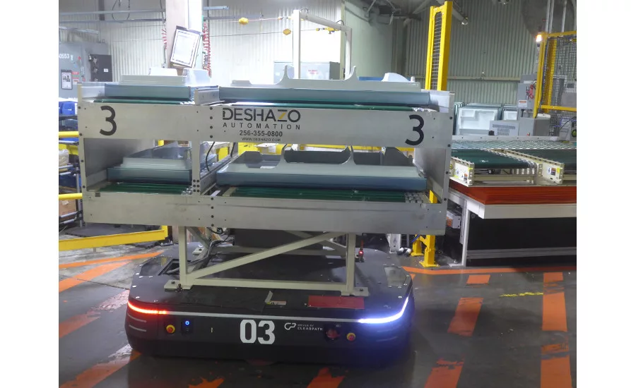

GE Appliance Decatur uses automated guided vehicles to transport refrigerator doors through fabrication, foaming and assembly. Photo by Austin Weber

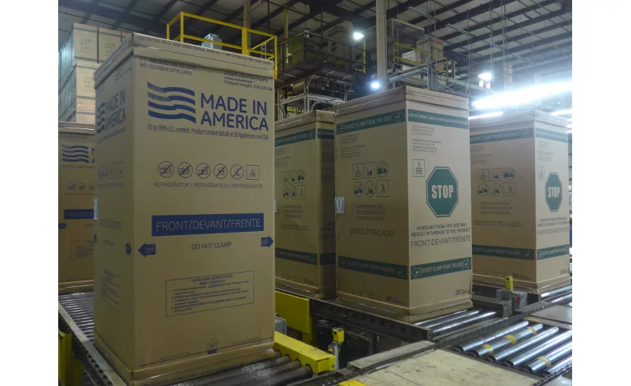

The 2019 Assembly Plant of the Year is attached to a large warehouse that ships refrigerators by rail and truck. Photo by Austin Weber

The plant also is a leader in applying data analytics, lean manufacturing and vertical integration to produce several different sizes of refrigerators. And, the facility has invested in state-of-the-art automation, such as robotics and automated guided vehicles (AGVs), to address issues related to ergonomics and material handling.

The Decatur factory is also attached to a large warehouse via an enclosed conveyor. The facility, which can hold three days of inventory, ships to customers by rail and truck.
Some refrigerators are shipped directly to large customers, such as big-box stores like Aaron’s, Home Depot and P.C. Richard & Son. Other large customers include Best Buy and Home Depot; hotel chains such as Hilton and Marriott; apartment management companies; new home builders; and public housing agencies. Products not shipped directly to customers are sent to one of GE Appliances’ nine distribution centers located throughout the United States.

Copper tube processing. Automated equipment takes four sizes of wound copper coils and cuts each to length for parts needed to assemble refrigerators elsewhere in the plant. The copper tubing ranges in length from 5 inches up to 80 inches. Some of the tubing is used to produce an in-house soldered and formed assembly that is delivered directly to the case assembly lines. Swaging is also used to form tubing down to around one quarter of its original size.

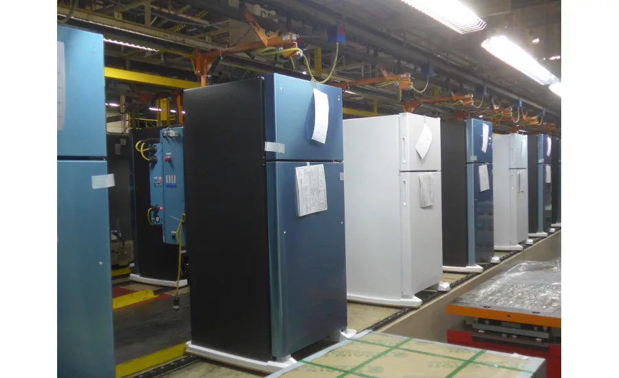

GE Appliances’ Decatur plant mass-produces several types of products under both the GE and Hotpoint labels, including 16-, 17- and 18-cubic-foot refrigerators, with future production of 19- and 22-cubic-foot models within the next few month. Each of the different models share similar parts, components and architectures.

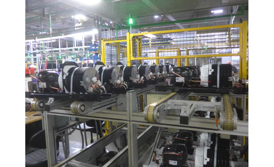

All refrigerators use a reciprocating compressor located in the bottom rear section of the unit. A control system runs the compressor, plus the fans of the condenser and evaporator, to regulate temperature. Refrigerators also have heaters that remove frost from the evaporator to keep cooling coils clean.

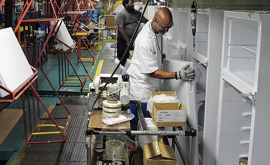

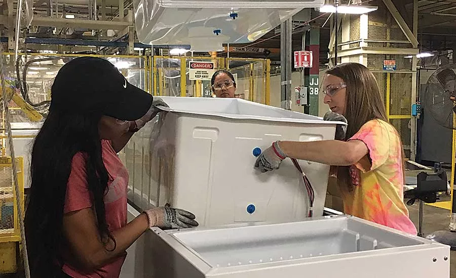

Two flexible, main assembly lines in the plant are fed by a variety of subassembly lines that produce cases, doors and compressors. Operators on the case fabrication lines perform tasks to prepare the cases for the foaming operation, such as installing plastic liners, while robots bend tubes and apply hot-melt adhesive. On the door line, operators install gaskets, dairy doors, door stops and shelf fronts.
A compressor assembly area feeds into each case line. In this department, operators attach components, connect tubing, manually braze sealed system joints and perform leak checks.

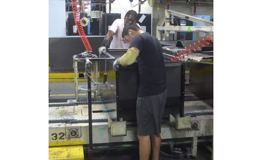

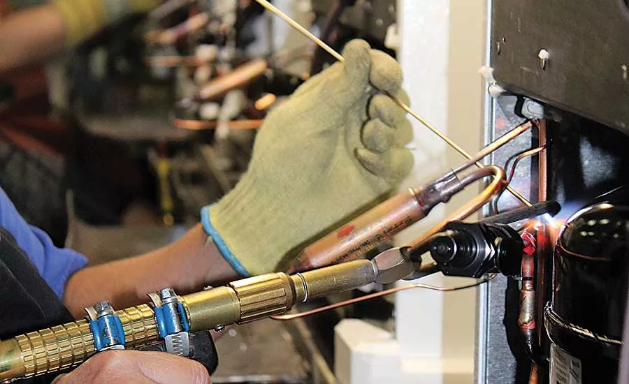

An important task involves assembling the sealed system, which is made up of a compressor, condenser and evaporator. This subassembly is the heart and soul of a refrigerator, enabling it to operate efficiently by removing heat and providing a cooling effect.
“The sealed system requires a hermetic seal to be formed in multiple places between several types of metal, including aluminum, copper and steel,” says Chet Innamorati, senior director for manufacturing quality. “We use flame, induction and ultrasonic brazing to join different parts of the sealed system.
“The operation must be perfect for the refrigerator to cool properly,” explains Innamorati. “Any break in the door gasket seal to the case can cause moisture and frost in the unit.”

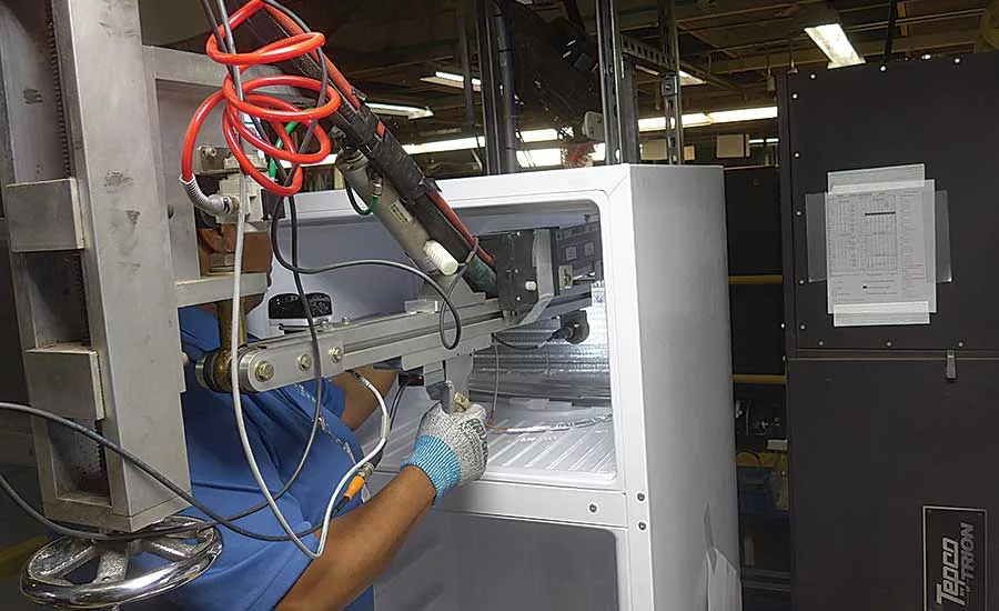

“Brazing is an important activity on our assembly line,” adds David Royer, director of assembly operations. “It takes a highly trained operator to maintain high yields. To minimize operator dependence, we use induction technology for some brazed joints. Once the brazing process is complete, operators conduct rigorous testing of the sealed system.
“Another challenge is matching doors to cases,” says Royer. “What is unique about this is that we really have two plants in one.  We have a door factory and a case factory.”

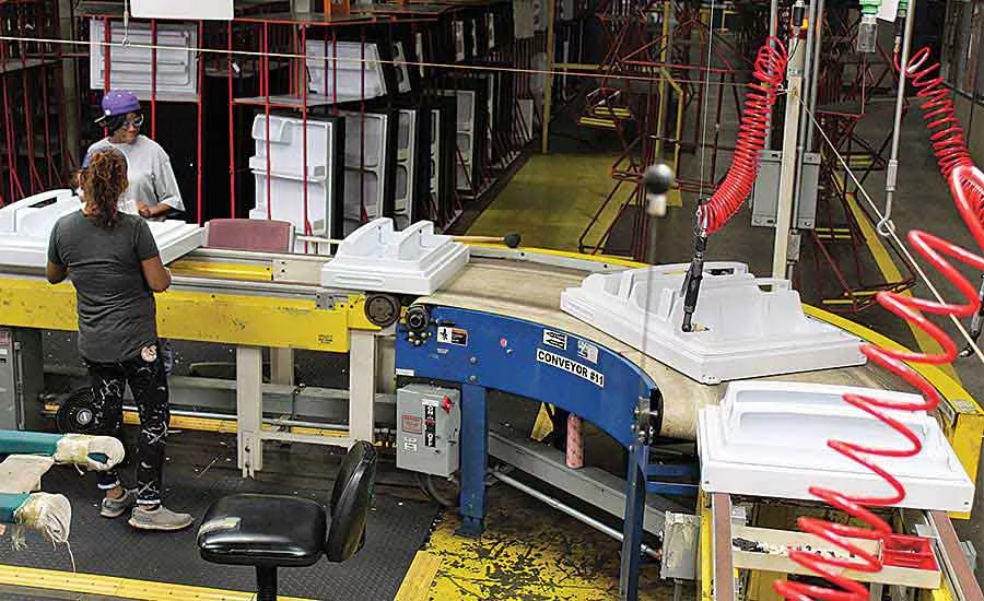

Many types of conveyors are used throughout the Decatur plant, including chain-driven live roller, drag chain, friction, monorail, overhead and slat varieties.
After cases are fabricated and filled with structural foam, they travel down a conveyor horizontally where operators install the compressor assembly, mobility wheels and skidboards. Cases are then transported vertically to the final assembly lines via an overhead conveyor.

Refrigerator cases travel on pallets down conveyors in an upright position. The high-speed main assembly lines resemble activity typically found in automotive factories. For instance, operators work on both sides of the conveyors and doors aren’t attached until the end of the line.
Assemblers first install compressors, condensers, wire harnesses and other mechanical components at the bottom and back side of refrigerators. Next, they insert electronic control boards, fans, heat exchangers, ice makers and lighting. Drawers, shelves and other food storage compartments are installed last, followed by doors.
A variety of fasteners are used to attach interior components and panels that cover openings in the back of refrigerators. Operators drive screws with cordless, DC-electric and pneumatic tools. DC-electric tools are used for safety- and quality-critical fasteners. They are interlocked to the assembly line and are programmed to halt production if the correct torque is not measured.

One recent robotic application involves bending copper tubes used in condensers. The robots ensure consistent bending and allow for increased flexibility. For instance, when new tube bends are needed to align with a new condenser or compressor, the robots can be easily reprogrammed to meet the new configurations.
The Decatur plant recently invested in AGVs to transport refrigerator doors through fabrication, foaming and assembly. Each autonomous platform can transport two doors at a time and uses powered rollers to interface with traditional, fixed conveyors.
The fleet of machines has helped improve quality. In addition, the AGVs have eliminated scrap and rework on doors, which need to avoid scratches and dings to maintain their cosmetic appearance.
“The AGVs eliminated an ergonomic risk associated with handling heavy doors, eliminated a quality risk of potentially damaging doors, and resulted in a cost savings and improvements in labor productivity,” says Story. “We are now looking at using the technology to improve material flow in other parts of the plant, such as the movement of racks of copper tubes and racks of gaskets.

For instance, the plant has invested in numerous lift-assist devices, such as a compressor assembly manipulator that makes it easier for operators to install the heavy component into cases.
“We actively maintain a list of ergonomic-related, high-risk jobs to ensure that we focus on reducing risk from cumulative trauma and ‘ergo red’ jobs,” explains Jenkins. “One of our next projects will be automating our back and bottom install process, which has been a legacy concern for us.”
The Decatur plant has also invested in advanced software to leverage real-time production data and optimize assembly line operations. Last year, it upgraded its IT infrastructure to create an enterprise network capable of supporting Industry 4.0 technology. The $1 million investment provided redundant connections with GE Appliances’ corporate data center and the Internet. It also increased WiFi coverage and saturation to include 100 percent of the factory floor.
The 2019 Assembly Plant of the Year recently unveiled 55-inch electronic smart boards along its main assembly lines. The touch screens replaced manual hour-by-hour tracking charts, which were physical whiteboards. Team leaders now input data electronically each hour, with a focus on daily quality and production metrics.
Its part of GE Appliances’ Brilliant Factory initiative that collects real-time information and presents its on informative display boards located throughout the factory. The system provides information such as production scheduling, assembly yield, quality and test yields, and workforce capacity.
“This allows us to retain the data electronically, track trends, respond quickly and ensure we are prioritizing resources on the most impactful projects,” says Chad Sockwell, senior manager of digital technology. “We are also enhancing our existing Brilliant Factory platform to provide information to our leaders on the floor. The mobile-ready application provides production data, attendance and other tools to help our leadership team make the most appropriate decisions in real time.”
