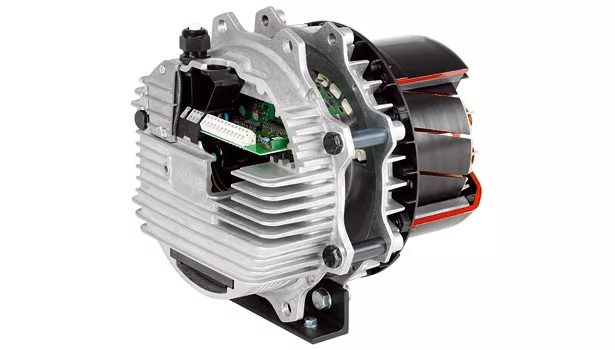

EC motors are brushless DC motors with external electronics. The rotor contains permanent magnets and the stator has a set of fixed windings. A circuit board continually switches the phases in the fixed windings to keep the motor turning. Because the speed of the motor is controlled by the commutation electronics, these motors are not limited to synchronous speeds. DC motors and EC motors have typically been reserved for smaller power output applications, filling such applications as small fans, pumps, servomotors and motion control systems. However, advances in electronics and materials are allowing larger output motors, up to the 12kW and higher. These motors are now finding homes in everything from small appliances to conveyor belts, and large rooftop condenser units.

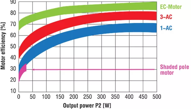

As mentioned, efficiency is the most common reason for choosing an EC motor over an AC motor. With an EC motor, the commutation is done by the electronics reducing the losses internal to the motor. (Chart 1 shows the efficiency of each motor type.)

Since efficiency is improved, a smaller motor size may be used to achieve the same power output. A smaller motor also equals lower weight, and more space makes for a smaller product or more room for additional features. Many EC manufacturers also offer external rotor designs rather than shafted motors, and their compact design allows for even more space savings.

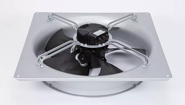

Multiple motor operation: In systems such as rooftop condensers, it’s possible to program one fan as the master and control the remaining fans. All the logic can reside in the motor, eliminating the need for a separate controller.
