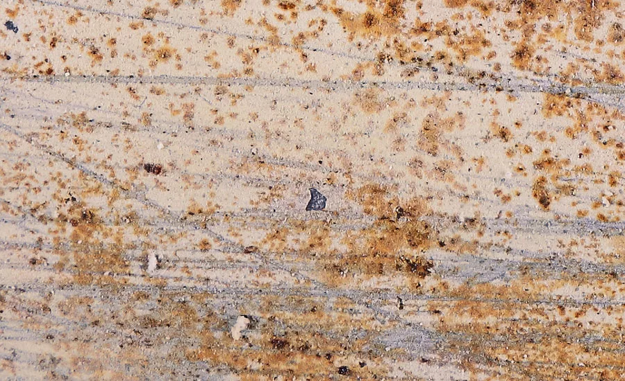

It is instinctive to think that stainless steels should never corrode, given their auto-passivating quality, yet they are not completely impervious to rust. Crevice corrosion, ferritic contamination at the surface, and passivation issues are causes of corrosion in stainless steel.
  • Crevice corrosion. A tight corner in a component’s geometry or a rough surface of a component can cause it to retain moisture and inhibit oxygen from reaching the material’s surface. Without a constant supply of oxygen to auto-replenish, the passivation layer is weakened.  Resolving this issue requires a redesign of the geometry of the part, perhaps eliminating sharp corners where corrosion is observed by adding/increasing radii, or improving the surface finish of the part.
  • Ferritic contamination at the surface. This form of corrosion (commonly known as “pitting corrosion”) occurs when residual iron is left on tools, containers, and other equipment used by a manufacturer to process carbon steel parts. This residual iron – known as “free iron” – can become embedded in the surface of stainless parts on contact. Free iron inhibits the formation of the passivation layer, leaving the base stainless steel material exposed to the environment.
  • Passivation issues. To ensure a stainless part continues to resist corrosion after manufacturing, the part must be passivated in post-processing.  Passivation, a cleaning operation, removes contaminant on or just below the surface of stainless steel parts. Once the contaminant is removed, the passivation layer again has a chance to reform and make the component inert to corrosive reactions.

Copper sulfate testing is possibly the most common of the three tests because it is quick and very economical.  The sole material required is a copper sulfate solution, which is continuously swabbed over the surface of the part for at least 6 minutes.
However, this test is not suitable for the detection of ferritic contaminate in 400 series stainless steels because the composition of 400 series stainless will lead to false positives.  In such cases, it is more appropriate to conduct a high humidity test.
High Humidity Testing
High humidity testing involves placing parts in a sealed chamber, the atmosphere of which reaches and a temperature of 100˚F and humidity levels near 97%. Test specimens are left in the chamber for a full 24 hours.  Parts that pass this test exhibit no signs of rust or staining at the surface.  This test is universal to all types of stainless but necessitates purchasing, calibrating and maintaining a humidity chamber, which can be expensive.
