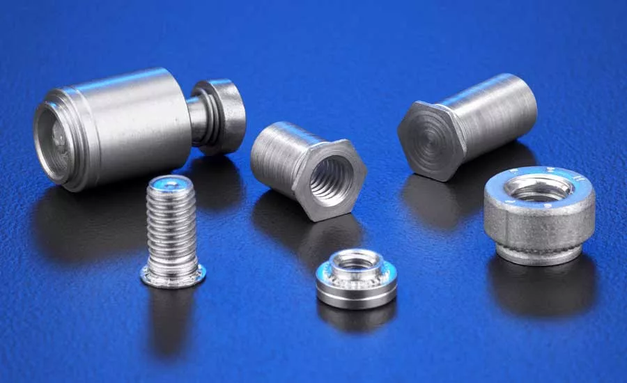

Ensure that the fastener is harder than the sheet in which it is installed. A prevalent misconception is that all stainless self-clinching fasteners will perform as intended in all stainless-steel sheets, regardless of the relative hardness of fastener and host sheet. This is not the case, based on how and why self-clinching fasteners install.
All self-clinching fasteners install permanently by pressing them into place in a properly sized hole and then applying sufficient squeezing force. The fastener’s serrated clinching ring, knurl, ribs, or hex head is consequently into the panel surface, displacing sheet material into a specially designed annular recess in the shank or pilot of the fastener, known as an undercut. The metal displaced into the undercut secures the fastener against axial movement, while a non-round displacer secures the fastener against rotation to result in the fastener’s permanent installation.
Due to the requirements of this process, the fastener must always be sufficiently harder (typically 20 points on the HRB or HB hardness scales) than the host material to ensure proper and permanent installation. Sheets, too, must be in the annealed condition to allow the displaced sheet material to cold flow into the fastener’s undercut without fracturing.
The conclusion is that stainless steel self-clinching fasteners made from 300 Series cannot be expected to perform reliably in 300 Series stainless steel sheets (the fastener must always be harder). Ultimately, stainless steel self-clinching fasteners made from special-alloy or precipitation-hardened materials will provide the best overall performance installing into stainless sheets.

Choose the proper fastener type and style for the application. Significant strides have been made over the years in developing “stainless for stainless” clinch fasteners to meet application requirements, whether for basic component attachment, stacking or spacing, or opening the door for subsequent access to assemblies. Among the notable families in the stainless clinch fastener category:
  • Stainless self-clinching nuts provide strong load-bearing internal threads to accept mating screws. Upon nut installation, the reverse side of the sheet will flush and smooth. Styles include types with reduced outer dimensions and thinner sheet capabilities than standard and “floating” versions to compensate for mating hole misalignment, among other examples.
  • Stainless self-clinching thru-hole threaded standoffs and blind threaded standoffs enable components to be stacked or spaced in an assembly. (Unthreaded types have been introduced for spacing multi-panel assemblies.) These fasteners are installed with heads flush with one surface of the mounting sheet and, in the case of blind styles, the outer sheet surface is both flush and closed.
  • Stainless self-clinching flush-head studs mount flush in stainless sheets and include types demonstrating especially high hardness and corrosion resistance properties.
  • Stainless self-clinching captive panel screws represent a new generation of “access hardware” for stainless applications. These complete, spring-loaded assemblies meet UL 1950 “service area access requirements” and their captive-screw design removes handling and installation issues associated with loose screws.
The portfolio of stainless self-clinching fasteners has further been augmented to include studs with externally threaded attachment points, swaging collar studs to accommodate multiple panels, fasteners enabling flush “face-on-face” sheet attachment in stainless steel, internally threaded floating nuts to allow for mating hole misalignment and locking threads, and “micro” pins and studs ideally tailored for compact consumer electronics applications.
