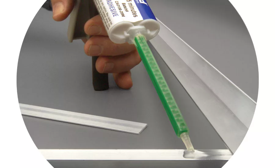

structural-epoxy
Permabond two component epoxy, ET500, bonds corner supports. Source: Permabond

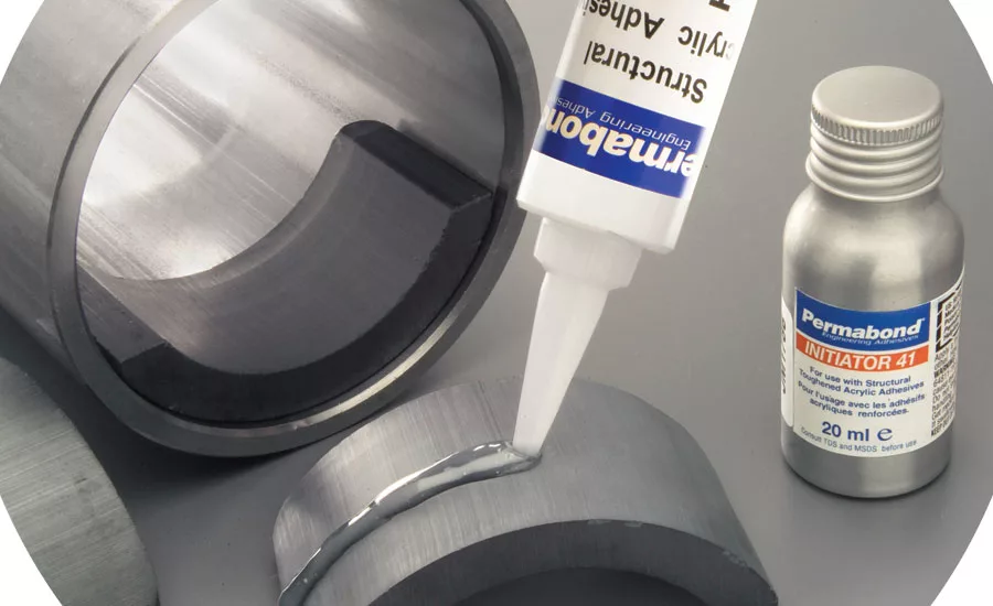

cam--magnets
Permabond TA435, a structural acrylic adhesive, bonds magnets into the cans of electric motors. Source: Permabond

Structural adhesives are designed to increase the strength of the part. When fasteners are used to join two thin sheets, you still have two thin sheets. Bonding the two sheets with adhesives unitizes them, creating a single, stiffer and stronger panel. The overall strength will be higher even if the bond is only on a portion of that panel.

Motor Magnet Bonding
Brittle rare earth magnets used in motor manufacturing originally were designed to be clipped into place. Those clips created stress points that caused the magnets to fracture. Adhesives bond across the entire magnet and distribute the stress across the part, increasing the life of the motor.
Several types of adhesives are available to accommodate the differences in process and strength requirements in motor magnet bonding.
Single component heat cured epoxy adhesives are available in a flowable formulation or as a non sag product. When the adhesive is required to flow into the joint, a bead of flowable epoxy is dispensed onto the top of the magnet up against the can. During the heat curing process, the epoxy flows into the joint before curing. In other applications a non-sag epoxy is applied within the joint and maintains its position during curing.
Toughened Acrylic formulas are suited to applications requiring rapid fixture and strength development time. These offer a fixture time that is generally less than 30 seconds and develop strength rapidly, reducing the clamping time. They are available for application in a two-step process, or as an external mix using precisely positioned nozzles in an automated or semi-automated line.
