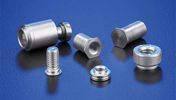

This is an assortment of stainless steel self-clinching fasteners, which must be harder than the stainless sheet where they are installed. All self-clinching fasteners must be sufficiently harder than the host metal sheet for installation and performance in service to be successful. Source: PennEngineering

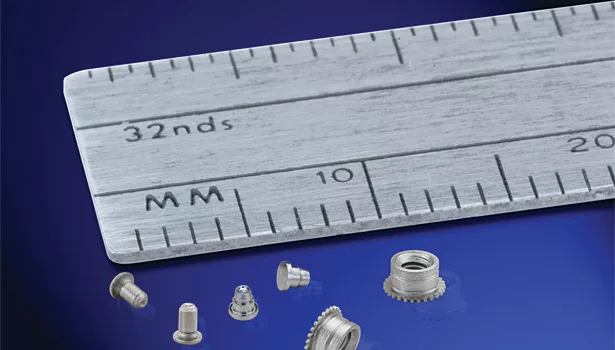

Here are a variety of "micro" self-clinching fasteners, which are extremely small and uniquely engineered for attachment applications in handheld consumer electronics devices. Source: PennEngineering

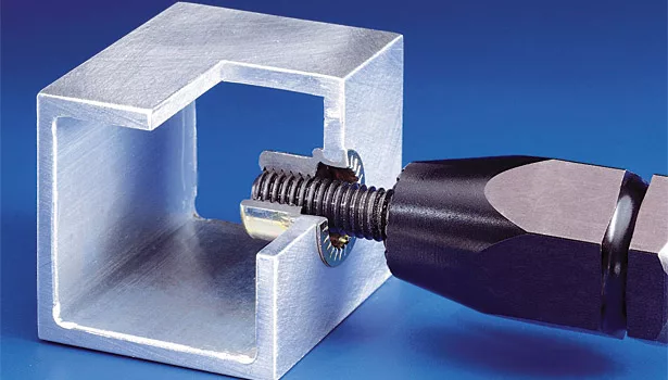

This is an installation of a "blind" threaded insert, which is designed for use where only one side of a work piece is accessible for fastener installation. Source: PennEngineering

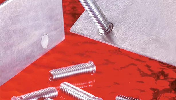

Threaded self-clinching studs (installed and loose) are shown here. Such studs are among the many self-clinching fastener product families suited for appliance applications. Source: PennEngineering

Regardless of type, self-clinching fasteners install permanently in ductile metal sheets as extremely thin as .012” / 0.3mm for uniquely engineered micro clinch versions developed for handheld consumer electronics devices.  Fasteners are pressed into place in a properly sized hole and, when sufficient squeezing force is applied, the fastener’s serrated clinching ring, knurl, ribs, or hex head is forced into the panel surface, displacing sheet material into a specially designed annular recess in the shank or pilot of the fastener, known as an undercut. The metal forced into the undercut secures the fastener against axial movement, while a non-round displacer secures the fastener against rotation. No secondary operations are necessary.

Studs. These externally threaded self-clinching fasteners are generally selected for applications where a component must be positioned in advance of final attachment. Flush-head studs are standard, but variations can specifically satisfy high torque, thin sheet, or electrical applications. Studs without threads can double as permanently mounted guide pins or pivots.

A Sure Tip for Self-Clinching Success Into Stainless
Many mechanical fastener attachment applications in the appliance industry demand corrosion resistance and hardness, while contributing to thinner and lighter designs. Considering self-clinching technology, specific fasteners manufactured exclusively for use in stainless steel have been developed to meet the needs.
But a note of caution: A prevalent misconception is that any stainless self-clinching fastener will perform without fail when installed in any stainless sheet. This is not true. In fact, standard stainless self-clinching fasteners made from 300 Series cannot be expected to perform reliably in 300 Series stainless sheets, due to the relative hardness issue.
Appropriate stainless self-clinching fasteners for installation into 300 Series stainless sheets include types manufactured from 400 Series stainless. Types made from special alloy (precipitation hardened) stainless will offer even higher corrosion resistance. Depending on type, these fasteners can be used effectively in sheets with hardness ranges from HRB 88 to HRB 92.
Fasteners for “Blind” Accessibility Applications
Most fasteners designed to provide permanent load-bearing threads in thin materials require both sides of a work piece to be accessible during installation and final component attachment. For those instances where there is access from only one side, so-called “blind” applications, “blind” threaded inserts provide the solution. And, with inaccessibility no longer an obstacle, these types of fasteners are ideally suited (where other permanently installed threaded hardware is not) for tubing, extrusion and other similar types of applications.
Such inserts are made from aluminum, brass, steel or stainless steel and are designed to be used instead of tapped holes, weld nuts, rivets, and self-drilling or tapping screws. Installed from the accessible “front” side of a work piece, they will provide strong permanent metal threads in metal or plastic sheets as thin as .020” / 0.50mm. As with self-clinching fasteners, “blind” threaded inserts eliminate any need for additional hardware beyond a mating part to complete the attachment process.
A variety of “blind” threaded insert types have been developed, based on common industry usage. These include large diameter and low-profile head designs for enhanced strength, types for use in any material thickness, and heavy-duty styles enabling sheet-on-sheet attachment, among many others.
