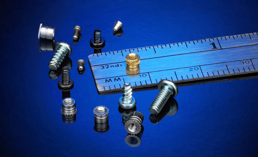

Here are a wide variety of the many different types of micro fasteners. Source: Penn Engineering

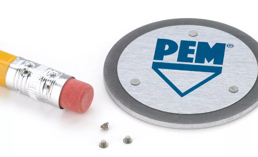

This is a new patented self-clinching fastener designed for stainless steel or higher strength aluminum alloy sheets. Source: Penn Engineering

Entire families of micro fasteners provide practical solutions. These fasteners—threaded or unthreaded—have been developed to resolve the various design challenges and have certainly evolved well beyond screws.
As an example, a particular type of self-clinching micro pin can be specified to permanently attach two metal surfaces (aluminum, steel, or stainless steel) in much the same way as a screw. But, unlike a micro screw, this fastener will eliminate the need for a locking patch and mating hardware—helping to reduce assembly steps, parts counts, and weight in an assembly. And the fastener permanently joins to suit those applications where subsequent disassembly will not be a consideration.
This micro fastener offers other assembly and production advantages, too, over micro screws. The hardware exhibit higher strength against pullout compared with threaded micro screws of the same length; eliminate costly tapping, potential cross threading, need for torque control, and the issue of vibration back-out associated with micro screws; feature tapered tips to assist in accurate location before permanent installation; and can be installed automatically—saving time and money in the process. The fastener further can facilitate streamlined designs, because they are relatively smaller and weigh less than micro screw counterparts.
Many other types of micro fasteners are making their mark and, regardless of type, designers should understand that these extremely small fasteners are not simply scaled-down versions of their larger counterparts. When fastener types are downsized to lengths as short as 2mm, thread sizes as small as M0.8, and diameters under 1mm, issues relating to tight tolerances and performance values, among others, become magnified. Unique features engineered into a micro fastener become both critical and essential with specialty design coming into play.

  • Unthreaded broaching micro fasteners can attach top panels of any material (as thin as 0.2mm / .008”) securely to a base panel or chassis manufactured from common magnesium die-cast materials (such as AZ91D) or plastics (such as ABS). From a design perspective, their unique diagonal knurl effectively holds the top panel to a base panel or chassis by broaching into the base panel/chassis using a simple press-in action without requiring heat or ultrasonic operations.
  • Self-clinching micro fasteners (building on micro pin designs) incorporate a unique thread-like feature to allow fastener removal when necessary. The fastener can be twisted out (unscrewed) and reinstalled one time using a thread-locking adhesive. These fasteners enable sheet-to-sheet attachment by simply pressing them into place. The fastener clinches into the base panel and its head holds the top sheet (as thin as 0.2 mm / .008”) firmly and permanently in place.
  • Unthreaded self-clinching micro locating pins are designed for locating, positioning and/or alignment applications. Standard versions are manufactured from age-hardened A286 stainless steel and designed with diameters as small as 1mm / .040” and in lengths as short as 2mm / .080”.
  • Threaded self-clinching micro standoffs are designed for mounting and/or spacing components in extremely limited space applications. Standard types have been developed with threads as small as M1 / #0-80 and in lengths as short as 2mm / .080”.
