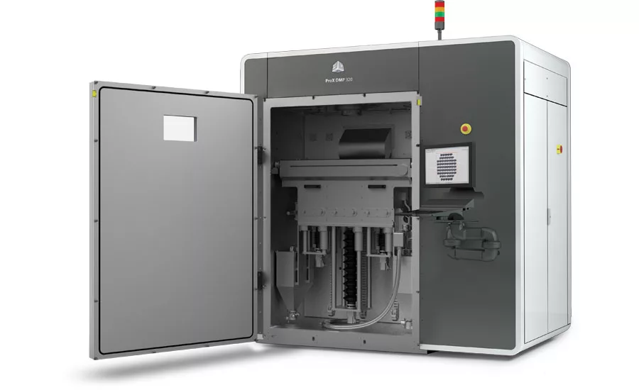

The ProX DMP 320 3D printer is production-ready. Source: 3D Systems

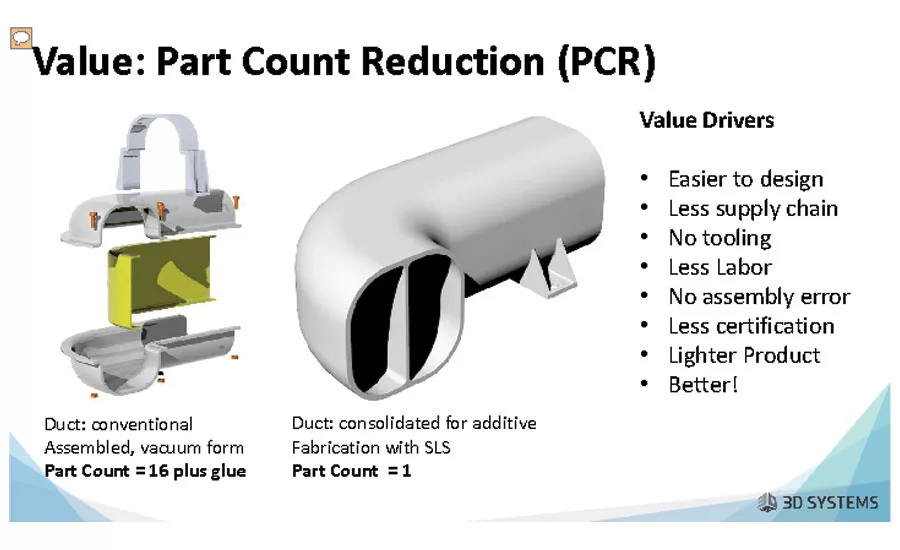

An air duct composed of 16 components made with conventional manufacturing techniques was reduced to a single part using 3D printing. Source: 3D Systems

Taking a part that was assembled from several components and reducing it to one 3D-printed part has obvious benefits like weight reduction. But there are also other value propositions that start from the beginning of the design phase and reach towards end-use safety and reliability.
Take an example air duct. The original, conventionally manufactured design consisted of 16 individual components—the external enclosure, an internal baffle as well as screws and washers. Now, take that part and redesign for manufacturing with a 3D printer: One part, one component. Or, on the other end of the complexity scale, take an example of a turbine blade assembly that was reduced from 300 components to a single part.
“When you look at reengineering that exact same part as a single, consolidated component, obviously the first impact here is one part, one part number,” says Patrick Dunne, vice president of advanced application development for 3D Systems. “It’s one part that needs to be certified, one blueprint.”
As he explains, the value proposition extends beyond the end product. It starts back at the design phase, with an engineer designing one single part with end functionality in mind, instead of 16 parts with an engineer designing for manufacturing assembly.
“So the value proposition begins as soon as you start thinking about using additive manufacturing as the tool of production,” he says. “It’s not just the value proposition from production; it’s the value from the simplification of design. There’s no tooling involved. There’s a lot less labor. I’ve always said 3D printing is just a subset of automation. And if you think about assembly, all the workers at an auto plant, what they’re doing is assembly. And there’s opportunity for error in assembly if you forget to put in a screw. Or in the case of welding components, there’s less opportunity for porosity, or defects or voids in the welding.”
