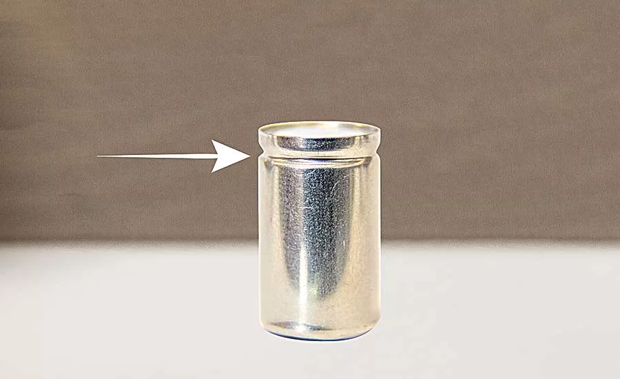

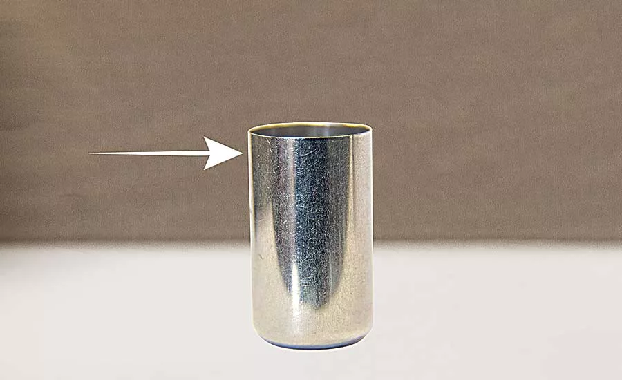

Roller forming can be used to form a lip on the edge of a hollow, cylindrical part to secure a part, such as a bearing, inside another part. These photos show an assembly before (above) and after (next) forming. Photo courtesy Orbitform
Roller Forming for Cylindrical Assemblies
Roller forming can be used to form a lip on the edge of a hollow, cylindrical part to secure a part, such as a bearing, inside another part. These photos show an assembly before (previous) and after (above) forming. Photo courtesy Orbitform

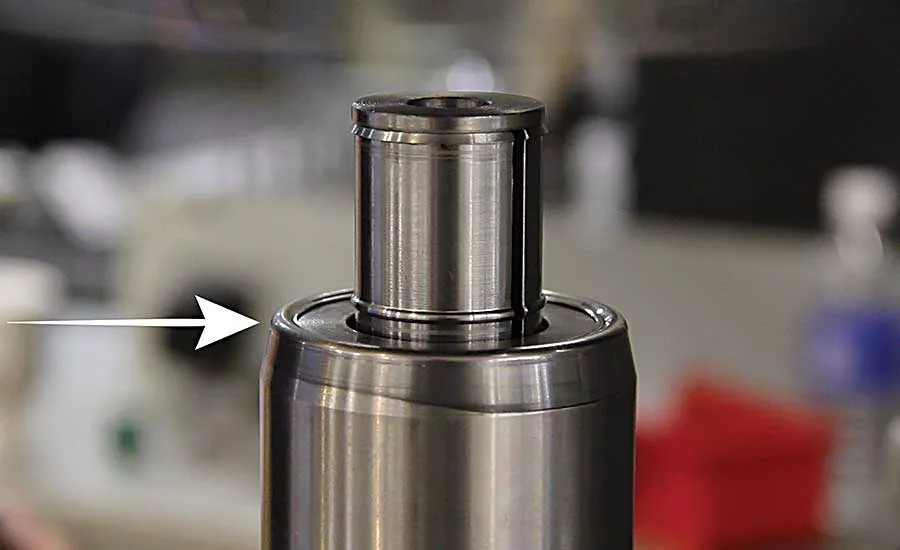

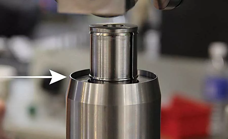

Roller forming can be used to form a groove in a cylindrical part. These photos show an assembly before (above) and after (next) forming. Photo courtesy Orbitform
Roller forming can be used to form a groove in a cylindrical part. These photos show an assembly before (previous) and after (above) forming. Photo courtesy Orbitform

Like orbital and radial forming, roller forming is a nonimpact process for cold-forming metal. However, instead of forming a head on a post or a rivet, the process forms a curl or lip on the edge or rim of a hollow, cylindrical part. This can be done to secure a part, such as a bearing or a cover plate, inside another part, or it can simply be used to finish the ends of a metal tube to make it safer, improve cosmetics or facilitate insertion of the tube into another part.

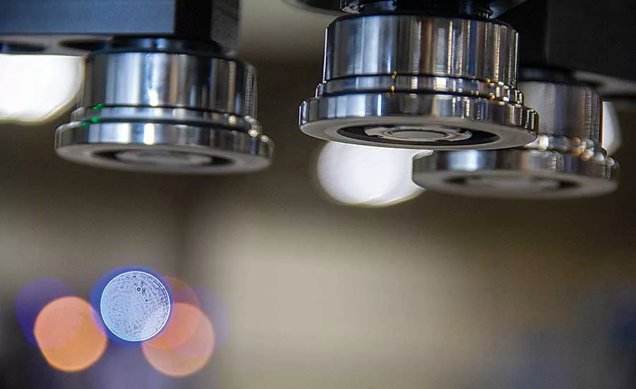

In orbital and radial forming, the head is formed by a peen attached to a rotating spindle that simultaneously exerts downward force on the workpiece. In roller forming, the peen is replaced with multiple rollers. With the head rotating at 300 to 600 rpm, each pass of the rollers gently pushes and smooths the material into a seamless, solid form. In contrast, an orbital forming operation typically runs at 1,200 rpm.

There are two types of roller heads: static and articulating heads. A static head is the most common. It has vertically oriented rollers in set locations. Forming force is applied vertically to the workpiece.
In contrast, an articulating head has horizontally oriented rollers mounted to fingers that move in unison like the jaws of a drill press chuck. The fingers move the rollers radially into the piece being formed while applying a clamp load to the assembly. This type of head is useful if parts of the assembly protrude above the center bore.

The articulating roller forming process is often used to prepare tube for insertion of a bearing. “You can use the process to create a groove on the outside of the part and a corresponding shoulder on the inside of the part, which serves as a hard stop for the bearing,” Wright explains. “Then, once the bearing has been inserted, you can form the end of the tube over to secure the bearing. In the past, a manufacturer would have had to machine a shoulder into the tube as a hard stop.”

Made from hardened tool steel, the rollers are typically 1 to 1.5 inches in diameter, says Lauritzen. The number of rollers on the head depends on the thickness and material of the part and how much force will be applied. Three rollers are most commonly used. Only two rollers might be necessary for a small part, while a very large part may require six.

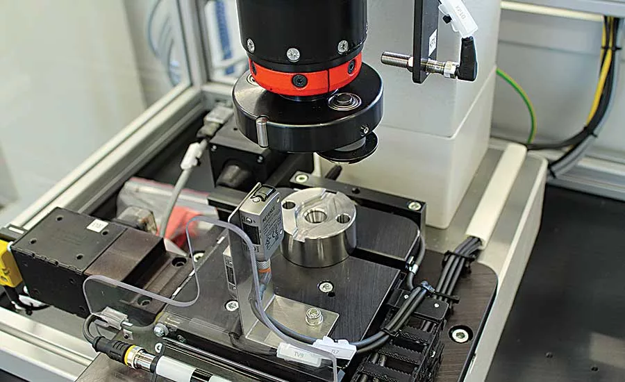

In some cases, a pressure pad can be built into the system to apply a preload to the assembly prior to forming. In some cases, a linear variable differential transformer can be built into the pressure pad to measure the stack height of the assembly before assembly as a quality check.
The key variables of the process are axial force, radial force (in the case of articulated roller forming), torque, rotational speed, time and displacement. These settings will vary depending on part size, material, and joint strength requirements. As with pressing, orbital forming and radial forming operations, roller forming systems can be equipped to measure force and displacement over time.
