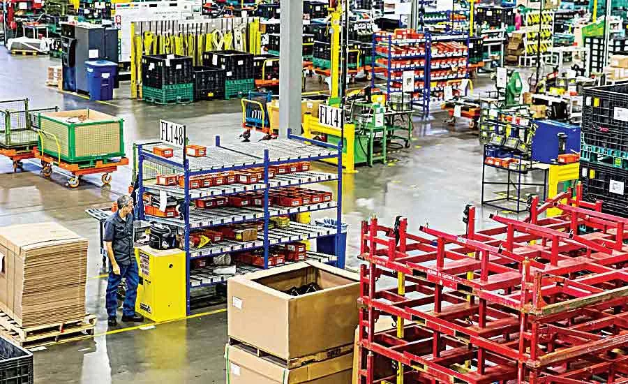

The labeled and coded system provides high visibility for accurate picks from the Span-Track lanes. Photo courtesy UNEX Manufacturing Inc.

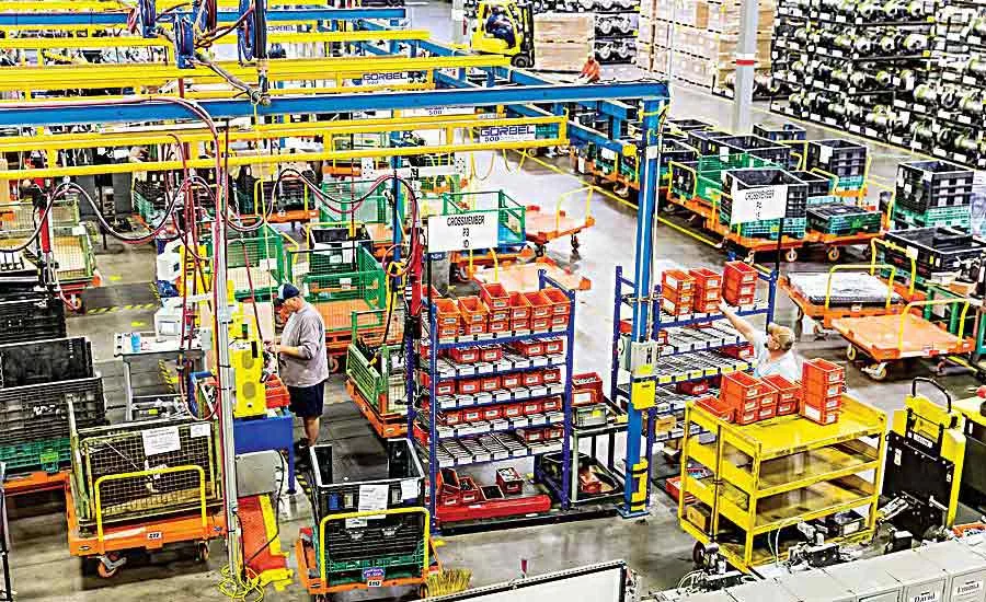

The supermarket setup and high-performing sub-assembly line keep truck parts rolling full speed ahead at Daimler’s Components and Logistics facility. Photo courtesy UNEX Manufacturing Inc.

Initially, bulky cardboard boxes on pallets filled the small-parts pick area. Boxes were cut and ripped open to get to materials, which lead to screws and empty boxes scattered on the floor. This setup slowed down pickers responsible for delivering fasteners to the line. The site needed to quadruple the number of parts coming in—an impossible goal to achieve with the old racking system.
Tom Currier, a distributor from Harris Handling, called in UNEX to provide a solution that would address the space issue and establish an orderly, efficient and safe pick
environment. The UNEX team designed a grocery store-type setup using Flow Cell with 6-inch-wide Span-Track Lanes.
The pick area for fasteners now includes 2,600 Span-Track Lanes, which takes up less space and allows more product in the same footprint. The UNEX system provides high visibility and accessibility. Everything is labeled and coded for quick and accurate pick points.
Maximizing space and efficiency are top priorities for the line-side area as well. In the lineside area, Daimler workers assemble doors, windshield brackets, tire frames and other components to ship to bus and truck manufacturers.
Flow Cell from UNEX turned out to be the best fit. Pickers from the fastener area deliver totes of fasteners to the Flow Cell units, where lineside workers pick the exact screws and bolts needed for assembly.
“Productivity at lineside definitely jumps when workers don’t have to come off their station and waste a half hour to an hour walking 300 feet to sort through the parts they need,” says Currier.
UNEX provided 40 Flow Cell workstations, which allows workers to complete tasks. The easy-to-build steel units are adjustable to accommodate Daimler’s lineside needs.
