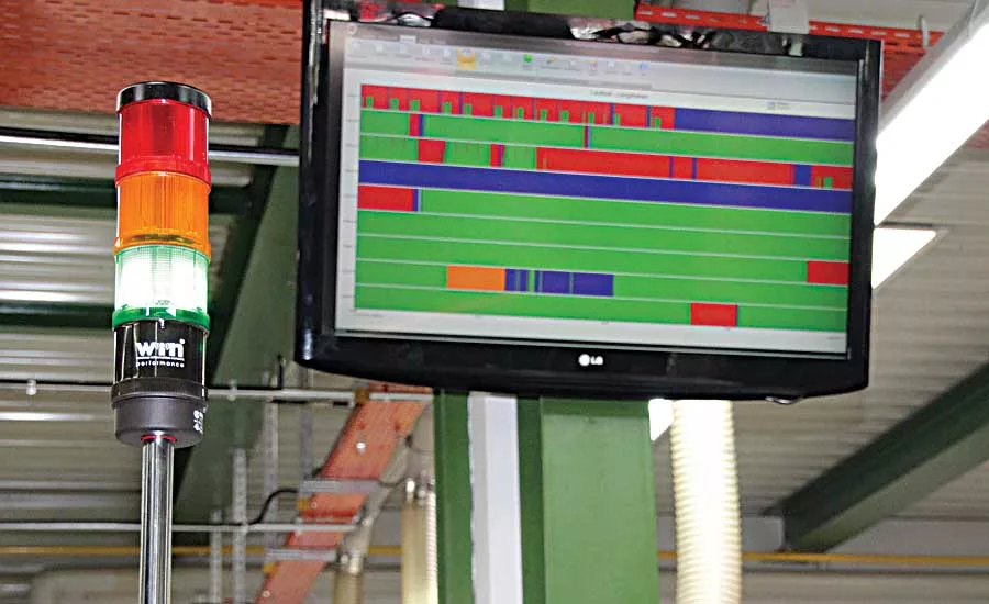

Screens display the status of all of Ketterer’s machines to decrease downtime and increase overall productivity. Photo courtesy WERMA Signaltechnik

WERMA signal towers transmit data to the SmartMONITOR system, which displays the status of machines throughout the factory. Photo courtesy WERMA Signaltechnik

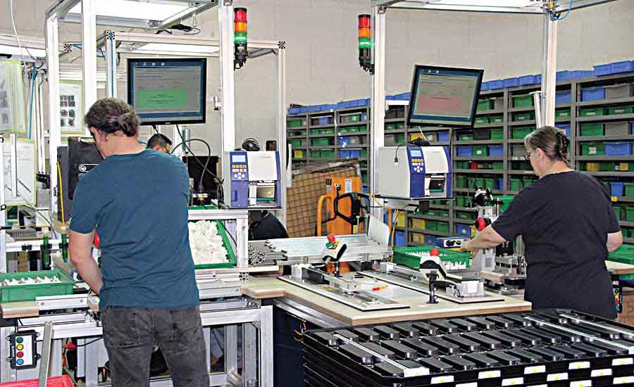

To make the task easier, Ketterer relies on signal towers and andon lights from WERMA Signaltechnik. These devices immediately show status changes of a machine and indicate disruptions to production. Managers can view the status of a line from some distance.
Ketterer uses the classic traffic light configuration of red, amber and green, since these are most readily understood. Red indicates an error or disruption to production that must be resolved immediately. Amber means that a machine is being reset. Green means that the machine is running normally.

After researching various systems, WERMA’s wireless machine monitoring system, SmartMonitor, proved to be the best option. Plug-and-play wireless kits were added to existing signal towers to monitor the status and output of machines, equipment and manual workstations. This data is transmitted wirelessly to a receiver connected to an SQL database. WERMA’s software then compiles the data to produce simple visuals and comprehensive reports at the touch of a button.

The company takes full advantage of the displays generated by the software. In the production manager’s office, the control station view is used. Near the machines themselves, the current run-time of orders is displayed. Markon’s view includes the entire shop floor layout, so it is easy to identify which machine is being displayed and where it is located.
Four large screens have been installed throughout the factory so everyone can see the status of all the machines. The machine operators also use the screens to monitor their own activity and help colleagues react if there is a problem on one of their machines that they might not have immediately seen.
