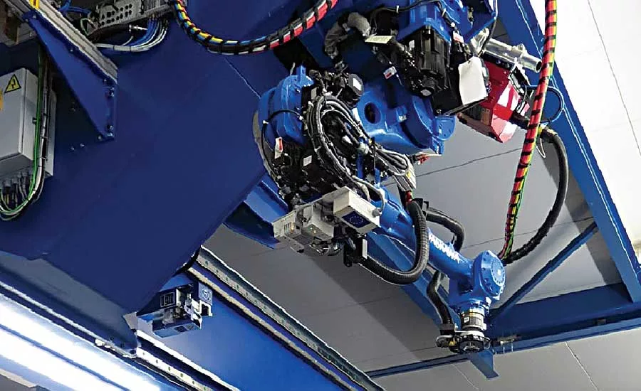

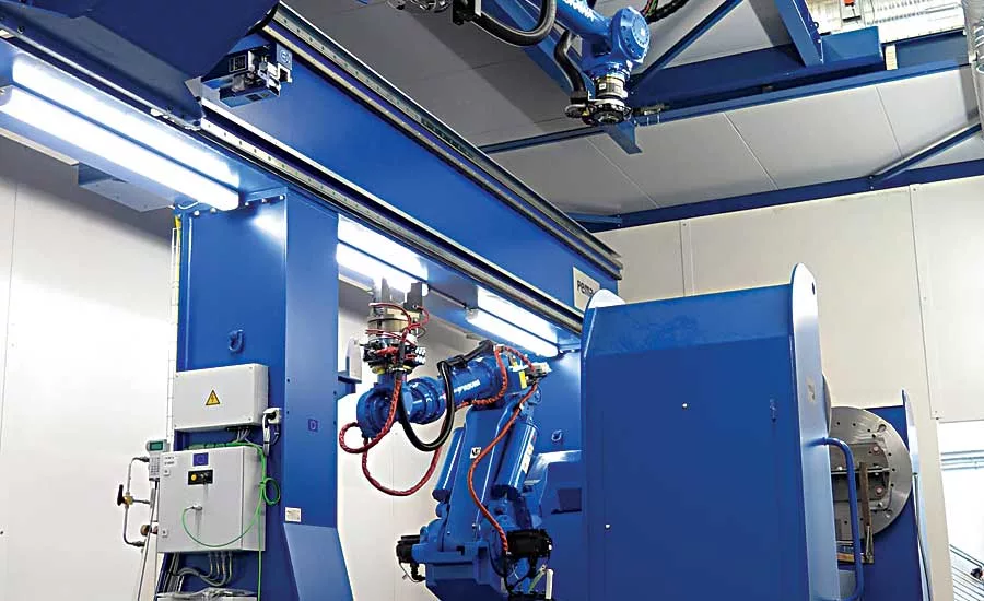

The PEMA laser-hybrid welding station used by researchers at the Savonia University of Applied Sciences features handling and welding robots, head and tailstock positioners, and an offline-programming control system. Photo courtesy Pemamek Oy Ltd.

Components of the PEMA station include Yaskawa Motoman handling and welding robots, head and tailstock HS 1500R-1 positioners, a laser welding head, the CellControl 700 PC controller, the ScanTracker laser-scanning tool from Precitec Inc., the WeldControl 300 offline-programming control system, a protective cover and fume extraction.
The positioners secure long, large parts for welding and move in tandem along a floor-mounted rail. ScanTracker uses a high-frequency pendulum motion to ensure that weld spot size and seam width accurately match the joint. The WeldControl 300 enables end-users to integrate all power systems to a single system and program all basic functions at start-up to limit the risk of human error.
