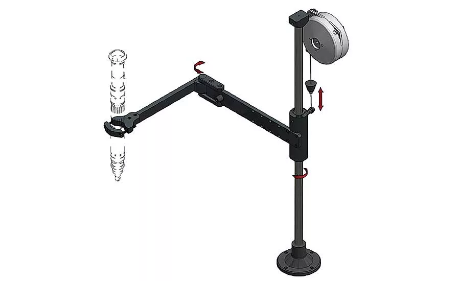

FlexArm also offers a carbon fiber arm, as well as an articulated model called the AR40. Last year, an off-highway equipment manufacturer installed 24 AR40 arms on two assembly lines to help workers perform nutrunning more ergonomically. Jeff Dauterman, ergonomic sales manager at FlexArm, says that its arms have proven much more productive than the pneumatic counterbalance arms that the manufacturer had been using. Those arms also had to be initially modified and regularly maintained.

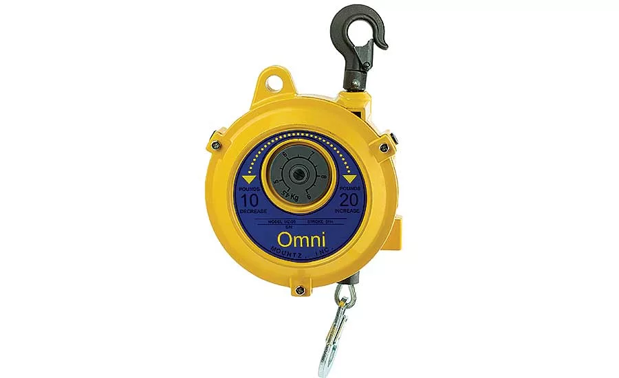

Tool balancers help to reduce fatigue and increase safety by making it easier for workers to lift and move the tool in their work space. Balancers come in several types, with spring and zero gravity being the most popular.
Spring balancers are recommended for lightweight assembly tools like pneumatic and electric screwdrivers. Zero-gravity balancers are better for large impact and pulse tools.
Spring balancers, also called retractors, feature a spring-loaded wire reel that exerts an upward force on a tool to lift it up and out of the way when not in use. The reel is clipped to the tool, which is then powered by a separate pneumatic umbilical and lifted either partially out of the way or all the way up to the reel.

The TW series of spring balancers from AIMCO consists of 12 models. The smallest unit, TW-00, handles tools from 1.1 to 3.3 pounds, while the largest unit has a capacity of 132 to 154 pounds.

A linear arm is a single-piece unit that smoothly revolves around, and travels up and down on, a fixed shaft. Telescoping arms move in and out a set distance, and are effective for applications requiring a tool to be used in a tight vertical space. Many linear and telescoping arms feature an end clamp that rotates a straight or pistol-grip tool 90 degrees.
Last year, FlexArm introduced its LR40 linear arm for use in tight-space applications, such as tightening two bolts that are close to each other. Dauterman says the arm is rated to 40 ft-lbs and slides in and out from 8 to 31.25 inches. It has a counterbalance up to 10 pounds and can be mounted in any of four orientations, including from the ceiling.

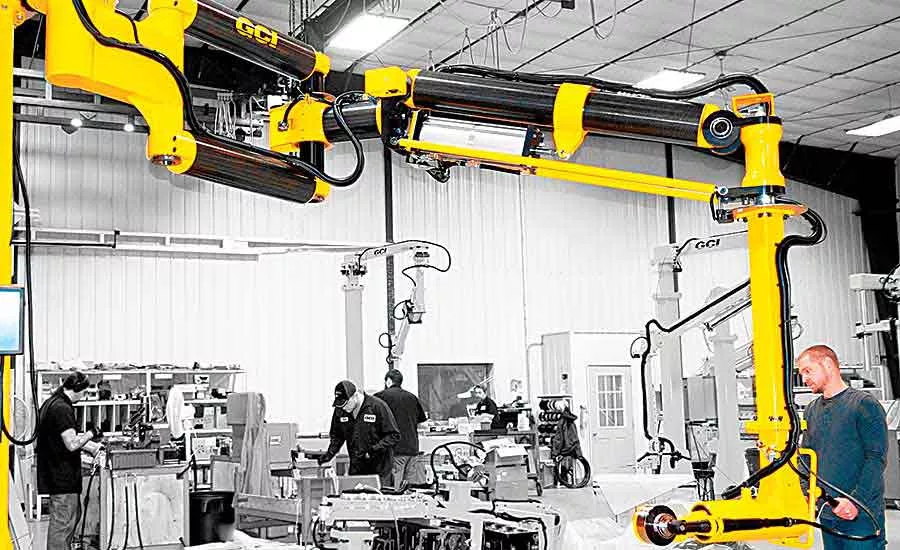

GCI has been making custom carbon fiber (CF) torque and manipulator arms since 2009. Company president Jeff Golberg claims that GCI is the only supplier in the industry to offer long-reach CF arms. Currently, GCI makes CF arms up to 20 feet long with torque ratings of 30 to 7,500 newton-meters.
“Because our customers often need to perform large vehicle assembly, they regularly deal with floor-space-restriction challenges,” explains Golberg. “With our long arms, however, the assemblers are able to mount the arm in one spot and still fully access both sides of a vehicle.”
GCI makes its arms out of CF for several reasons, according to Golberg. The material is much lighter than steel, as well as being more rigid and better able to maintain its ergonomic benefit to users at extended lengths.
“A steel arm is basically twice the weight of a comparable carbon fiber one,” says Todd Gieseke, director of engineering at GCI. “This means that a 20-foot-long-reach fiber arm weighs about as much as a 10-foot-long-reach steel one. And that extra 10 feet is a big benefit to operators.”
“Carbon fiber’s weight and strength benefits are important to manufacturers, but don’t really kick in until the application requires large, heavy and high-torque tools,” adds Golberg.
Industries served by GCI include heavy equipment, automotive, marine, aerospace, recreational vehicles and material handling. Golberg points out that customers tend to be high-volume manufacturers that operate assembly lines of 20 to 40 workstations, with each station featuring one or two arms.

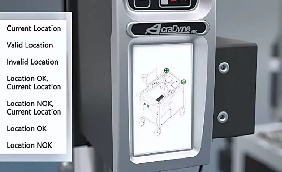

AIMCO’s AcraDyne Gen IV Ace controller provides smart-arm operators with process visualization in a single system. Real-time data is captured by encoders located at each arm joint and then represented in an image on the
controller screen. Once fastener locations and sequences are programmed into the controller, the system performs specific actions on specific fasteners.
Maio notes that the controller requires no external PC and uses its own integrated software. It works with all of the company’s continuous- and discontinuous-drive transducerized tools, which have a torque capacity from 1 to 12,000 newton-meters.
