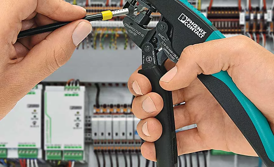

The pliers-style Duo hand tool crimps single and twin ferrules, and features a rotating die for front or side entry. Photo courtesy Phoenix Contact

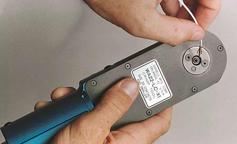

The WA22LC-X1 pneumatic indent crimper is capable of crimping size 20 and smaller contacts onto 32 to 20 AWG wire. Photo courtesy Daniels Manufacturing Corp.

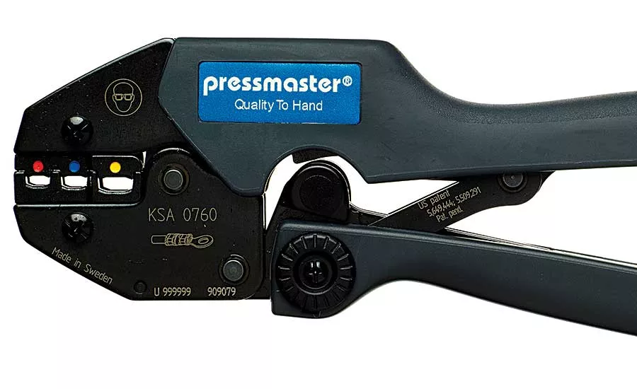

K-Frame manual crimpers feature a scissor-action ratchet and produce a maximum crimp force of 2,250 pounds. Photo courtesy Pressmaster Inc.

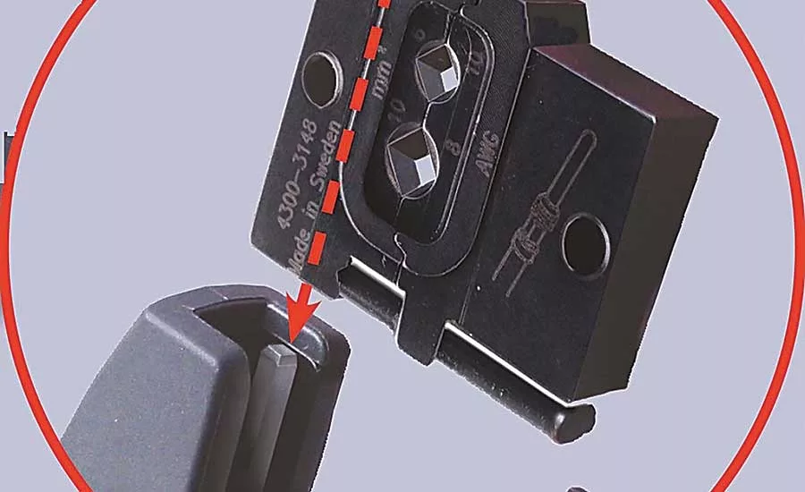

Many handheld manual tools come with numerous dies that easily change out and accommodate different wire sizes, connectors, crimp configurations and shapes. Graphic courtesy AutomationDirect

In 2015, a large Texas-based electronics contract manufacturer turned to Phoenix Contact for a better way to crimp ferrules onto 16 AWG wire. The hand tools the manufacturer had been using required each assembler to crimp the ferrule once, turn the wire 90 degrees and then crimp the ferrule a second time.
Haynes says she recommended the company try Phoenix’s Crimpfox 6SF hand tool instead. The ratchet-type tool has an integrated lock that remains in place until the necessary crimping pressure is reached, thereby eliminating the possibility of applying too little pressure.
Assemblers at the manufacturer now crimp the ferrule with one tool squeeze and are much more productive. In addition, the crimp causes no connector or terminal damage, and it meets all connector-supplier specifications.

Both types of tools may be dieless or come with dies and positioners to accommodate different wire sizes, connectors, crimp configurations and shapes. Pliers-style tools are typically used in applications requiring 25 or so connections per shift, whereas ratchet-style tools are preferred for applications requiring 100 or so connections per shift.

For many years, harness assemblers have used long- and short-handle K-Frame manual crimpers from Pressmaster. The long version measures 10.08 inches, weighs 1.15 pounds (frame only) and produces a maximum handle force of 54 pounds. The short version measures 8.03 inches, weighs 1.01 pounds (frame only) and produces a handle force of 70 pounds. Both models produce a maximum crimp force of 2,250 pounds.
Standard features include a scissor-action ratchet, and through-hardened alloy steel construction. The versatile tools have a wear life of 50,000 cycles plus, can be quickly calibrated and are easy to customize for right- or left-handed users. A nonslip pad holds them in place when leveraged on a work surface.

DMC’s handheld WA22LC-X1 pneumatic indent crimper is lightweight, ergonomically designed and capable of crimping size 20 and smaller contacts onto 32 to 20 AWG wire. Kelly says the tool is widely used in both military and proprietary applications.
Accurate calibration is maintained by an eight-step machined steel block that holds gauging tolerances longer than the standard adjustment screw. This results in high output with less downtime. The tool’s trigger allows for easy use by right- or left-handed operators.
