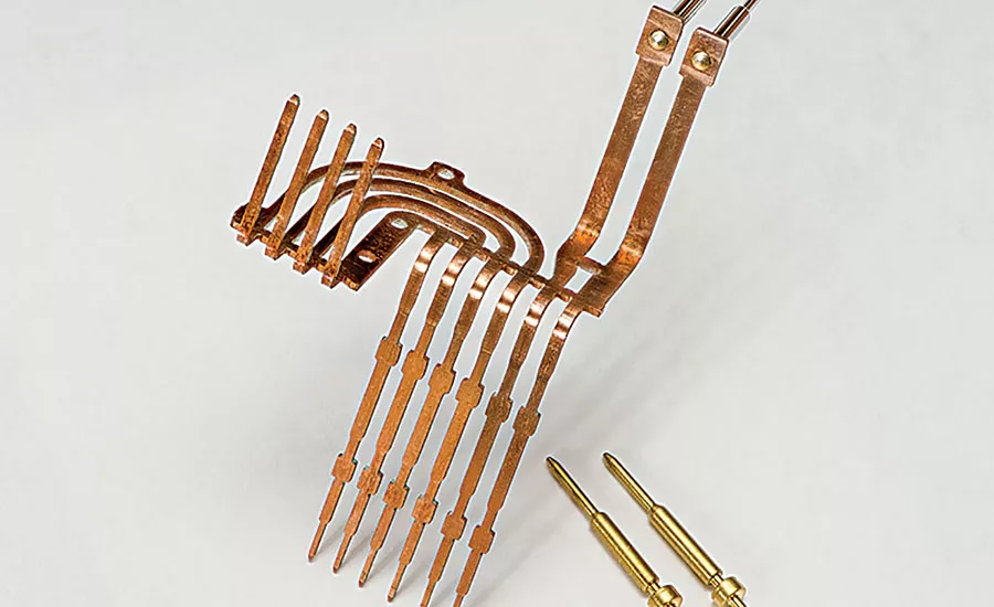

Engineers at a major manufacturer of portable electronic devices had a problem. They needed to rivet a small, thin electrical contact to the device’s charger subassembly, but how could they head the tiny rivets—0.02 to 0.03 inch in diameter—without crushing the assembly?
“We’re talking pinhead-sized rivets,” recalls Chuck
Rupprecht, vice president and general manager of Baltec Corp. “The application required very low force—below 1.5 kilonewtons.”

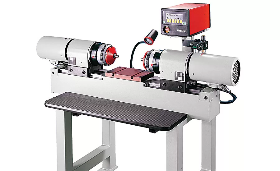

To assemble the parts, Baltec supplied a radial riveter outfitted with a custom-made forming tool and an HPP-25 process controller. Equipped with a 5.7-inch color touch screen, the user-friendly controller lets engineers govern six process parameters: forming distance, riveting time, riveting force, spindle distance, external contact and rivet head height. The controller gives engineers a choice of 39 riveting modes.
A unique function of the controller is “exact rivet recognition.” This function recognizes the start of the rivet without the need for pressure or speed reduction during the riveting process—prior sensing is not necessary. Other features include an integrated data logger for recording process data; the ability to visualize riveting data as curves; and the ability to export and import data via USB and Ethernet interfaces.
“We now have the ability to use our HPP technology with very low-pressure applications and still get the same accuracy as you would with a ‘normal’ 6-millimeter rivet,” says Rupprecht.
That ability has enabled Baltec’s riveting technology to be applied to some very delicate assemblies, indeed. For example, a medical device manufacturer is using a Baltec machine to head semitubular rivets just 0.03 inch in diameter. The rivets secure a fine wire mesh in a device for repairing heart valves. If that’s not challenge enough, each riveted joint has to pivot.
Another benefit of the HPP-25 controller is the ability to change forming parameters on the fly to head different sized rivets. “Let’s say an application calls for heading one rivet 7 millimeters in diameter and another 4 millimeters in diameter,” says Rupprecht. “I can’t use the same force that I used for the 7-millimeter rivet to form the 4-millimeter rivet—I’ll squash the heck out of it.
“With our process controller, you set up different programs for each point. Using a proportional pneumatic control, the controller automatically reduces air pressure so the machine can head those smaller rivets.”

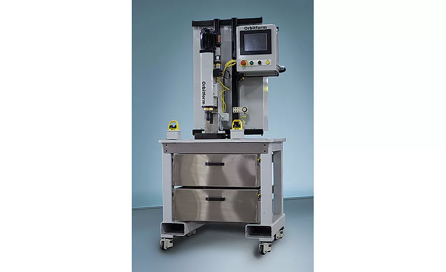

For example, a medical device manufacturer is using a servo-driven orbital riveter from Orbitform LLC to rivet small scissors and clamps for endoscopic surgical instruments. The joints for these tools pivot on a small stainless steel rivet that must be headed to a very tight tolerance.
“That was a very precise application,” says Jacob Sponsler, plant manager at Orbitform. “The clamp force provided by the rivet had to be perfectly repeatable, so surgeons have the exact same feel every time they use the instrument.”
Traditionally, the downward force applied by orbital and radial forming machines has come from pneumatic or hydraulic cylinders. However, Orbitform has recently introduced a line of servo-driven power heads. Using a servomotor and ballscrew to apply downward force confers numerous advantages, such as precise control, variable advance and retract rates, and a wide range of forming forces. For example, the Model SV-310 offers forming forces from 1 to 3,000 pounds, a maximum stroke of 2.5 inches, and advance and retract speeds from 0.005 to 4 ips. It can form a stud or rivet up to 0.375 inch in diameter.
“Our smallest pneumatic riveter applies 500 to 600 pounds of force—that’s a lot of hammer when you’re talking about rivet 0.02 inch in diameter,” says Sponsler. “You can only turn down a pneumatic riveter so far. You can maybe get it down to 200 pounds. However, there are forming applications that only require 10 pounds of forming force. With our small servo riveter, you can set it for 1 pound of force.”
Because the unit is not powered by compressed air, its performance is not affected by drops in line pressure. And, since there’s no exhaust air, the device can be used in a clean room.
The servomotor also gives engineers the ability to precisely program both dwell position and dwell time to reduce spring-back after forming, which is critical for assembling high-precision articulating joints. It also makes forming to a specific force or distance easier.
“With a servo-driven power head, you can form to a specific offset, and you can form to a very controlled force,” says Sponsler. “You can accomplish those things with a pneumatic riveter, too, but it may take quite a bit longer.”
A servomotor also enables engineers to create a closed-loop process—another advantage for making assemblies with articulating joints.
“We do a lot of work with manufacturers of hand tools—things like multi-tools and pliers,” says Bryan Wright, vice president of sales at Orbitform. “These manufacturers will use our servo-driven power head to come down, form the head, and hold that position. Then, they’ll test the joint within the fixture to measure the torque. If the joint is too loose, they can advance the head in micron increments to tighten up the joint until it’s within an acceptable torque range.
“That saves time, and it ensures that you’re creating a good part every time.”

Both orbital and radial processes are readily integrated into semiautomatic or fully automatic assembly systems. For example, Baltec offers pre-engineered, turnkey semiautomatic assembly machines complete with a radial riveter, the HPP-25 controller, a rotary indexing table (four, six, or eight stations), custom fixtures, and pneumatic ejection of finished parts.
“We sell a lot of machines like that to small manufacturers,” says Rupprecht. “With an operator loading the parts, they can make thousands of components a day.”
