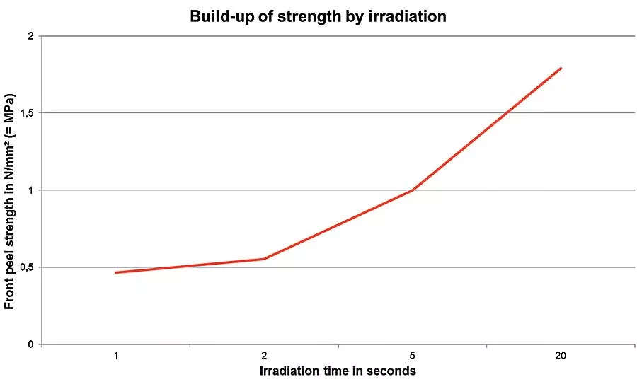

This graph shows the front peel strength of DELO-Duopox DB8989 on sand-blasted aluminum after exposure to UV light at 1,000 mW/cm². Photo courtesy DELO Industrial Adhesives

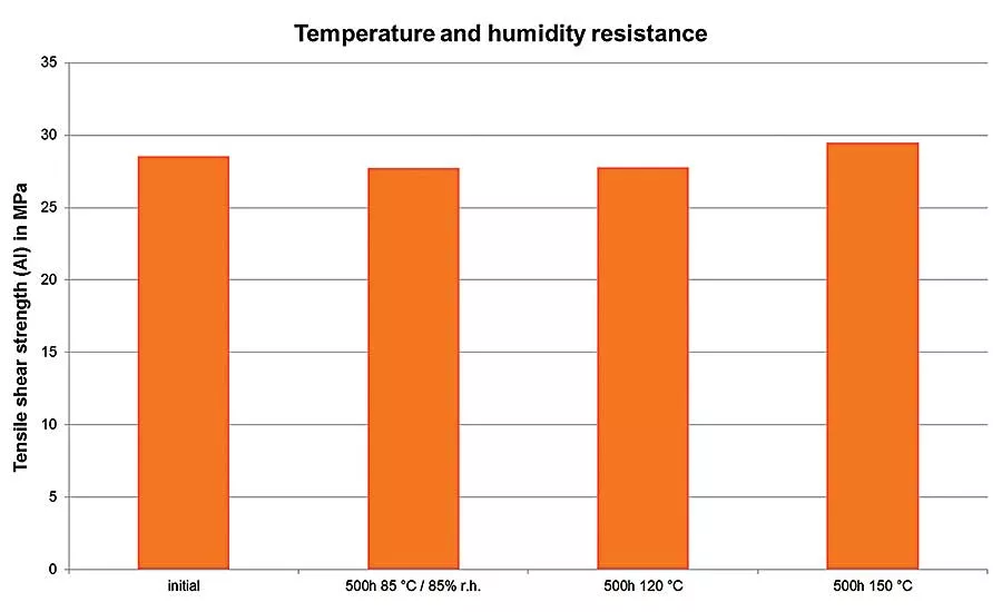

Light-fixable two-component epoxies maintain good strength levels after aging tests. Photo courtesy DELO Industrial Adhesives

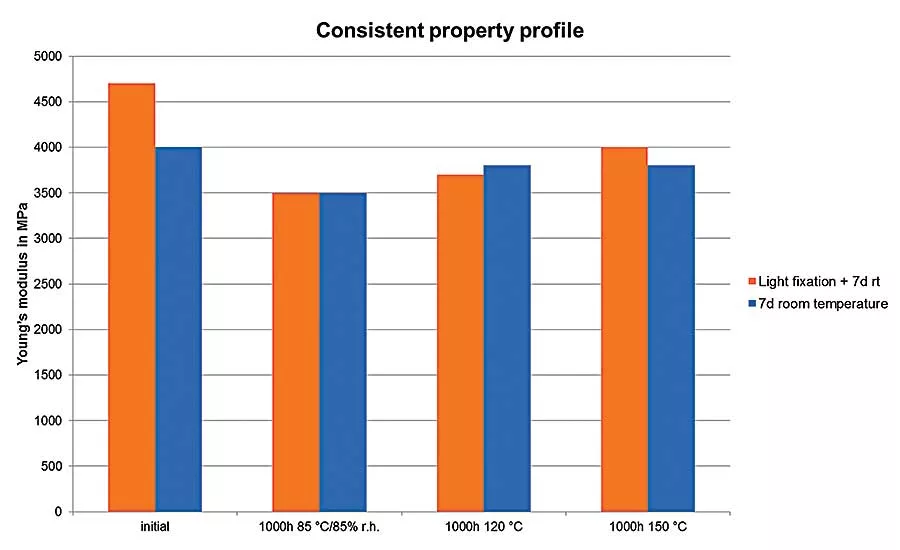

The Young’s modulus of DELO-Duopox DB8989 is comparable in the areas exposed to light and shaded from light, even after challenging aging simulations. Photo courtesy DELO Industrial Adhesives

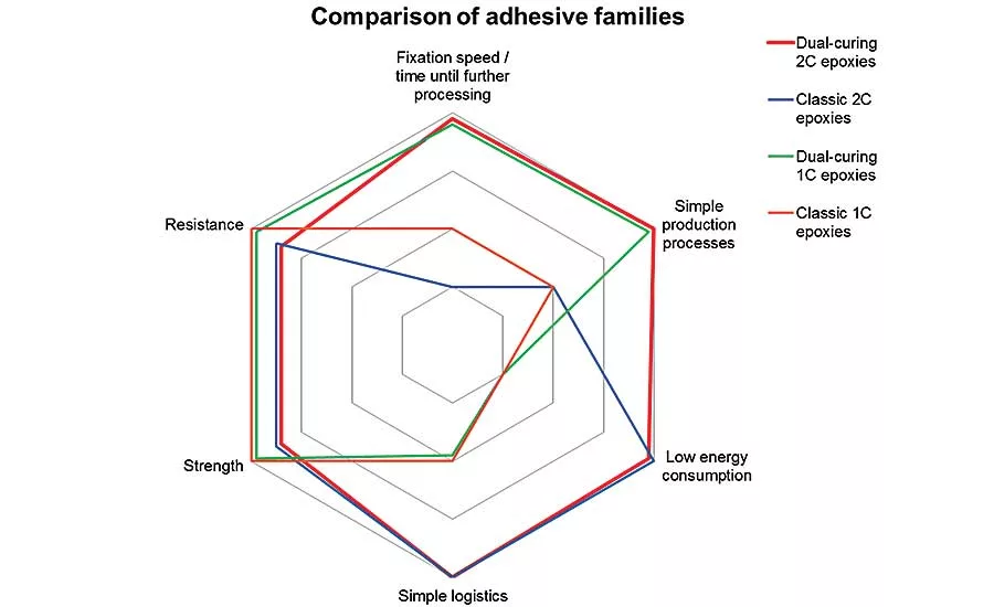

Dual-curing two-component epoxies have many advantages compared with conventional one- and two-component chemistries. Photo courtesy DELO Industrial Adhesives

This new hybrid chemistry is faster than any previous two-component epoxy. After just a few seconds of irradiation, the components are sufficiently secured in their joined positions and protected against slipping so that processing of the entire assembly can go ahead immediately. The strength after an irradiation time of only 5 seconds at an intensity of 1,000 milliwatts per square centimeter (mW/cm²) already amounts to 1 newton per square millimeter, a value that is often defined in the industry as initial strength.

A light-curing process at room temperature would be more attractive to assemblers because it saves them from investing in an oven, reduces energy costs, saves space on the production floor, reduces cycle times and increases throughput. Since dispensing, joining and light fixation take place in less than one minute, the next production step can begin much faster. Previously, assemblers would typically have to wait 15 to 90 minutes for the adhesive to reach green strength. The light-curing process also has a much lower carbon footprint than heat curing.
The only equipment needed to process light-curing two-component epoxies are a meter-mix dispensing system and a UV lamp. But, those costs are insignificant compared to the cost of a curing oven.
Two-component UV-cure epoxies are also easier to store and transport. Unlike one-component heat-curing epoxies, two-component UV-cure epoxies can be transported at room temperature and can commonly be stored for 12 months. Once the containers have been opened, they have a shelf-life of several weeks. As a result, assemblers can purchase the adhesive in larger and more economical containers.

The adhesives maintain their strength even when exposed to high heat and high humidity. For example, in aging simulations specified in the automotive sector, the adhesives maintained their strength despite being exposed to a temperature of 85 C and a relative humidity of 85 percent for 500 hours. They even maintained their strength despite being exposed to a temperature of 150 C for 500 hours. This high level of temperature resistance equates to a service temperature range of up to 180 C.
Another advantage of these new adhesives is that full curing takes place even in shadowed areas that are not irradiated. Testing has shown that the Young’s modulus of DELO-Duopox DB8989 is comparable in the areas exposed to light and areas shaded from light, even after challenging aging simulations. In other words, the mechanical properties of the cured adhesive are identical in both shaded and unshaded areas. As a result, engineers can be confident that the adhesive will remain viable even if subsequent design changes lead to different part geometries.
