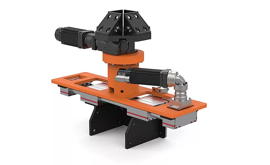

This unique custom design incorporates a Camco GTB servo positioner that rotates Destaco’s end-of-arm tool while attached to a gantry system. The system speeds up production in a foodhandling operation. Photo courtesy Destaco

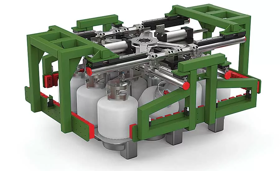

Securing and moving empty propane cylinders while maintaining each cylinder’s position on a pallet required a unique application design using Destaco’s BodyBuilder tooling and Robohand products. Air bladders are dispersed in between each cylinder to provide secured containment during transportation. Photo courtesy Destaco

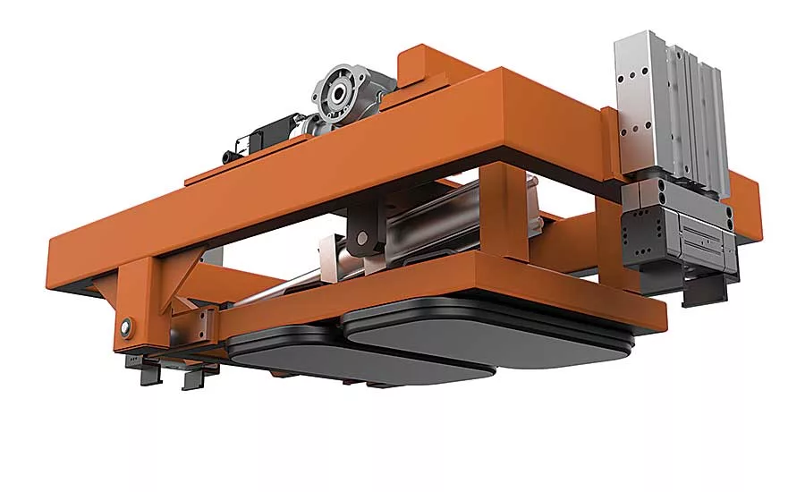

Destaco’s Camco GTB servo positioner attached to a robot is included in this custom system designed to safely move heavy, yet delicate stone pavers onto a pallet, and then securing them for packaging. Each paver is 24 inches square. This unit includes a vacuum pad to tilt product from horizontal to vertical. Photo courtesy Destaco

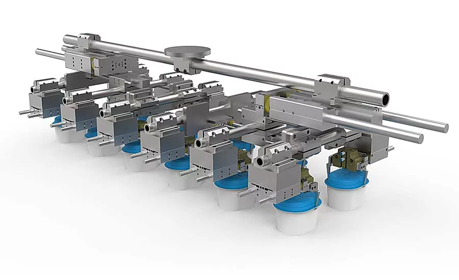

A custom pick-and-place application utilizing Destaco’s lightweight tooling and Robohand grippers was designed to move multiple yogurt containers efficiently into the next step of the packaging process. Photo courtesy Destaco
