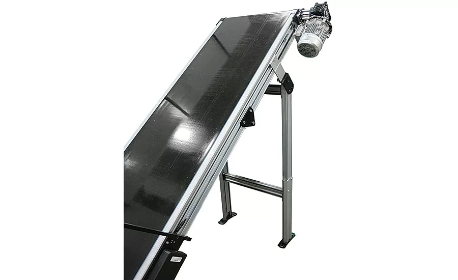

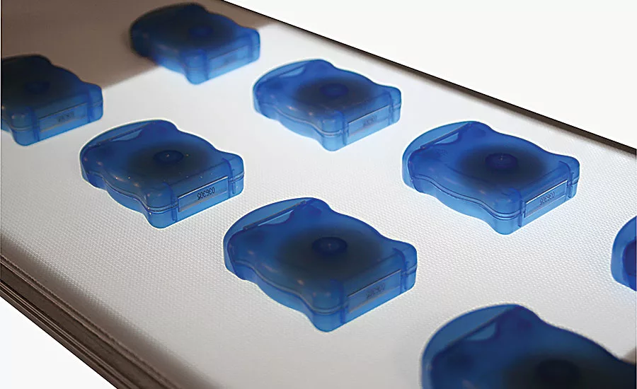

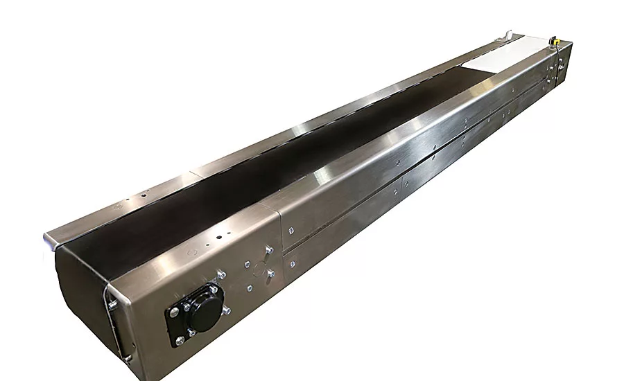

Conveyors can also save space by doing double duty. This low-profile belt conveyor is back-lit to facilitate machine-vision inspection. Photo courtesy Dorner Manufacturing Corp.

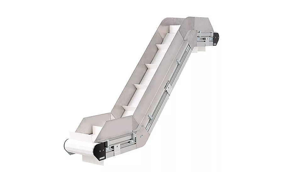

Z-Frame Conveyors
Perhaps the most well-known technology for elevating product is the Z-frame conveyor. As implied by its name, Z-frame conveyors are designed with either one or two pivot points, resembling the angled points in the letter Z, to move product up or down along the conveyor.
Z-frame conveyors are ideal for navigating obstacles within the flow of production. Often, the lack of space prohibits conveyors from going around an obstruction. Z-frame conveyors can be pivoted at steep angles to move product up and over (or conversely down and under) an obstacle.
Various types of friction insert chains or belt cleats keep product in place during incline or decline movement.

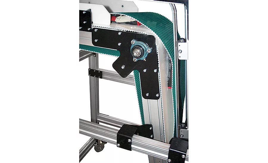

Belt-Over-Belt Conveyors
There are some applications, such as moving delicate flexible pouches, where cleated conveyors don’t work very well for inclined movement. That’s because if a pouch lands incorrectly on a cleat, the bag could rip, spilling product and leading to costly downtime to clean the conveyor.
The best solution for these types of applications is a belt-over-belt conveyor. This design involves two flexible polyurethane belts that are positioned on top of each other. As flexible pouches are moved into position, they are gripped between the twin conveyor belts, which create a pocket to securely convey the product up or down.

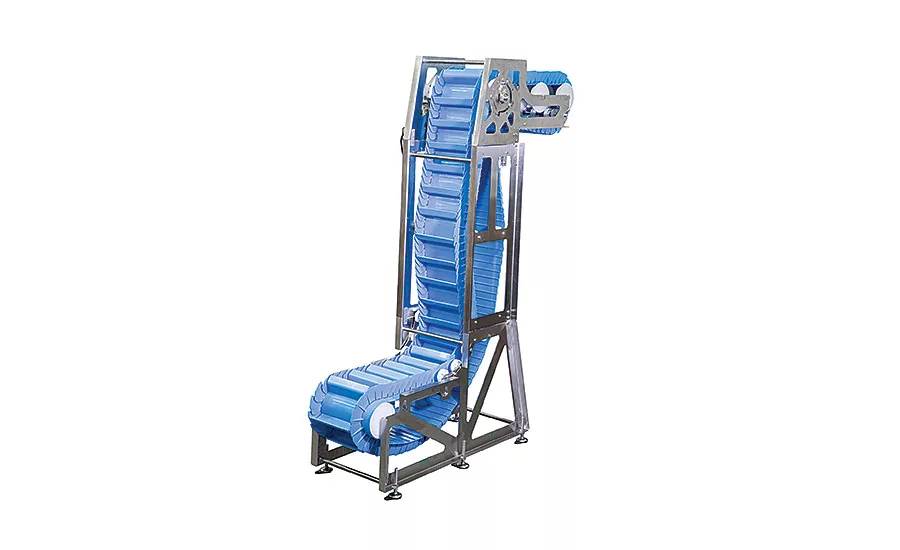

Flexible Chain Conveyors

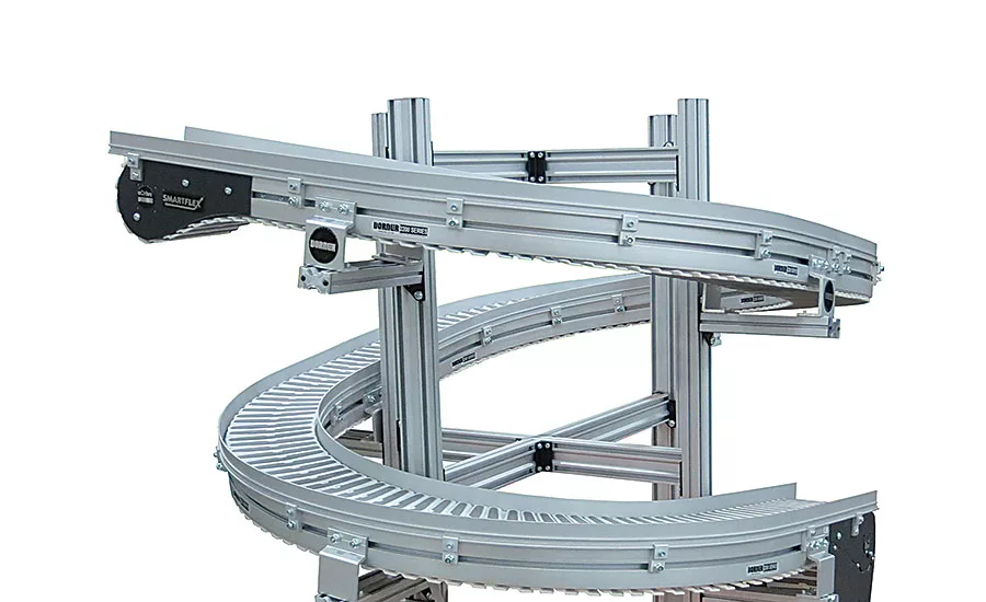

Flexible chain conveyors are perfect for navigating obstacles. They can snake around machinery and other impediments by making tight turns and steep circular inclines. These types of conveyors allow for incline or decline movement through corners and straights, and provide capability for vertical incline with minimal space. They are capable of twisting 360 degrees to move product vertically within an extremely small footprint, all while maintaining speeds and loads through the angled curve.
Flexible chain conveyors are also ideal for accumulating, buffering and cooling product between processes or machines.

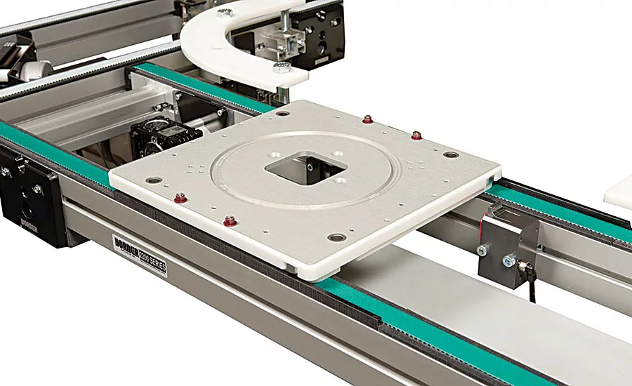

Modular Pallet-Transfer Conveyor for Automated Assembly
The 2200 Series Precision Move system is a modular, dual-belt, pallet-transfer conveyor for automated assembly.
The conveyor is available in five widths (160, 240, 320, 400 and 480 millimeters) and lengths of up to 7.5 meters.
The conveyor can handle accumulated loads up to 250 pounds or non-accumulating loads of up to 500 pounds. Maximum travel speed is 114 feet per minute.
The conveyor operates on a common drive and features a quick belt change without conveyor removal.
Each belt is 25 millimeters wide with a 5-millimeter timing pitch. Standard or static-conductive belting is available. The conveyor frame is extruded aluminum with a universal T-slot.
Pallets are available in square or rectangular sizes and can be purchased as completed assemblies or as kits. Offered in industry-compatible sizes, individual pallet load capacities range between 30 and 70 pounds, depending on size. Pallets can be built with a static-conductive skirt.
The conveyor relies on a pin-tracking system to guide pallets through corners and merges. Using the pin-tracking system, the 90-degree corner module maintains product orientation through the turn and features a 24 VDC drive mechanism to propel the pallet through the corner.
The 90-degree corner and merge module uses the same pin-tracking and drive mechanism to safely merge two lines together.
The lift-and-locate station delivers a repeatable accuracy of 0.002 inch using an adjustable-height lift from the center of the conveyor.
The lift-and-transfer station uses a dual-strand timing belt and pneumatic lift to change the product orientation and transfer it onto another line.
The lift-and-rotate station includes a pneumatic lift and rotation for adjustable positioning. The pallet can be rotated 90 or 180 degrees.
Pallet stops are available in cushioned and noncushioned models. They can be added at individual locations or in conjunction with other modules.
Conveyor systems can be configured on-line. The on-line configurator delivers a complete 3D CAD assembly model for instant validation of fit. Conveyors have a 10-year warranty and ship in four weeks.
