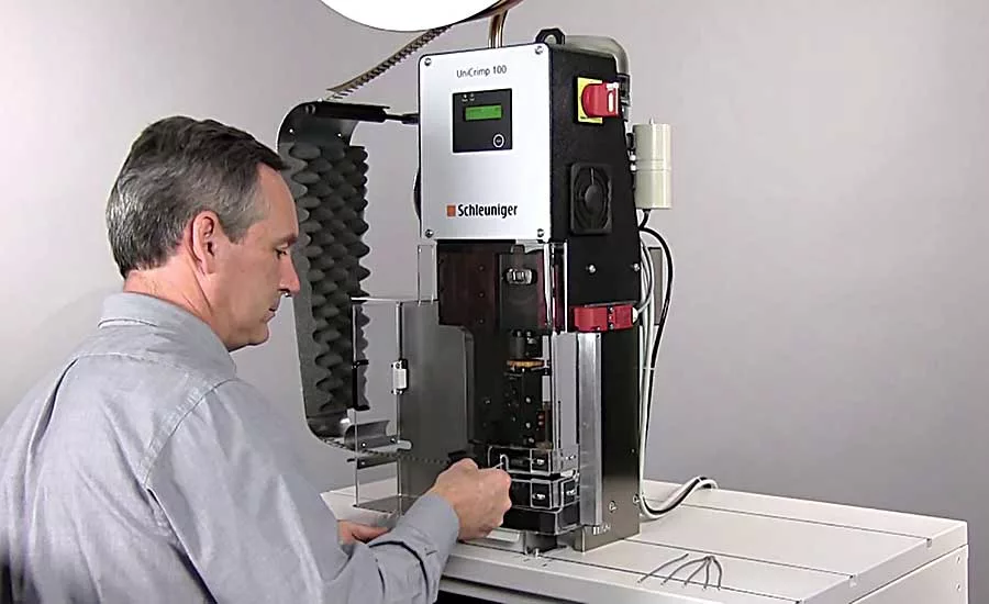

Today’s cutting, stripping and crimping equipment can collect a wealth of data about the harness assembly process. Photo courtesy Schleuniger Inc.

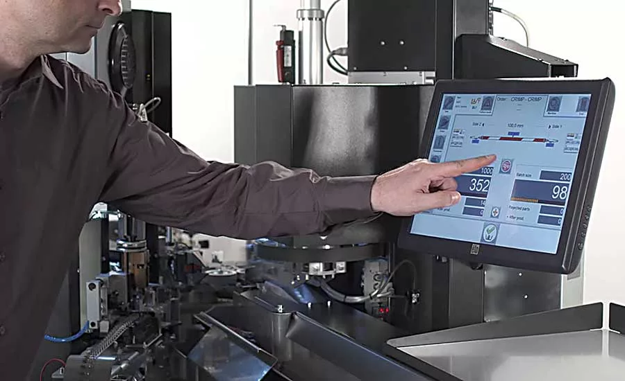

OEE requires accurate and ample data. It must be possible to capture data with either a data acquisition system embedded in the machine or an external system that analyzes production data. Photo courtesy Schleuniger Inc.
OEE and Wire Processing
To perform OEE, sensors will be required to collect production and quality data from the machinery. Ideally, these sensors should be integrated with the equipment so they do not interfere with the overall process. Photo courtesy Schleuniger Inc.

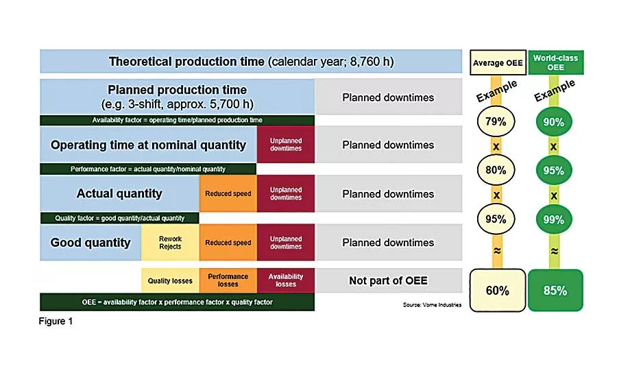

The term OEE was coined by Seiichi Nakajima, one of the pioneers of the total productive maintenance system. OEE is a measure of how well a manufacturing operation is used, compared to its full potential. In other words, OEE is the percentage of manufacturing time that is truly productive. An OEE of 100 percent means that only good parts are produced (100 percent quality), at the maximum speed (100 percent performance), and without interruption (100 percent availability).
OEE is calculated as the product of three components:
  • Availability, the percentage of scheduled time that the operation is available to operate.
  • Performance, the speed at which a machine or assembly line runs as a percentage of its designed speed.
  • Quality, the number of good units produced as a percentage of the total units started. It is commonly referred to as the first pass yield.
An average OEE is 60 percent, whereas a world-class OEE is 85 percent.
To calculate OEE, start with your theoretical production time—for instance, 8,760 hours, which is the total number of hours in a calendar year.
Next, calculate your planned production time. For instance, planned production time in a three-shift operation would be approximately 5,700 hours of production per year. The rest is planned downtime. Planned downtime is never considered as part of the OEE calculations. You only consider what is expected or what should be possible to produce.
Availability is actual operating time divided by planned production time, expressed as a percentage. However, the actual operating time should be considered when operation is running at expected performance. In any case, the difference between the planned and actual production time is unplanned downtime. An average availability factor is about 79 percent. This means that the machines are in operation 79 percent of the planned production time. A world-class availability factor is 90 percent.
Performance is the actual quantity you produced divided by the quantity expected, expressed as a percentage. There are many reasons why your equipment might not produce as much as you expected. For example, the machines might have run slower because of worn parts or suboptimal materials. An average performance factor is about 80 percent, whereas a world-class factor is 95 percent.
Quality is the total number of good parts divided by the total number of parts produced (good parts as well as rejects), expressed as a percentage. An average quality factor is about 95 percent, whereas a world-class factor is 99 percent.

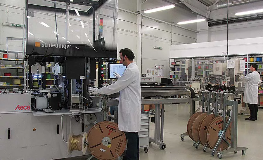

Of course, the data must be accurate and realistic. The data collection and calculations must be identical between locations so that all may arrive at respective conclusions and provide recommendations.
Many harness assemblers have manual data collection systems, and they do their best to estimate utilization. However, we have seen that these estimates are just that—estimates—and those estimates are typically wrong. Therefore, automated systems need to be implemented to really understand utilization.
The data must be available to all stakeholders, including personnel from production, engineering, quality and management. All the terms and data must be accurately defined and understood by all.

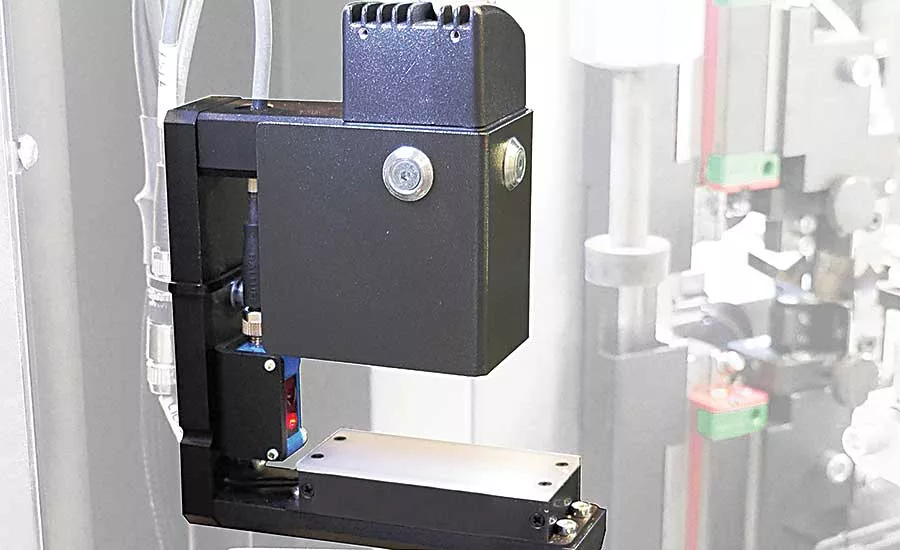

Sensors will be required to collect production and quality data from the machinery. For instance, to detect idle time vs. setup time may require multiple sensors to detect certain conditions that are indicative of each scenario. However, the sensors must be integrated with the equipment so that they do not interfere with the function or the overall process. Typically, older machines require more external sensors, whereas newer machines have these capabilities built into their software.
