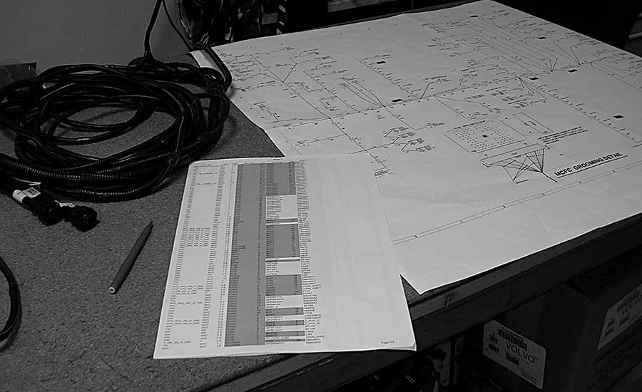

Once the scope of the work is known sufficiently, work can commence on developing the harness design. Apportionment of the functional content—that is, how features are distributed across the vehicle, the number and locations of electronic control units (ECUs), etc.—is best done using CAD software. With this information, we can identify specific connectors and set about routing the wires to individual cavities.
We will be guided by a few things during this stage of the work, one of which is the equation for the resistance of a wire: R=rL/A.
In this equation, R is the resistance of a wire; r is the resistivity of the conductor (measured in ohms per meter); L is the length of the wire; and A is the cross-sectional area of the wire.
We will use this equation to give us the amount of resistance associated with the wire. R goes up as length increases, but it goes down as cross-sectional area increases. Simulations can inform us how much loss of signal (or voltage) may be due to the wire harness length and cross-sectional area, along with the current that can be carried. This will help us determine the optimal wire gauge so that we can carry the current or deliver the voltage to the load and not lose too much signal due to the wire length. It will also help with bundling, or which wires can travel in the same space within one group.
With the bundling complete, we can use CAD tools to route the harness. These tools often have simulation capabilities that allow engineers to explore how the system works electrically and not just mechanically. For example, we can simulate load characteristics for wire harness elements to test assumptions that are invariably baked in the design.
These tools may even be sufficiently sophisticated to simulate data bus or serial communications. In these instances, we can observe the electrical impact of the wire harness on the digital signals, noting attributes like signal rise time and general shaping as way of confirming the wire harness design will not have a negative impact on the signal shape and strength.

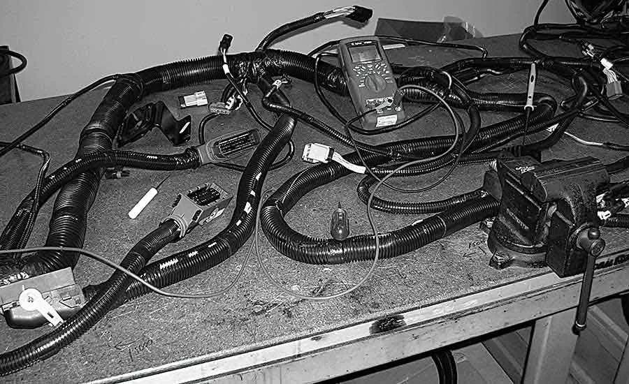

So, how can we make this better? First, the harness prototype should be a known quantity before putting it on the vehicle. Continuity and other electrical testing must be done.
However, manually performing a point-to-point test of the wire harness is not an option. For example, let’s assume the harness has 100 connection points. Manually checking the continuity of one wire end to another can be done in perhaps 10 seconds. However, to test that one end for cross-continuity in a harness bundle of 100 ends will take 1,000 seconds—nearly 17 minutes.

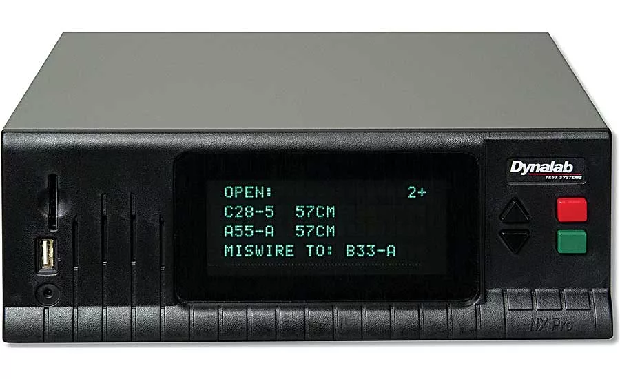

This is not the best use of time, especially when this sort of testing can be easily automated. A good harness tester can check 100 wires in 1 second! With luck, a manual test might be 95 percent accurate. A harness tester can run the test with a 99.999999 percent accuracy rate.

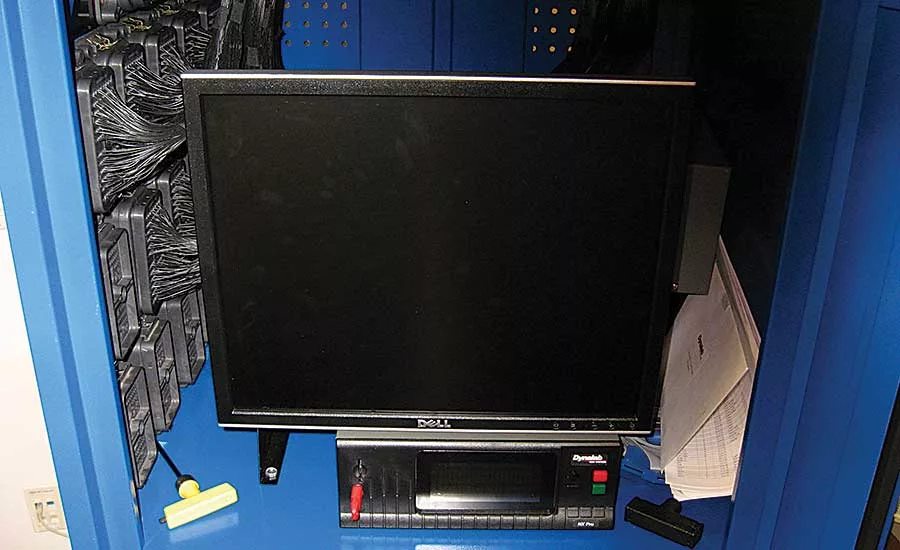

At the truck manufacturer, the harness tester we used was the NX Pro+ from Dynalab Test Systems. This instrument can import design documentation directly from the engineer’s computer into the test fixture, minimizing documentation handling errors. The fixture has 32,768 test points.
To test a harness, an adapter harness must be made to connect the test fixture to the wire harness. Next, a configuration file is loaded into the harness tester. This configuration file is the export of the wire harness design documentation. It contains a list of all the harness test pins, as well as the design of the harness itself. This fixture then compares the harness to the design documentation in seconds. The instrument checks for continuity, discontinuity and cross-continuity faster and more accurately than can be done manually. Additionally, the instrument can detect intermittent wire connections, providing the specific locations where the harness loses connectivity.
Of course, a harness tester is not infallible, either. The configuration file feeding the harness tester must be correct, so examining the process to create the configuration file can lead to additional time savings. Creating this file by hand is not the most efficient use of engineering time. In one case, it took at least five hours to create one configuration file. Ultimately, we developed a simple program that reduced the execution time to about 5 seconds. It took two days to create the program, for a payback after about four harnesses.
