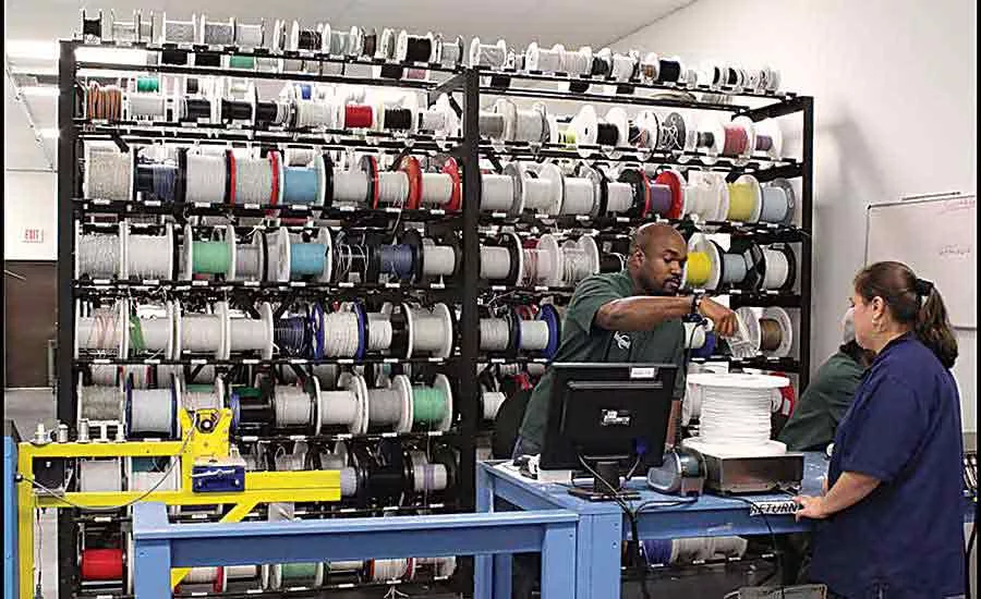

Wire Selection
When an aircraft’s electrical system is designed, the starting point is at the system level. A system schematic shows the larger components and how they are connected. In the system schematic, they are simply connected together with a line, but the size and specification of the wire are not called out. Also, the system schematic does not show where there are breaks in the wire, such as when it passes through a bulkhead via two connectors. Even though it is a very basic design, the schematic will indicate the types of signals that the wire will carry (for example, AC, DC, data, or radio). Additionally, the schematic shows where shielded wires or cables are needed, as well as twisted pairs, triplets and quads.
You’ll want to choose a wire based on the type of signal it will transmit and how much current it will carry. Generally, you should pick the smallest gauge wire that can successfully carry the required current. SAE AS50881 lists the current-carrying capacity for most common wire gauges. In addition, good CAD software will automatically calculate the current-carrying capacity of each gauge size.

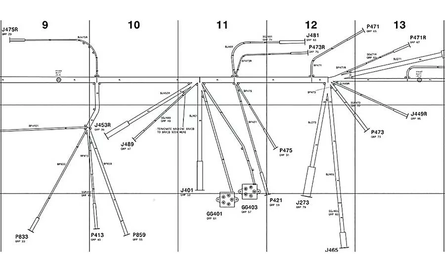

Now that you know the schematic, the type of signals to be carried, the amount of current in the circuit, and the recommended insulation, you can choose which wire part number to use.
Next, using a 3D CAD system, wire paths can be traced throughout the aircraft. In addition, wire paths typically start and stop at a connector when passing through a bulkhead. Each wire in a wire segment can then be uniquely identified and a detailed wire diagram can be developed. The wire diagram shows all wire segments, identification numbers and disconnects.

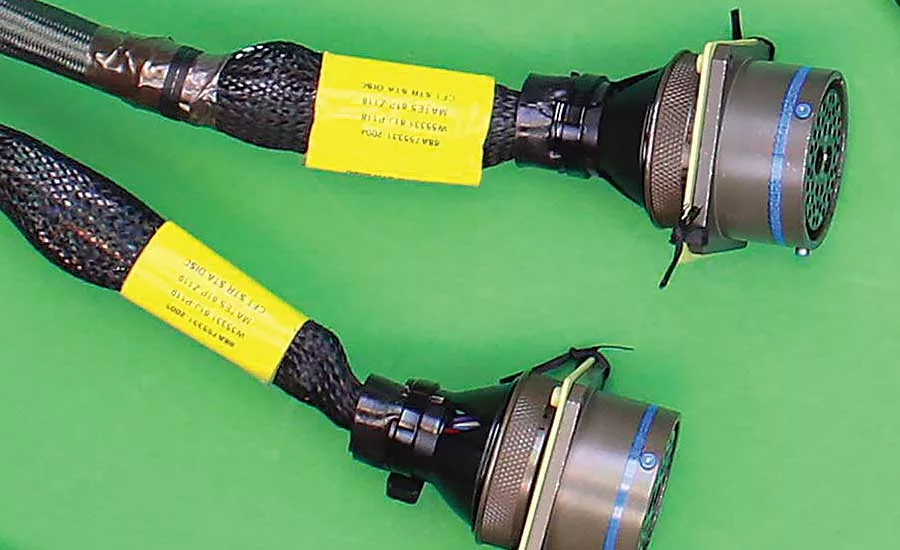

Connector Selection
InterConnect has been in business for more than 25 years. After such a long time, you might think we would have entered every military connector part number ever developed into our enterprise resource planning system. Unfortunately, this is not true. Almost every week, we enter new connector numbers into our system. To date, we have identified more than 3,200 part numbers for military connectors. With so many possible part numbers, how do you decide which part number to use when designing a wire harness?
The good news is that there are only a few common series of military connectors. Based on our experience in the military aerospace industry, the most common series of military connectors are:
  • MIL-DTL-38999 (formerly MIL-C-38999).
  • MIL-DTL-83723 (formerly MIL-C-83723).
  • MIL-DTL-26482 (formerly MIL-C-26482).
  • MIL-DTL-5015 (formerly MIL-C-5015).
  • MIL-DTL-81511 (formerly MIL-C-81511).
  • MIL-DTL-24308 (formerly MIL-C-24308).
Keep in mind, there are other series of connectors, as well as nonstandard connectors and COTS connectors.
In general, it’s best to select a connector series that has as many contact cavities as possible. A favorite in the military industry is the MIL-DTL-38999 connector series, since these typically have many contact cavities. The next step is to analyze the following information and decide which systems (i.e. wires) you want to go through a connector:
  • The number of wires.
  • The gauge of each wire.
  • Which wires should not go through a connector because of the need to physically separate redundant systems (especially flight control wires) from one another.
Once this information is known, you can review different insertion arrangements (especially the size of the contact cavities for a connector). Then, based on wire and contact sizes, you can choose a connector. It’s best to start with normal polarization for the connector. If the same basic connector part number is used in the vicinity of another connector, then a different polarization should be selected.

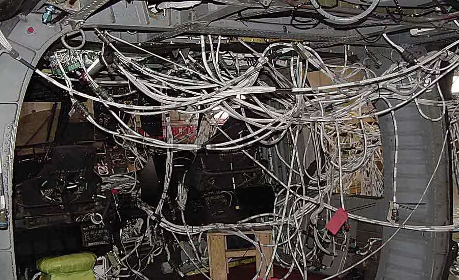

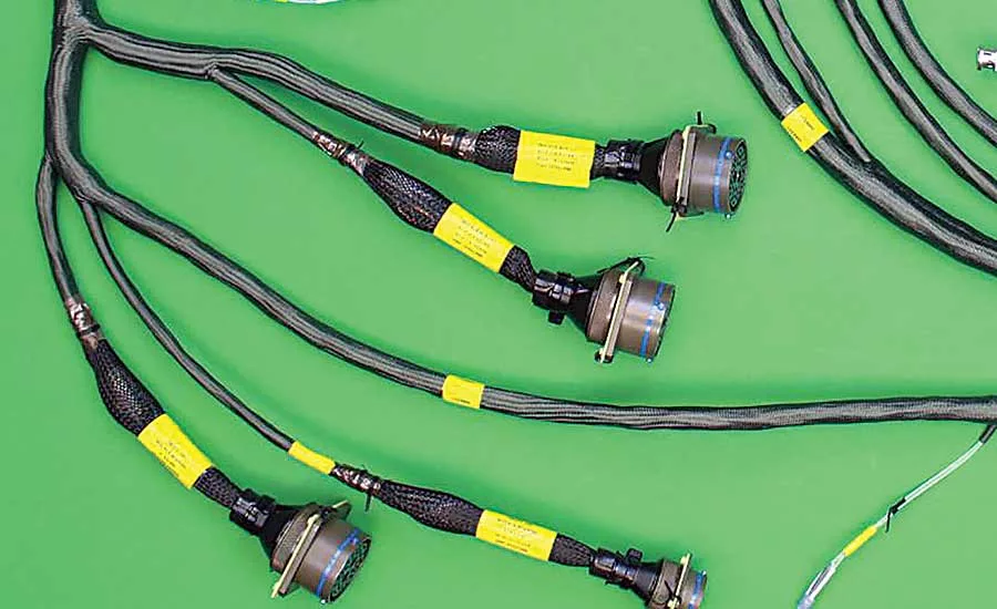

Harness Bundle Protection
A common question in the aerospace industry is, “What’s the best way to hold a bundle of wires together?” There are five main methods used in the aerospace industry: string ties, tie wraps, expandable braided sleeving, heat-shrink tubing and braiding.
Each has advantages and disadvantages. The least costly (and lightest weight) method is string ties. The best-looking wire harnesses are braided (especially with a variety of colors). The OEM will typically specify which method to use.
Also known as cable lacing, string ties consist of a thin cord, traditionally made of waxed linen, that binds together a group of wires using a series of running lockstitches. This method is inexpensive, easy to modify and repair, lightweight and stays tied over decades. On the down side, it does not protect the wire bundle. Some wires can accidently move out of the bundle during installation or retrofit programs. Wire bundles can potentially lose their shape. And, installation is time-consuming.
Tie wraps are available in a variety of materials, styles, lengths, widths and colors. They are inexpensive, easy to modify and repair, lightweight and quickly installed. But, like string ties, they do not protect the wire bundle. In addition, they can break off (creating a foreign object debris issue), and their use conflicts with the requirements of SAE AS50881.
Expandable braided sleeves offer some protection to the wire bundle. However, they can be expensive, and they add weight. In most cases, they do not provide a close fit around a wire bundle, and it takes time to push a wire bundle through the sleeve.
Heat-shrink tubing offers very good protection to the wire bundle, and it lasts a long time. But, like sleeving, it can be expensive, and it does add weight. Similarly, it takes time to push a wire bundle through the tubing, and it takes time to shrink the tubing over the bundle. The biggest disadvantage is that you cannot access the wires under the tubing after it has been shrunk.
Braiding has many advantages. It offers excellent protection to the wire bundle. It increases the physical appearance of the wire harness. It lasts a long time, and it compacts the wire bundle to aid in installation.
Color-coded braiding helps to easily identify a wire harness, and metal braiding provides EMI protection.
On the down side, braiding adds weight, and it’s expensive to hand braid each wire harness. If additional wires are needed in a wire harness, they must be “piggy-backed.” That is, they must be individually braided and run outside of the braid of the existing bundle assembly.

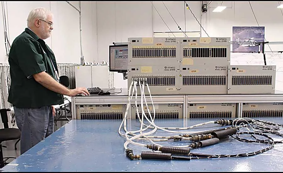

Testing
Aircraft wire harnesses are tested using automatic equipment commonly called wiring analyzers. Many companies make wiring analyzers. Unique programs tell the analyzer what tests to run, how much current and voltage to use, and how long to apply current. A technician connects the wiring analyzer to the wire harness using adapter cables.
The two most common tests are continuity and insulation resistance. But, wiring analyzers can do other tests as well, including empty contact cavity tests, AC dielectric tests, light lights, energize relays, measure capacitance, measure resistance, and ensure that diodes are working correctly.
Continuity tests ensure that each wire is connected in accordance with the design. For example, if a wire is supposed to be connected from connector 1 at pin 13 to connector 2 at socket 34, the continuity test will verify that the wire is there. Continuity tests are performed at 0.5 amp with a constant voltage and a minimum dwell time of 0.2 second.
The insulation resistance test (also called a megohm test) checks for short circuits. As an example, if two wires have nicks in the insulation and are close to one another, the insulation resistance test will show a short circuit. If a connector was not manufactured correctly and there is not enough material to separate two contacts, the insulation resistance test will show this short circuit as well.
Insulation resistance tests are run at 1,500 VDC with a constant current and a minimum dwell time of 0.15 second. The insulation resistance test does what the name suggests: It ensures there is enough resistance between two or more conductors so that a short circuit will not result. If the resistance is greater than 100 megohms, then it passes the test.
Most OEMs will specify how to test wire harnesses. The common military test standard is MIL-STD-202.
