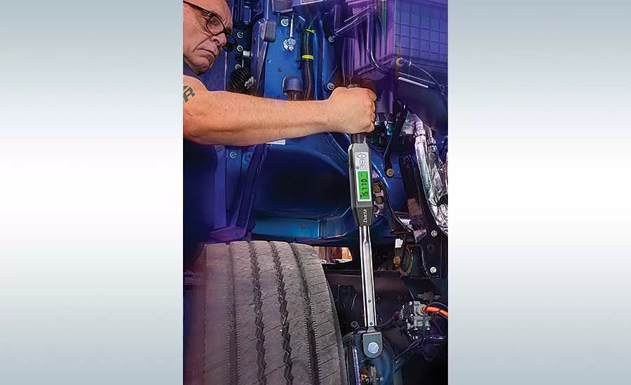

Several types of manual torque wrenches are offered by suppliers. These wrenches usually have the appearance of a socket wrench, but vary somewhat in internal mechanisms and recommended application.

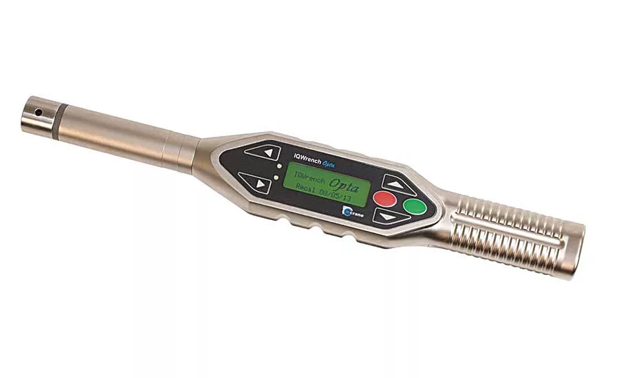

The IQWrench2 from Crane is a manually pulled, electronic transducerized beam wrench that combines high accuracy with a torque data collection system. It incorporates a vibrating handle and radio-frequency data transfer with optional bar code scanning capability. Plus, its advanced software can be upgraded at any time, increasing flexibility.
Hayden says that the tool comes with a wide selection of quick-release interchangeable heads (SR, fixed, Din), which have automatic digital identification and adjustable torque settings. The tool has a torque range of 0.5 to 1,500 newton-meters and is durable enough for harsh production environments.
“The algorithms in this wrench are able to detect and tell the operator when the fastener moves, and where it turned or relaxed,” explains Hayden. “Digital and smart, the wrench time-date stamps all data, and uses red, yellow and green lights to indicate high, low and good torque.”

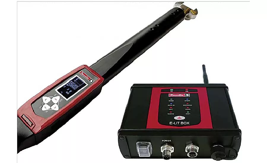

Desoutter Industrial Tools’ Delta manual torque wrench comes in three versions, all of which feature a double-bridge transducer and can measure torque and angle in production and quality applications. The standard unit has a visual backlight RGB color display and a complementary vibrating sensation system for optimal operator guidance. Interchangeable heads and reversible ratchets are standard.
Six models make up the WLAN series, with the smallest model having a torque range of 3 to 30 newton-meters, and the largest at 80 to 800 newton-meters. These tools feature a bidirectional communication protocol (DeltaWrench WLAN) that easily interfaces to custom applications via communication bridge software.
The third type is the Zigbee, which allows the operator to pair the wrench to the company’s E-LIT Box on a touch screen but without a PC. Torque range is the same as the WLAN.

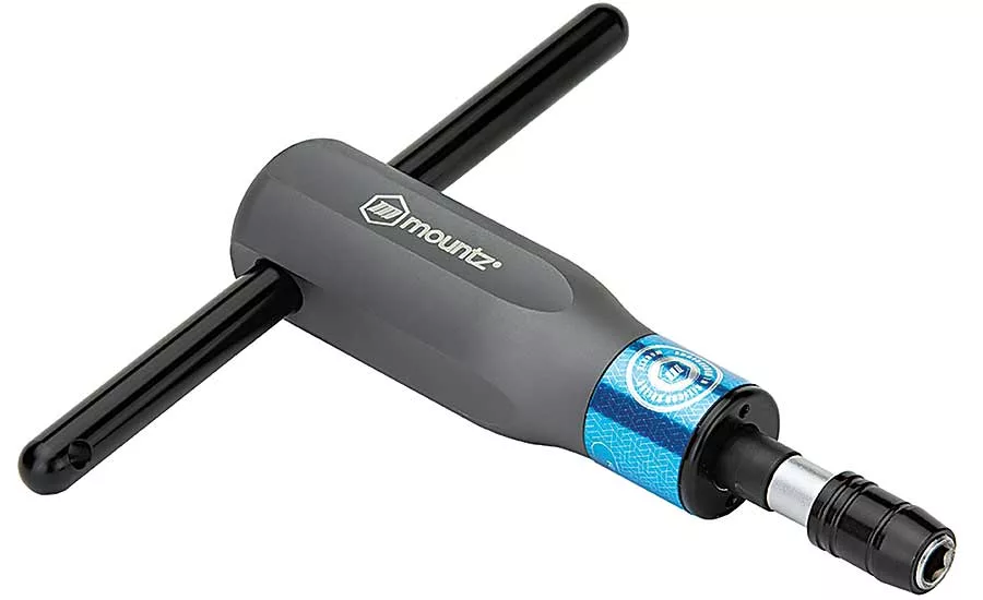

This past August, Mountz  introduced its FG preset hand screwdrivers that offer accuracy, repeatability, precision, durability and a calibration life of more than 20,000 cycles. Service is not required until more than 100,000 cycles.
One key feature is advanced cam-over technology that provides a completely smooth reset, reducing the risk of loosening or breaking fasteners. In addition, a patented secure bit-locking mechanism with one-touch release can only be activated by the user for applications that require greater flexibility and efficiency on the line. This design also prevents the operator from incidentally applying axial load on the fastener.
“You can give this to tool operators of all skill levels and feel confident that the correct torque is being applied,” says Brad Mountz, CEO of Mountz. “The chances for errors and breakage are greatly reduced. These preset drivers are designed to improve overall product quality, and worker productivity and safety in precision industrial applications.”
The FG line has a torque range from 0.8 up to 125 inch-pounds. Plus, the tools exceed the accuracy and repeatability requirements of ISO6789: 2017.
According to Mountz, the sleek tool feels great in the operator’s hand because the handle has few flutes and large recesses. He says that this design makes them more comfortable to hold, less likely to cause hand fatigue and easier to clean.
The tools are backed by a two-year unconditional manufacturer’s warranty. They also have a lifetime guarantee against manufacturing defects, and the initial recalibration in the first year is included.
“We don’t care if you run it over with a forklift,” says Mountz. “If it breaks, we’ll fix it or replace it for free.”

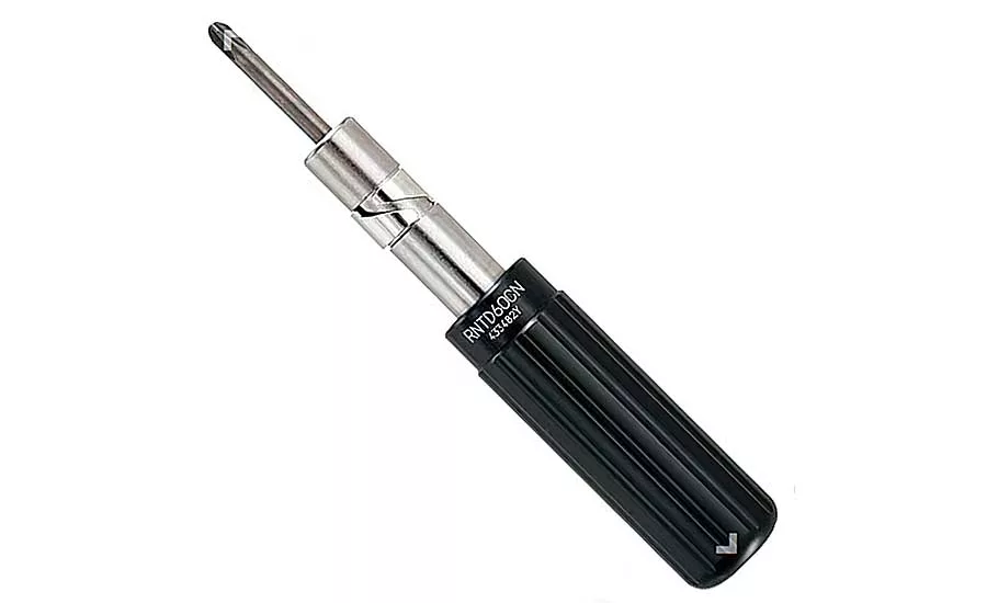

Preset RNTDLS screwdrivers by Tohnichi are error-proofing tools that feature a relay signal cable to confirm and count each tightening click on a fastener. The driver’s toggle is activated when the set torque is achieved. Rotary slip occurs simultaneously with output of a contact signal from the limit switch.
According to Kuby, these tools do require torque to be set with a tester and key, so that torque is set to one value and secured from unauthorized changes. Wired and wireless versions are available.
