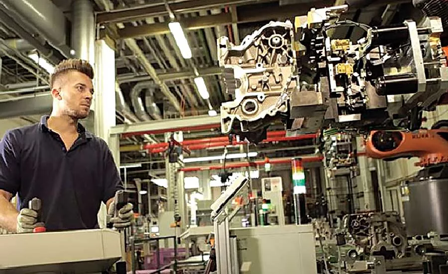

Each workstation operator controls the robot with a joystick, thereby allowing him to raise the crankshaft housing to the proper ergonomic height for easy and thorough inspection. Photo courtesy MRK-Systeme GmbH

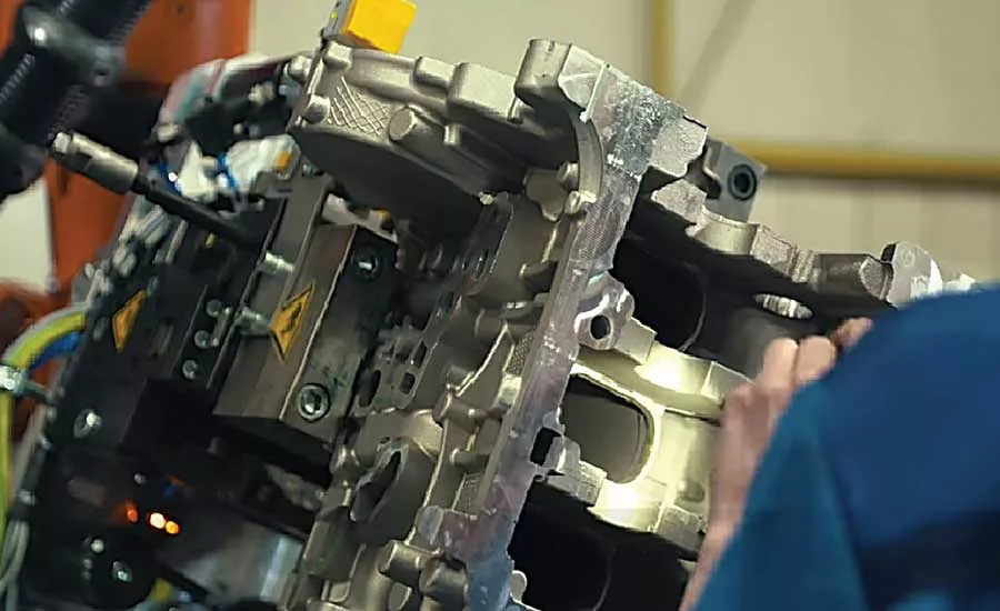

The operator walks around and inspects the raised housing, using a handheld cold light lamp to look for defects or imperfections. Photo courtesy MRK-Systeme GmbH

The system features two shelf-mounted KUKA KR 210 R2900 robots (each operated by a separate operator), and a joystick panel with three handles. An inspection cycle begins after a manufactured housing, which weighs about 66 pounds, is delivered on a conveyor belt into the workstation. Depending on housing design (three-, four- or six-cylinder engine), the station PLC automatically selects the appropriate program to control the robot’s movement.
The robot approaches the housing along a defined path, grips it, and brings the component to the operator. Next, the operator moves a joystick handle to raise and orient the housing as needed so he can walk around it to perform a thorough inspection using a handheld cold light lamp.
Housing height can be adjusted by the worker with a thumbwheel on the joystick. After performing inspection, the operator uses the joystick so the robot carefully lowers the housing back on the conveyor belt. He then presses a separate button to end the process and documents whether the part is OK or not OK.
To ensure maximum worker safety, the system features a PLC, a robot controller (which limits the robot to certain speeds) and an enabling switch. A robot cannot move at all unless the employee continuously holds down the switch. If the employee lets go of the switch, the robot stops immediately.
Mohre says that MRK’s automated system allows right- and left-handed operators to easily control the robot, and that the joystick functions intuitively. If the employee pushes or pulls it forwards or backwards, the robot moves in a parameterized direction. If the joystick is moved to the left or right, the robot realigns itself accordingly.
