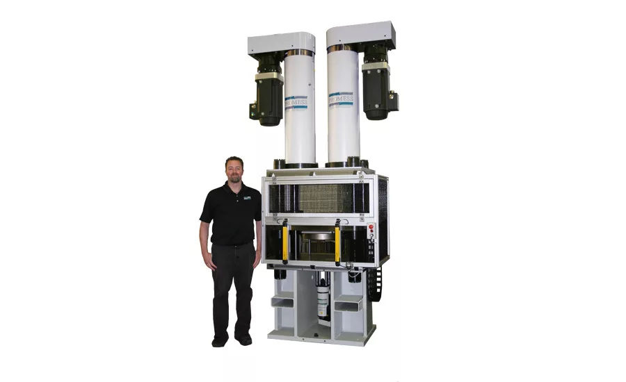

The precision, feedback and verification required in applications like this make fully electric servo press technology the right choice.  My company, Promess, has been involved in a number of battery projects in which Electro-Mechanical Assembly Presses (EMAPs) with built-in force and positioning control technologies have replaced hydraulic press systems in both electrolyte pressing and subsequent assembly operations.
The EMAP is essentially a CNC press consisting of a ball-screw driven by a servomotor and equipped with an array of sensors to measure position, force, and any number of other process parameters. In what is rapidly emerging as a standard solution for automotive batteries, a pair of EMAPs equipped with integral force and position measuring instrumentation press a pair of electrolyte-filled die plates together simultaneously. The operation is managed by a Promess UltraPRO multi-axis controller that precisely synchronizes the motion of the EMAPs and monitors the amount of force being applied.
Once the specified force and location parameters are achieved the system holds that force level for a programmed time to allow the electrolyte to solidify. All of the data is stored to provide 100 percent traceability for every battery.
