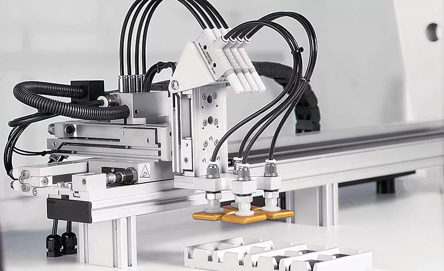

Linear pneumatic actuators, such as the Aventics rodless RTC series, are easy to combine for X, Y and Z motion. Photo courtesy Emerson

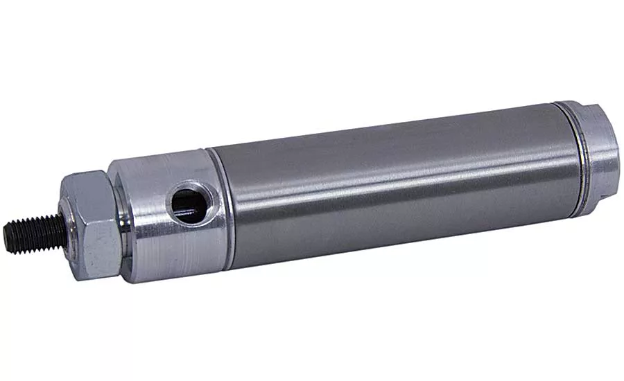

Charlie Bimba created the first non-repairable pneumatic cylinder in 1957. The revamped model, shown here, has a wear life of 3,000 miles. Photo courtesy Bimba Manufacturing

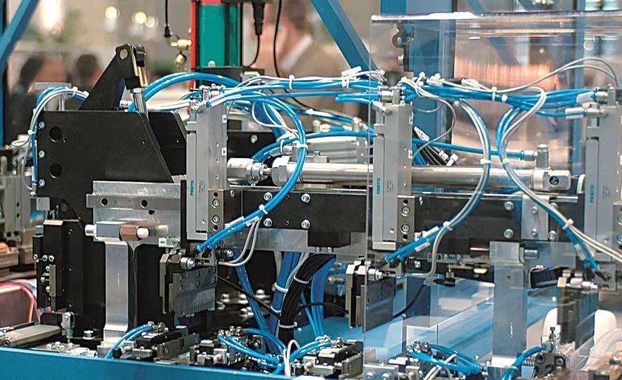

Manufacturers in many industries use pneumatic actuators to assemble a wide range of products. Here, actuators are used to assemble cables. Photo courtesy Festo Corp.

Shortly thereafter, non-repairable, small-bore-cylinder and pancake pneumatic actuators came to market, as well as those that generate rotary force. Charlie Bimba created the first non-repairable cylinder in his garage in Monee, IL, before founding Bimba Manufacturing in 1957. That cylinder, now known as the Original Line Non-Repairable Air Cylinder, became and remains Bimba’s flagship product.
“At that time, the only pneumatic actuators on the market were somewhat bulky and relatively expensive,” says Sarah Manuel, product manager for pneumatic actuators at Bimba. “The non-repairable ones feature a generic round body, are less expensive, last just as long and require no maintenance. Originally, these actuators had a wear life of 1,400 miles of travel. When we revamped them in 2012, their wear life was more than doubled, to 3,000 miles.”
PHD introduced its Tom Thumb small-bore-cylinder actuator in 1957. Today, as back then, the actuator features a National Fluid Power Association (NFPA)-standard cylinder, which is available and interchangeable from multiple equipment suppliers. It also incorporates a tie-rod construction that allows for flexure. PHD’s current small-bore-cylinder offerings provide high performance in most applications, and may come with double rods, high temperature seals and end-of-stroke sensors.

Rodless linear actuators are pneumatic actuators in which the power is transmitted via a lateral connection to the piston. This connection is either mechanical through a slot in the profile barrel or magnetic through a closed profile barrel. Some models may even use a rack-and-pinion system or gears to transmit power.
One benefit of these actuators is the required installation space is significantly smaller than with a comparable piston rod cylinder. Another benefit is the actuators can guide and support a load throughout the entire stroke length of the cylinder, making them a smart choice for longer stroke applications.
