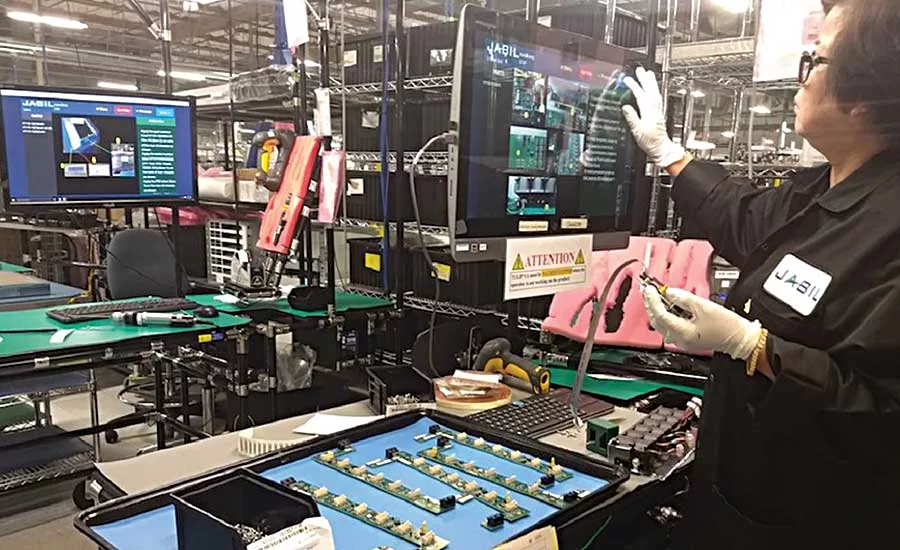

At one Jabil plant, assembly line workers must build more than 40 different complex electronic assemblies at any one time. Photo courtesy Tulip

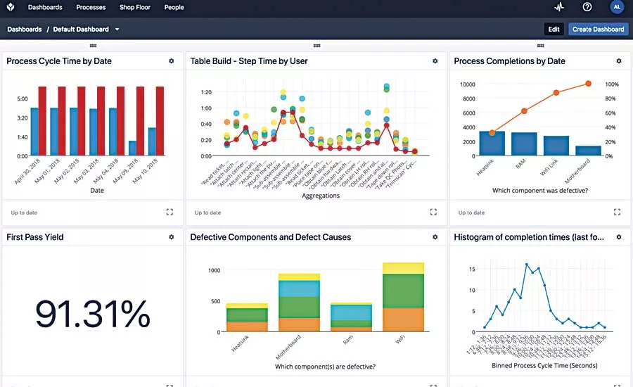

The Tables feature in the manufacturing app platform collects data in real time and displays it in tables and charts on an ongoing basis. Graphic courtesy Tulip

Despite these impressive credentials, Jabil does face assembly challenges at times. At one plant, assembly line workers must build more than 40 different complex electronic assemblies at any one time. Annually, the workers create more than 1,500 unique assemblies, each of which features a distinct combination of components.
To ensure that the operators complete each assembly efficiently and at the highest quality, Jabil recently installed a cloud-based manufacturing app platform from Tulip. With the platform’s App Builder system, Jabil’s process engineers are able to provide operators with step-by-step instructions for each assembly application. These instructions are clearly displayed on the monitor in each workstation along the assembly line, and ensure that a worker includes the correct parts in each assembly.
Jabil managers especially like that the application helps them identify and eliminate non-value-added steps in each assembly process, resulting in increased cell productivity, efficiency and product quality. Another benefit is the platform’s intuitive drag-and-drop interface, which is visual, interactive and user-friendly.

Another platform feature is called Tables. It lets users make data tables and databases as rigid or flexible as necessary to fit their unique business processes and adapt to evolving production needs. Data is collected in real time through interactive forms like drop-down menus, check-boxes and text fields, and includes feedback on key performance indicators for each manufacturing process. This data is displayed in tables and charts on an ongoing basis.
Simultaneously, the platform’s analytics engine automatically analyzes this data to optimize individual worker and cell productivity. Even during low-volume production runs, the platform’s real-time guiding, tracking and analyzing of operator and machine data ensures thorough root-cause analysis and continuous process improvement.
