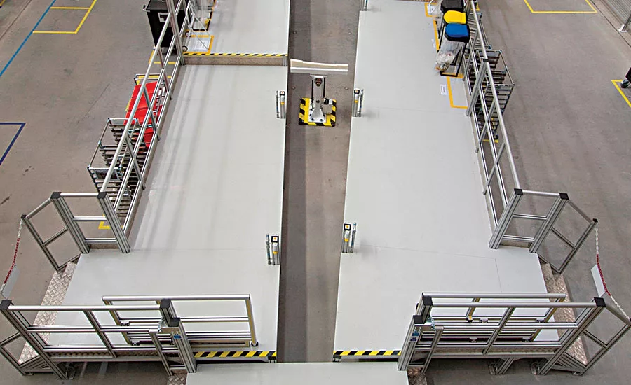

At its Broughton, UK, plant, Airbus builds wings horizontally for its A350 XWB airplane. Two types of aluminum-profile platforms allow workers to easily access all areas of the wings. Photo courtesy Bosch Rexroth

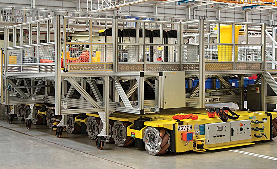

Airbus workers use four inboard and 36 lower-access platforms to build wings horizontally for the A350 XWB airplane. The platforms are maneuvered into place with AGVs. Photo courtesy Bosch Rexroth

To meet these challenges, Electroimpact had Bosch Rexroth custom develop two types of aluminum-profile platforms for the system. Inboard (near the center) platforms, measuring 14 meters long and 6 meters wide, are positioned at the widest part of the wing. Lower-access platforms feature hinged flip flooring that links together like a jigsaw puzzle.
A total of four inboard and 36 lower-access platforms are used to provide workers complete access across the length and width of each wing. The platforms are maneuvered into place with AGVs. Both types feature drop-down guarding, point-of-use services (such as air and electricity), floor lighting, access steps, handrails for fencing between production cells, and flag carts for component storage.
“The platforms [provide] access [to] all areas of the wing with minimal additional equipment, and give Airbus the chance to construct the new wing in a safe manner,” notes Griffiths. “Their modular design [also] offers more flexibility during manufacture and for ongoing modifications than a heavy, fixed welded structure.”
