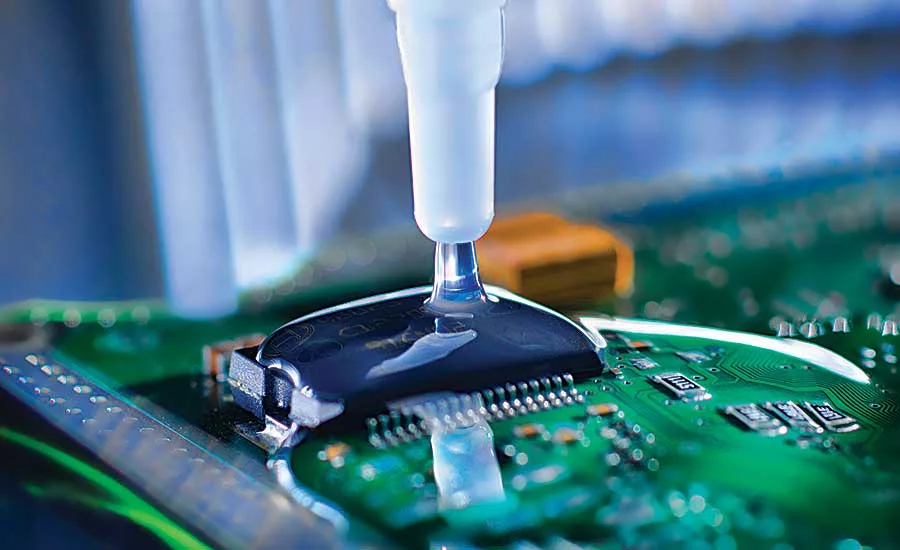

Efficient bonding, sealing and potting has a major influence on the sustainable function and safety of electronic components. The key to success here lies in the comprehensive view and control of process engineering. Here it pays to seek collaboration with the systems and the material manufacturer during the very early stages of the project. This is because dispensing systems must be selected for compatibility with the workpiece and the adhesive, sealant or potting compound used. And there are also other factors that play an important role in designing the optimum dispensing system:

Depending on the application requirements, air bubbles in the adhesive, sealing or potting material can lead to problems. If they reach the dispensing unit, they may falsify the dispensed quantity and the mixing ratio. This results in irregular production performance and even rejects. However, various technical solutions enable the minimization of the formation of air bubbles. For a bubble-free material, preparation under vacuum is the optimum solution.
Atmospheric or vacuum dispensing?
Atmospheric dispensing is standard nowadays and enough for many applications, but considering ever-smaller workpieces, increasingly complex geometries and higher quality requirements, vacuum potting systems are used more and more.
