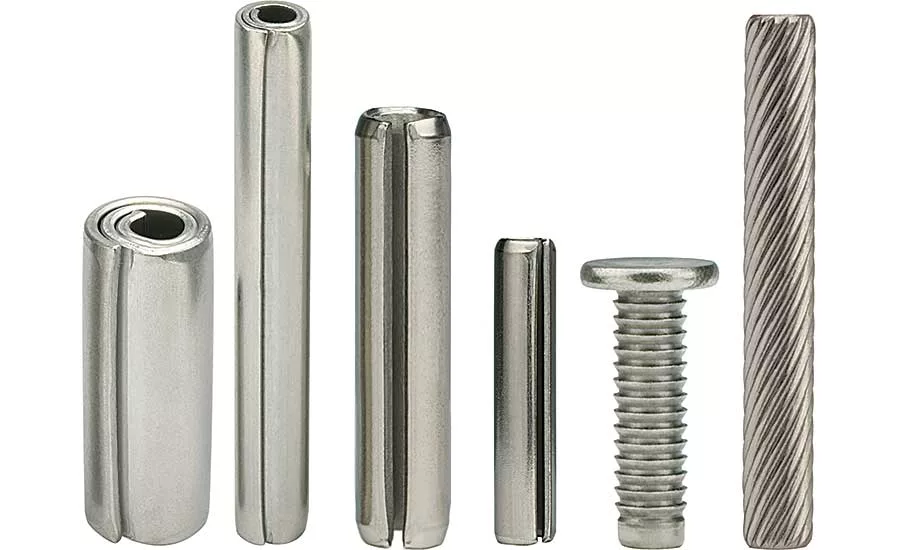

Among press fit pins, there are two general categories: Solid Pins and Spring Pins. Solid Pins can have a smooth, uninterrupted surface (such as dowels) or be designed with retention features such as knurls, grooves and barbs. All Solid Pins are retained by displacing the host material. Conversely, Spring Pins retain themselves by exerting a radial force (tension) against the hole wall after installation. There are two different types of Spring Pins: Slotted Pins and Coiled Pins. Slotted Spring Pins are general purpose, low cost pins typically recommended for non-critical assemblies. Oftentimes, Slotted Pins are used in applications where they are manually installed into mild to hardened steel components. Coiled Spring Pins are available in light, standard, and heavy duty to enable the designer to choose the optimum combination of strength, flexibility, and diameter suited for varying host materials and performance requirements.

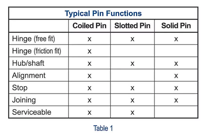

While there are many different ways to use pins, the most common are shown in Table 1. These guidelines apply the majority of the time, but each specific application should be evaluated for final determination of which pin type is most appropriate.

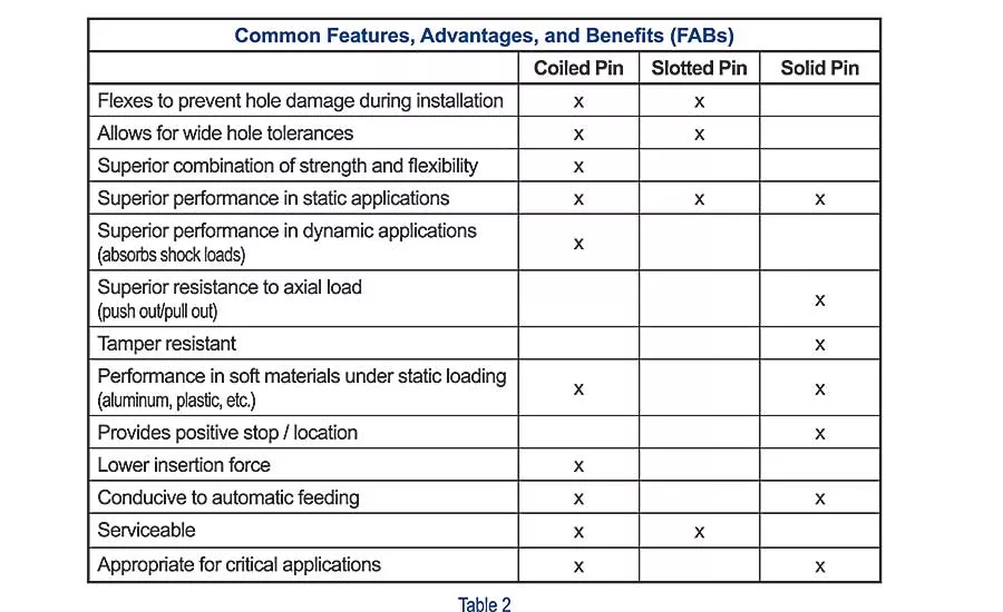

Each type of press fit pin serves a purpose for manufacturers. Table 2 compares the common features, advantages, and benefits for each type of pin.
