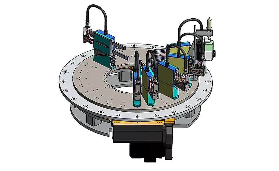

In the following example, the application needed a high-speed system to bring two parts (one from a conveyor shuttle, one from a vibratory feeder) into an ultrasonic welder to be processed, within a very tight space.
Application example:  Multiple HP70 Pick & Place units process parts while mounted to the interior section of a WEISS ring indexing table
By utilizing a flexible or freely programmable style of handling system the machine can be easily updated to align with new process parameters like motion profiles or stored positions directly from your machine HMI.  In more regulated industries, these smart units can log and output all of the captured data needed for traceability to a single piece.

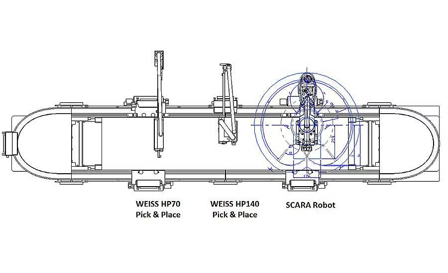

Linear/Track-based systems allow for a very narrow internal footprint, positioning part feeding or processing equipment around the outside of the system.  Pick & Place units, or SCARA robots are commonly deployed on top of the center section, to capitalize on the empty space.
When developing a machine layout, look to bring the equipment and stations “in” as close as possible, unless manual intervention or part tending is required. Traditional SCARA robots offer a great deal of flexibility, but also tie up a fair amount of real estate in order to manage range of motion and avoid interferences. Smaller, dedicated Pick & Place units can be set up for 2 axes of motion (or upgraded to include a θ rotary axis at end-of-arm), within a very narrow work space.
Application example:  WEISS HP Pick & Place units fit tightly within track-based systems.
In this example, you can see how comparable HP series Pick & Place modules compare to a SCARA robot with equivalent working range.  Multiple HP70 units can be set up on a 70mm mounting pitch whereas the HP140’s can be set up on a 140mm mounting pitch.  For added versatility, the HP70 can also be mounted overhead.  The tight mounting pitch allows you to leverage multiple independent process operations in a compact space.

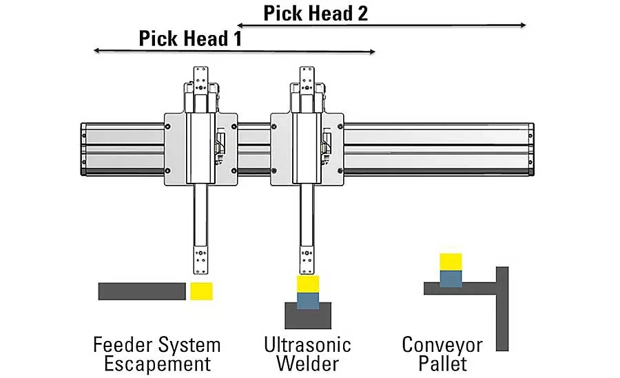

Application example: Dual Head Pick & Place
The WEISS handling gantry utilized (2) independently controlled pick heads, operating on a shared Y axis.  Pick Head #2 collects the base assembly from the conveyor pallet as Pick Head #1 collects the top part from a vibratory feeder escapement.  They orient the parts on top of each other under the welder, clear for the process, and Pick Head #2 moves the assembly back to the conveyor pallet for additional downstream processing.  The YZ+YZ handling system achieved the requirements of speeds up to 4 m/s and acceleration up to 40 m/s² - all within a 1,000mm long x 200mm wide form factor.  This configuration is commonly used when part orientation, intermediate assembly/processing, or inspection require a step in between the pick and the place positions.
