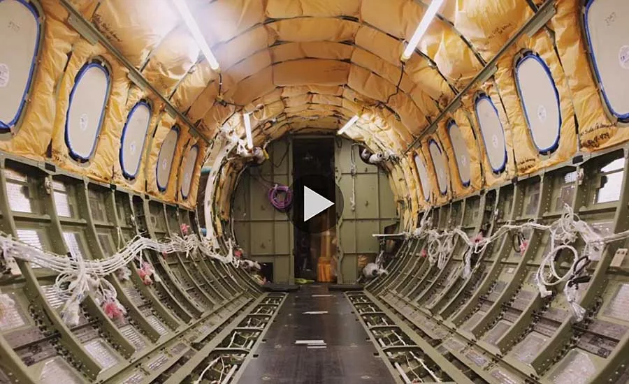

The body of an aircraft vibrates from the turbulent layer of air moving along the fuselage. To reduce this vibration and noise, damping tiles are bonded directly against the inside of the fuselage skin. Photo courtesy Avery Dennison

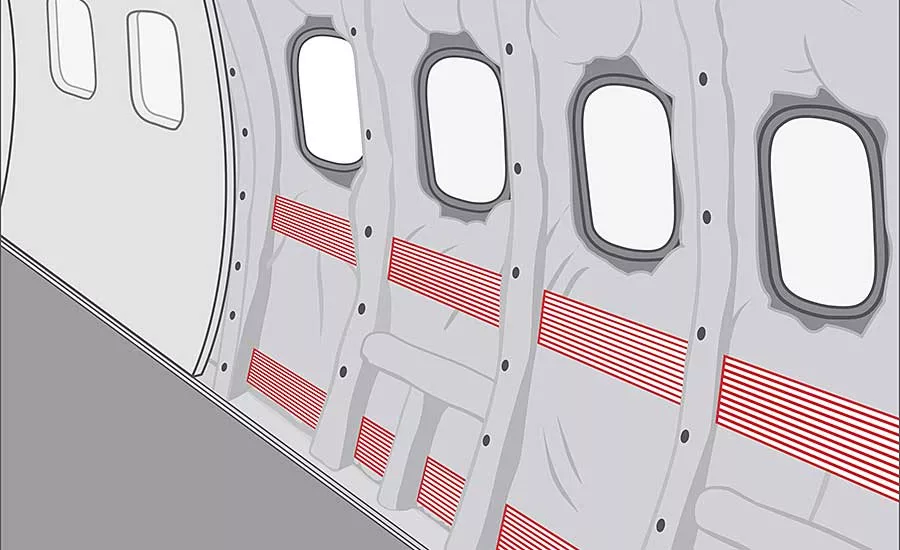

PSAs are used to seam the thermal insulation materials together before placing the insulation between the plastic structure of the cabin and the aluminum frame of the fuselage. Photo courtesy Avery Dennison

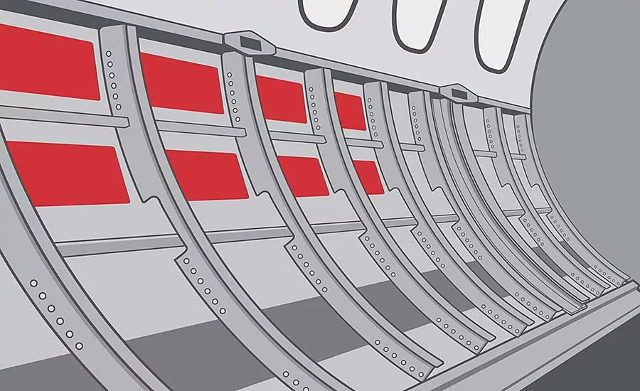

The most suitable way to seal off acoustic insulation is with a single-coated tape with a face-stock similar to the material that encapsulates the fibers. Photo courtesy Avery Dennison

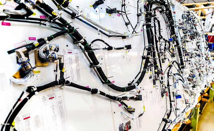

Aircraft wire harnesses are wrapped in a single-sided tape to shield them from abrasions and high temperatures and to limit motion of the harness. Photo courtesy American Precision Avionics

Thermal insulation is wrapped around the inside of the fuselage. PSAs are used to seam the insulation materials together before placing the insulation between the plastic structure of the cabin and the aluminum frame of the fuselage. A single-coated tape is also used in the cargo pit along the plastic panels to seal cargo compartment liners, bonding to the plastics and not the insulation material.
Acoustic insulation is also used in the fuselage, between the plastic structure of the cabin and the aluminum frame of the fuselage. This insulation muffles the sound of the jet engines and the wind streaming past the fuselage. It consists of tough materials, such as glass, polyester or nylon fibers. These are in turn sealed up in films that are often made of metalized polyester, such as PEEK or PVF. The most suitable way to seal off these films is with tape. Sealing off the insulation is accomplished with a single-coated tape with a face-stock similar to the material that encapsulates the fibers.
A related application is structural damping. The body of an aircraft vibrates from the turbulent layer of air moving along the fuselage. To reduce this vibration and noise, damping tiles are bonded directly against the inside of the fuselage skin. Damping tiles consist of a PSA, an elastomeric material and a foil. The adhesive layer can be specifically for mounting the damping tile to the fuselage, or it can be formulated for specific rheological properties to aid in the damping of the vibrations.

Aircraft wire harnesses are wrapped in a single-sided tape to shield them from abrasions and high temperatures and to limit motion of the harness. The tapes encapsulating these fibers are often laminated with a scrim to provide puncture resistance against structures and piping. Metalized-glass cloth acts as a thermal barrier.
