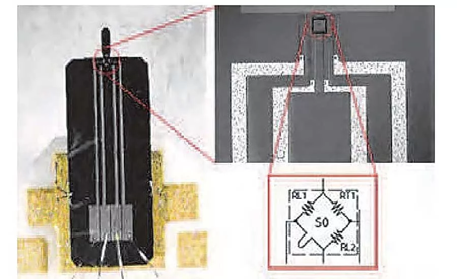

University of Tennessee researchers installed 30 microcantilever-based sensors in a tibia prosthetic to create an accurate, yet computationally efficient, data map. PHOTO COURTESY MASTER BOND INC.

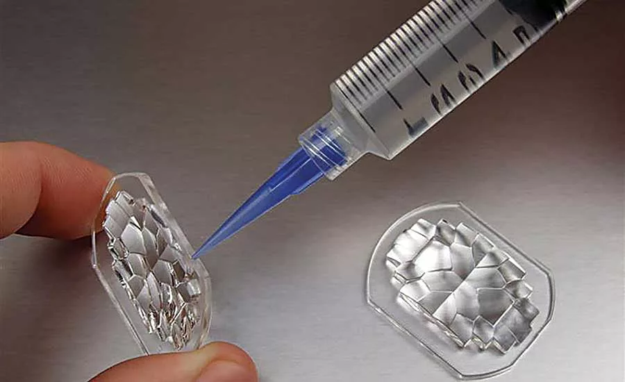

Optically clear, the EP30Med epoxy bonds well to metal, plastic, glass, wood and ceramic. PHOTO COURTESY MASTER BOND INC.

Recently, University of Tennessee researchers tested four medical-grade adhesives to determine their biocompatibility and reliability levels as an encapsulant of tiny microcantilever-based sensors within a prosthetic for the upper tibia. The sensors accurately measure how a repaired knee joint performs following total replacement (arthroplasty) surgery.
Arthroplasty alleviates arthritic pain by capping the ends of the bones that form the joint and kneecap with metal and plastic. An invasive surgery, the procedure resurfaces the damaged segments of the knee joint, and is generally performed following unsuccessful attempts to treat the existing bones. When successful, arthroplasty lessens osteoarthritis (a degenerative joint disease), rheumatoid arthritis (pain due to inflammation) and traumatic arthritis (due to injury).
In this research project, the researchers installed 30 microcantilever-based sensors in the prosthetic to create an accurate, yet computationally efficient, data map. They also intentionally chose non-cost-prohibitive sensors to mimic the market forces that medical professionals would face when selecting sensors for a similar application.
The researchers decided to encapsulate the sensors to protect them from damage and to form an appropriate interface between the implanted device and the bone tissue. All of the sensors, along with a force sensitive resistor, were encapsulated in 2 millimeters of epoxy. A moderate force was then applied to both for several minutes.
Of the four epoxies tested, EP30Med from Master Bond Inc. performed the best. Researchers concluded that this was due to the two-component adhesive’s low viscosity, non-rapid cure time, and minimal amount of air bubbles present during the curing process. Together, these factors produced a homogenous material and a durable bond. Equally important, the adhesive is biocompatible, per USP Class VI testing.
On the downside, however, the researchers did note some epoxy shrinkage and that encapsulating such a large number of sensors is labor intensive and time-consuming. Nevertheless, they concluded that EP30Med is a sound choice for such a procedure.
Since this project, the adhesive has also been used to encapsulate microcantilever sensors in high-frequency resonators and photothermic spectroscopes. Other uses include high-performance bonding, sealing and coating applications in food production and safety, as the adhesive meets FDA CFR 175.105 and 175.300.
EP30Med has a four-to-one mix ratio by weight and contains no solvents or diluents. It is optically clear; bonds well to metal, plastic, glass, wood and ceramic; resists water, oils and many organic solvents; and is serviceable over a temperature range of -60 to 250 F. To optimize performance, the recommended cure schedule is overnight at room temperature.
