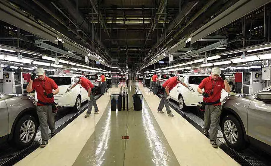

In May 2017, a ransomware attack halted production at Nissan’s assembly plant in Sunderland, UK. PHOTO COURTESY NISSAN MOTOR CO. LTD.

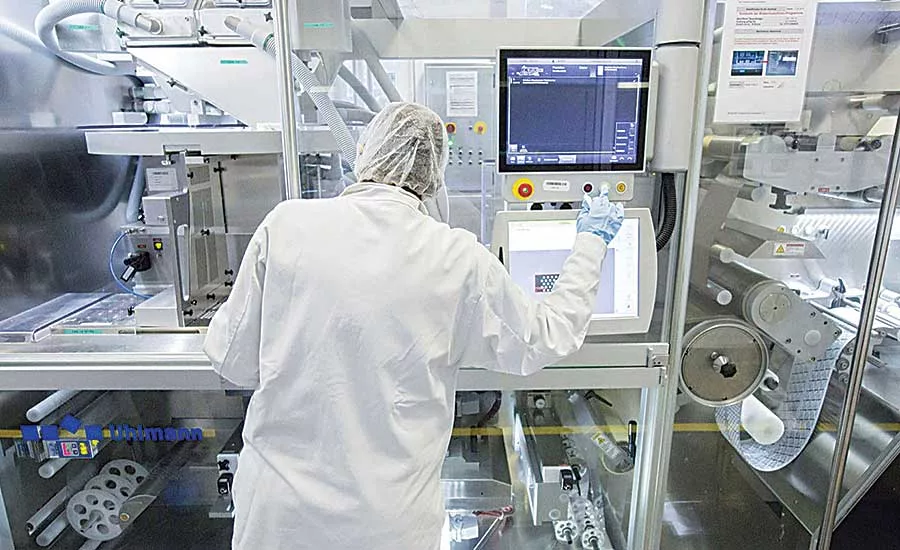

A ransomware attack in June 2017 affected production at numerous manufacturers around the world, including pharmaceutical giant Merck & Co. PHOTO COURTESY MERCK & CO.

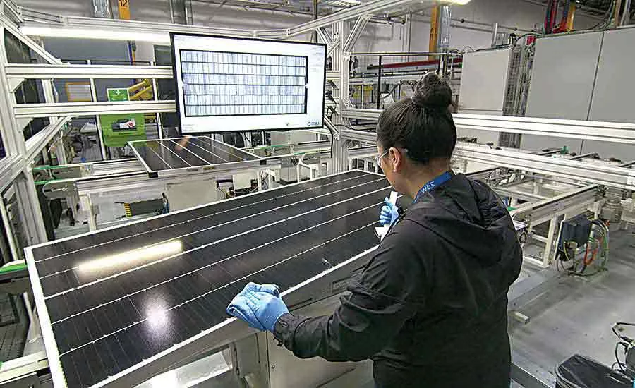

In 2012, Chinese hackers stole thousands of electronic files from solar panel manufacturer SolarWorld AG, including information about the company’s cash flow, manufacturing metrics, production line information, costs and communications relating to trade litigation. PHOTO COURTESY SOLARWORLD AG

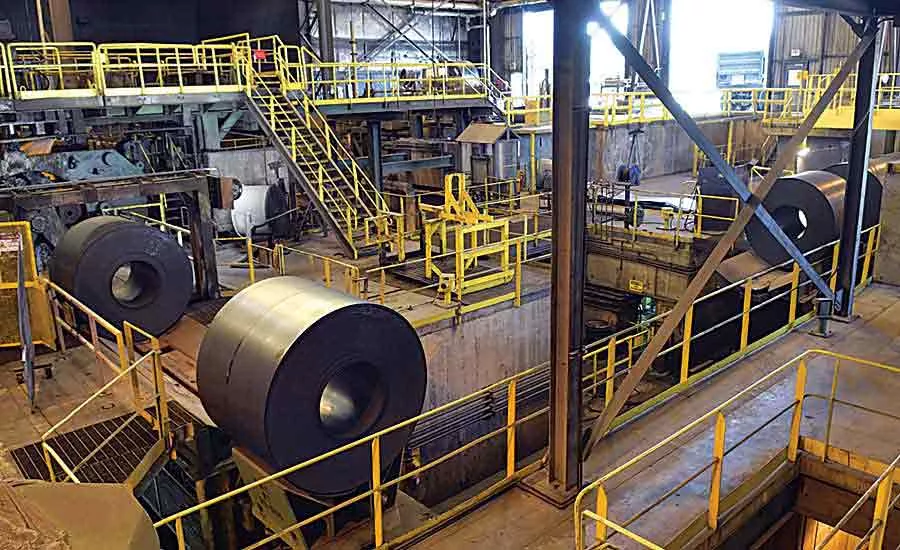

In 2010, Chinese hackers used spearphishing e-mails to penetrate the computer networks of U.S. Steel Corp. PHOTO COURTESY U.S. STEEL CORP.

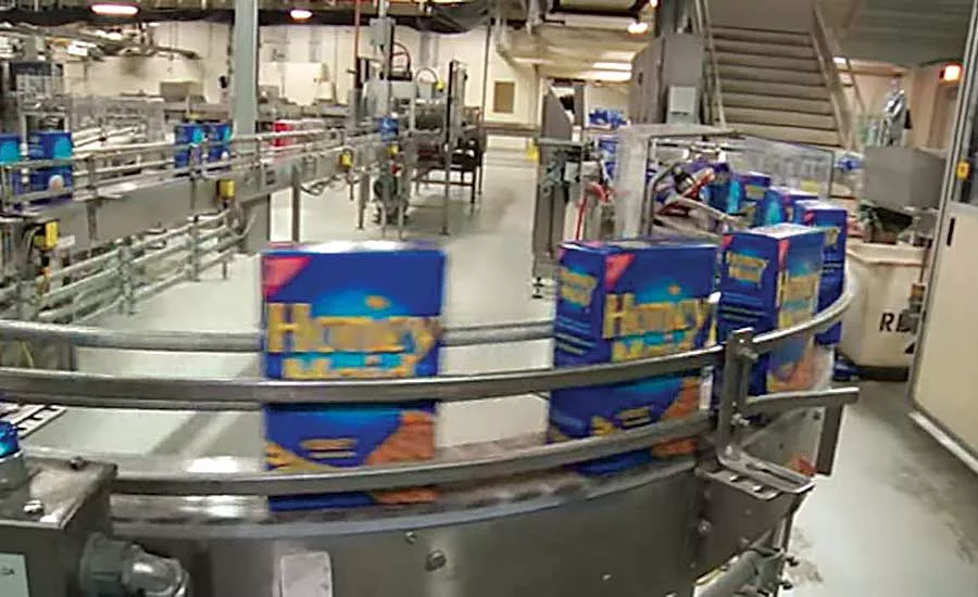

Food manufacturing conglomerate Mondelez International was one of many companies hit by the NotPetya computer virus in 2017. PHOTO COURTESY MONDELEZ INTERNATIONAL INC.
