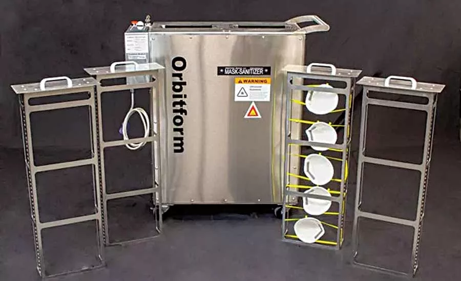

Ten N95 face masks and respirators can be decontaminated during each UV exposure cycle. Image courtesy of Orbitform Medical.

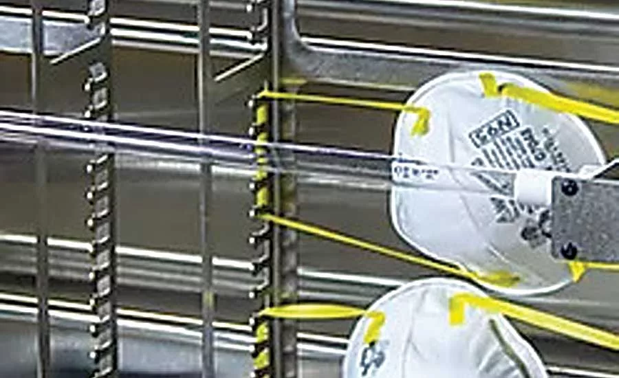

Orbitform can manufacture 20 UVC-DCs per week, but they are confident they can build more if demand rises. Image courtesy of Orbitform Medical.

These masks are not designed to be reused or shared, however the shortage has required medical professionals to do just that. To aid and protect healthcare workers, Orbitform Medical has developed the UVC Decontamination Chamber (UVC-DC) which can decontaminate ten N95 masks per cycle.

The UVC-DC equipped with eight germicidal UV-C bulbs. Four are positioned in front of the masks, and four are behind the masks. Ten N95 face masks can be decontaminated during each UV exposure cycle of 10 minutes.

To decontaminate masks an operator loads up to ten N95 respirators, with five masks per rack. Orbitform recommends that each mask be labeled and dated. In addition, a tally mark should be placed on each mask to denote the number of decontamination cycles it has been through.
Next, the operator loads the racks into the chamber.  If the machine senses the racks have been loaded properly, it signals to the operator the chamber is ready. The operator then hits the power button and the chamber turns on the UVC light bulbs for 10 minutes.
Once the cycle is complete, the operator removes the racks, places the decontaminated face masks into bags and returns the bags to the proper user. Shirkey says it is important to maintain chain of custody of each mask through the process so that the same mask returns to the same person.
