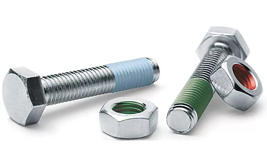

Threadlocker strength level is visibly indicated by a specific color, based on either MIL-S-46163 or ASTM D5363.  Photo courtesy Henkel Corp.

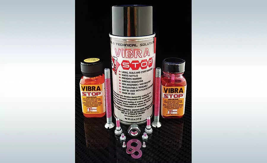

Unlike most threadlockers, Vibra-Stop is a spray and effective on plastic surfaces. PHOTO COURTESY TECTORIUS

A few years ago, a leading manufacturer of automotive components was experiencing a problem with its window regulators. Customers were hearing the amplified rattling of four window regulators within their vehicle doors.
The parts in the regulators were not fitting together properly, leaving room for vibration (and therefore, noise) in the pulley assembly. Because the parts are made of hard plastic, a traditional threadlocker could not be used on the gear, according to Thurber.
“We had them apply a few drops of our Vibra-Stop threadlocker to the gear spline,” explains Thurber. “Unlike most threadlockers, Vibra-Stop is effective on plastic surfaces and does not cause any long-term damage. In this case, it acted as filler between parts, thereby damping vibration and eliminating noise.”

Strength level is visibly indicated by a specific color. Several years ago, USA military specification MIL-S-46163 dictated this color scheme, which includes purple for low strength (50 to 100 psi), blue for medium strength (115 to 200), red for high strength (200 to 350) and green for wicking or penetrating grade (90 or so). It is important to note that most, but not all, threadlockers are coded according to this scheme, and that the MIL spec is superseded by ASTM D5363 for new designs.
“We can customize the threadlocker color and physical properties for our customers for various reasons,” notes Thurber. “A company may want the typical red threadlocker to be green because it matches their company logo color. Or maybe their workers use two different-length fasteners in an assembly, so they want one to be pink and the other to be green to help the workers distinguish which one to install where.”

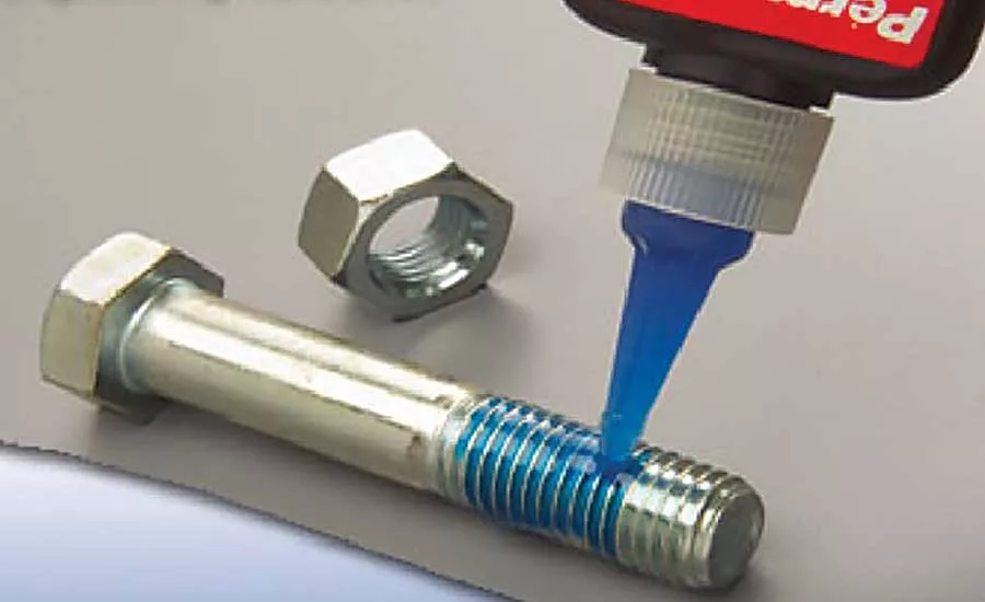

Low-, medium- and high-strength threadlockers can have a low, medium or high viscosity. Clark says that Permabond threadlockers have a viscosity range from 12 to 23,000 centipoise (cps), noting that water has a cps of 1. A threadlocker with a higher cps flows less, but more easily fills metal-to-metal gaps and is recommended for larger fasteners.
Under shear stress, the adhesive exhibits a time-dependent decrease in viscosity. This allows it to flow well over time, yet still resist short-duration vibration or shock. Low-viscosity formulations easily wick into pre-assembled fasteners up to 0.5 inch in diameter.
On the assembly line, threadlockers can be applied manually or with automated dispensing equipment. Pre-application ensures that the adhesive will actually be on the fastener, in the correct amount and in the correct location. The process also eliminates liquid mess, sloppy run-off and the possibility of running out of adhesive during production.

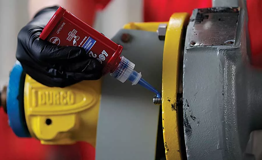

Henkel’s extensive threadlocker offerings include Loctite 243, a general-purpose, medium-strength blue threadlocker. Dan Shaw, a category manager for machine adhesives at Henkel, says the primerless threadlocker tolerates minor surface contaminations from various oils, such as cutting, lubrication, anti-corrosion and protection fluids. It performs well on 0.25- to 0.75-inch-wide fasteners in high-vibration and high-temperature environments (up to 180 C). Treated fasteners can be removed with hand tools.
“Billions of fasteners are installed in general industrial applications every year, but a vast majority of them do not have a threadlocker,” says Shaw. “There are many reasons, including lack of awareness or knowledge about threadlockers by manufacturers, their refusal to change traditional assembly habits and a misperception of higher cost.”
Permabond offers 10 threadlockers, including removable and permanent formulations. MM115 is a general-purpose, removable threadlocker that offers fast curing and medium strength for locking screws, nuts and bolts in assemblies and machinery. Available in 10-milliliter to 1-liter bottles, the adhesive fully cures at room temperature and is typically used on zinc, cadmium, steel and other plated fasteners.
“Today’s threadlockers have evolved in cure speed and their ability to cure on passive surfaces without the need for an accelerator,” concludes Clark. “They are also better at tolerating surface contamination and resisting higher temperatures. These improvements have resulted from customers having more demanding expectations and suppliers meeting them.”
