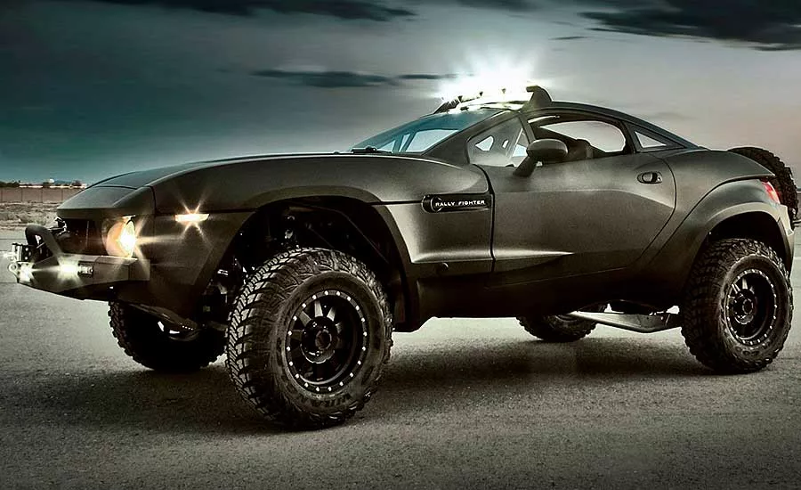

The Rally Fighter is a high-performance, off-road vehicle with thousands of parts. Loctite enables its nuts and bolts to withstand jarring bumps and racing in extreme conditions without constant tightening and maintenance.

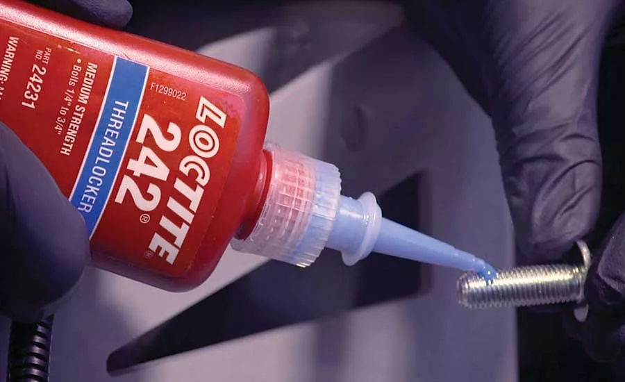

Available since the late 1950s, Loctite threadlockers completely fill thread roots on a fastener to prevent its side-to-side movement and increase the reliability of threaded assemblies. Local Motors uses three specific formulations: Threadlocker 243 on the Rally Fighter, and the 242 and 262 on the Strati.
Loctite 243 is a medium-strength adhesive, blue in color, that seals and secures metal fasteners. It is a general purpose threadlocker that provides a good bond on all metals, including passive substrates such as stainless steel, aluminum and plated surfaces. The product permits disassembly with hand tools for servicing and comes in 0.5-, 10-, 50- and 250-milliliter bottles.
Also medium in strength is blue Loctite 242, which is for metal thread sizes up to M36. The product is a medium-viscosity adhesive with a methacrylate base. It provides fixture times on steel, brass and stainless steel of five, 15 and 20 minutes, respectively. The product is also thixotropic to prevent migration after application and is intended for fasteners that require normal disassembly with standard hand tools.
Another formulation used extensively on the Strati is Loctite 262. Red in color, this threadlocker offers medium to high strength in a thixotropic methacrylate-based adhesive that also fluoresces under UV light to allow monitoring. Fixture times, respectively, are 180 minutes for stainless steel,15 for steel and eight for brass. Suitable for all metal fasteners, formulation 262 is ideal for applications where any adhesive migration must be prevented.
