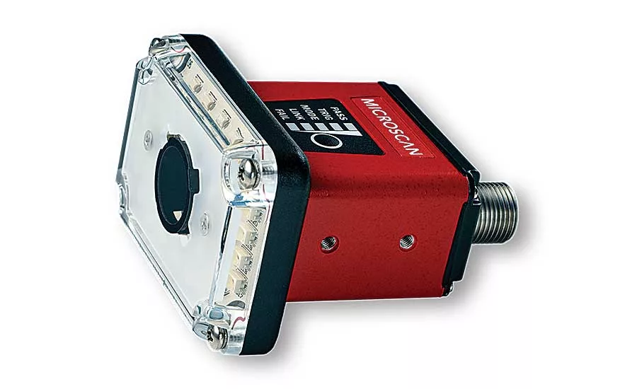

Many assembly operations begin with the scanning of a 1D or 2D bar code.

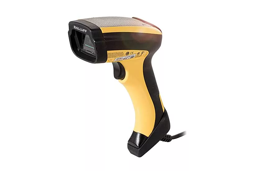

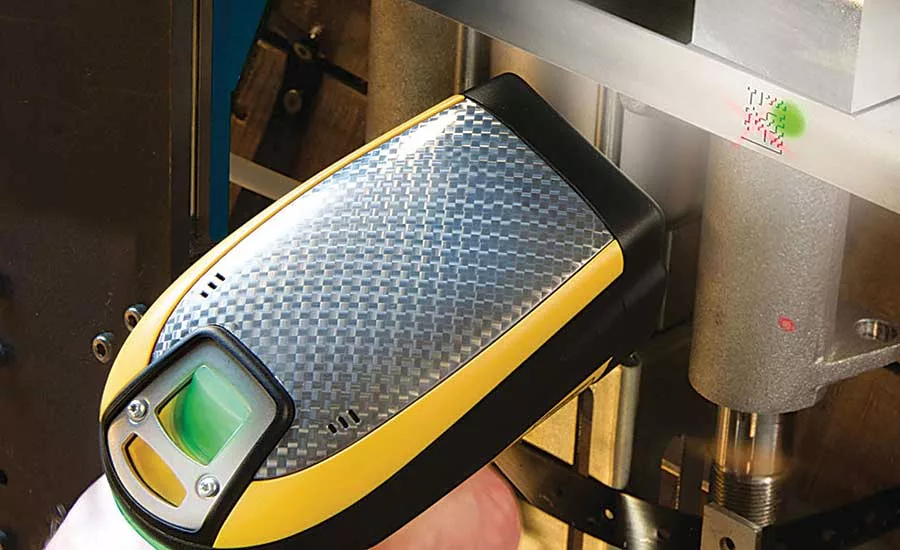

Handheld code readers have the advantage of mobility, which is ideal for warehouse or dock applications. Photo courtesy Balluff Inc.

The BVS series of handheld code readers can quickly and reliably read all standard 2D, 1D and stacked bar codes. Photo courtesy Balluff Inc.

Vision-based readers can read poor quality codes better than laser scanners, and they can read codes from multiple direc-tions. PHOTO COURTESY OMRON AUTOMATION AMERICAS

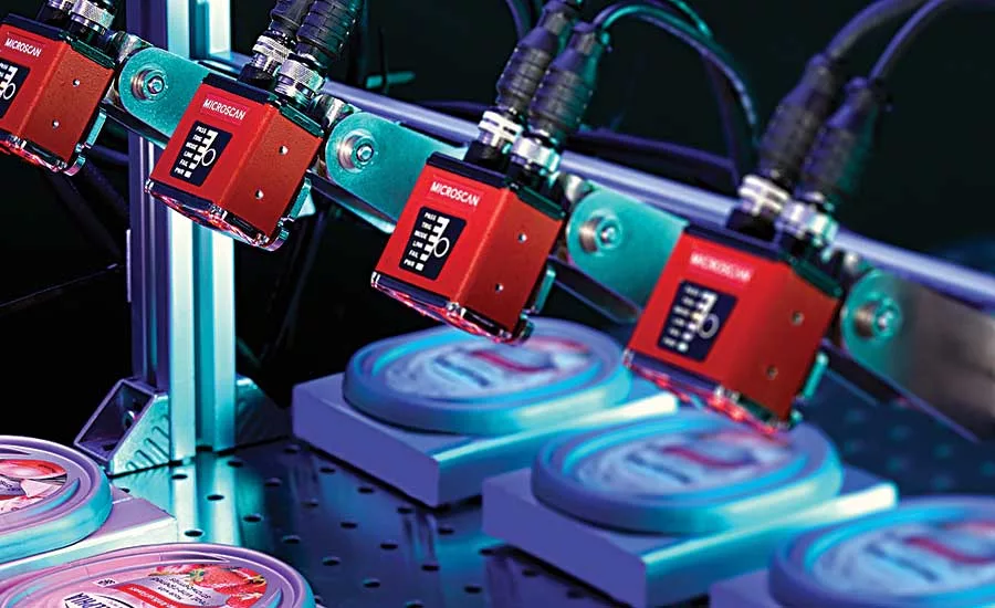

If the application calls for reading parts or boxes moving on a conveyor, then a small fixed reader is a good choice. Photo courtesy Omron Automation Americas

Vision-based readers are more flexible than laser-based readers. In addition to 1D bar codes, they read plain text and 2D codes, such as Data Matrix, QR or Maxi codes. They can read poor quality codes better than laser scanners, and they can read codes from multiple directions.

If the application calls for reading parts or boxes moving on a conveyor, then a small fixed reader is a good choice. A fixed reader saves the time needed to pick up the reader, scan the code, and set it back down again.
In addition, fixed readers have a much smaller form factor than handheld readers, says Klebe. For example, the MicroHAWK V430-F code reader from Omron measures just 44.5 by 44.5 25.4 millimeters. Rated IP65 or IP67, the reader features X-Mode advanced decoding algorithms; advanced data output formatting; liquid-lens autofocus for reading codes at different distances; and optional LED lighting for extra illumination in red, white, blue or infrared. Sensor resolution ranges from 0.3 to 5 megapixels. A variety of interfaces are available, including Ethernet and Profinet.

The new BVS HS-P handheld bar code readers from Balluff read all common 2D, 1D and stacked bar codes quickly and reliably. The HDW variant can read high-resolution codes (to 2.5 mil for 1D) as well as large areas (up to DIN A4) from a distance of up to 70 centimeters. The DPW variant is optimized for reading codes marked directly on parts. The reader offers industry standard IP 65 protection and can withstand repeated drops on concrete from a distance of up to 2 meters. Wireless models with Bluetooth give users maximum mobility up to 100 meters from the base station.
