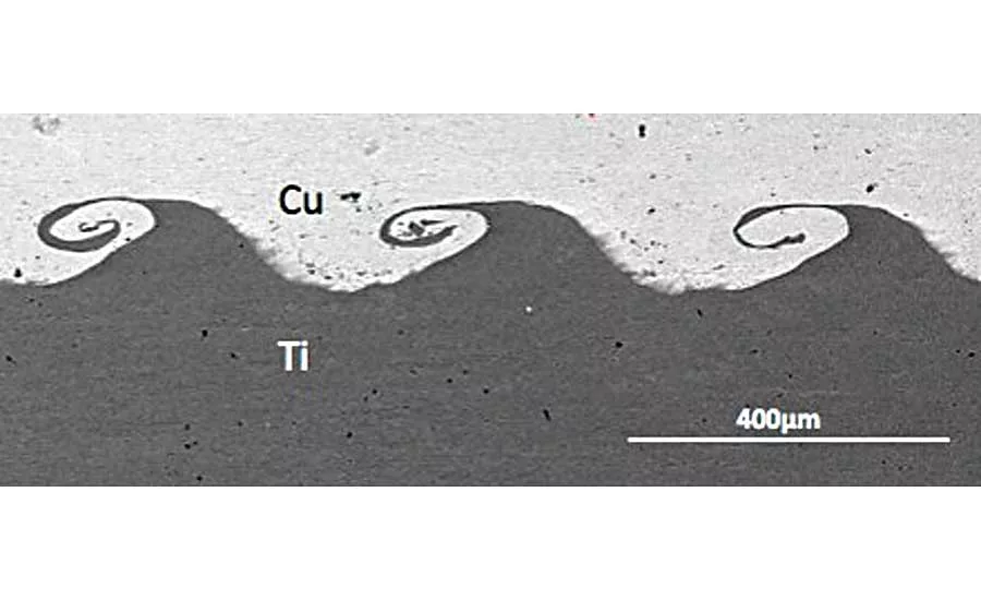

The bond formed between the copper and titanium is the result of vapor foil actuator welding, that uses high-velocity collisions to create solid state welds. PHOTO COURTESY APPLIED IMPULSE INC.

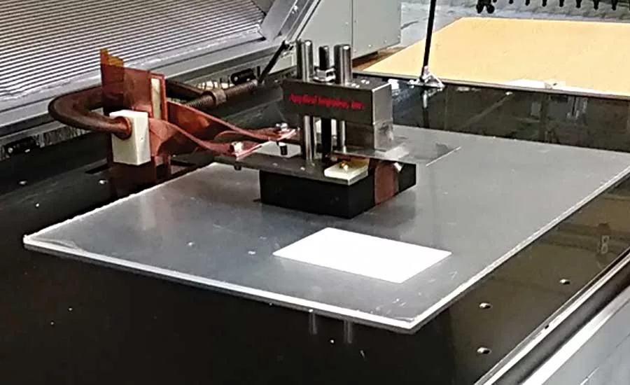

The VFAW system is available for commercial use, allowing manufacturers to utilize the speed and accuracy of impulse welding in their own operations. PHOTO COURTESY APPLIED IMPULSE INC.

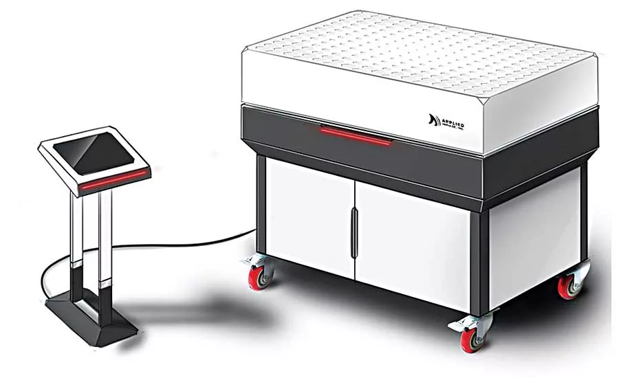

Applied Impulse Inc. has also made beta manual versions of the VFAW system for weld training schools and prototype shops. PHOTO COURTESY APPLIED IMPULSE INC.

Vapor foil actuator welding uses a high-voltage current to vaporizing foil actuator welding uses a high-voltage current to vaporize the foil actuator, which forces one material toward the target material at a high velocity to join the metals on impact. The angle of the collision and the velocity of the collision allow for even dissimilar metals to be joined without leaving the solid state. VFAW can be used for launching sheet metal of various thicknesses to velocities ranging from 300 meters per second to 1 kilometer per second.
VFAW can be used for long or spot welding without damaging material coatings or burning adhesive or polymer components.  Additionally with this method, the flyers can be over 0.25 inch thick. VFAW can be used to join different material types, such as castings, extrusions and sheets, as well as expanding or compressing weld tubes. At the Impulse Manufacturing Lab, Daehn and his team have been able to join aluminum and magnesium, aluminum and iron, aluminum and titanium, aluminum and nickel, aluminum and copper, titanium and iron, and copper with iron.
