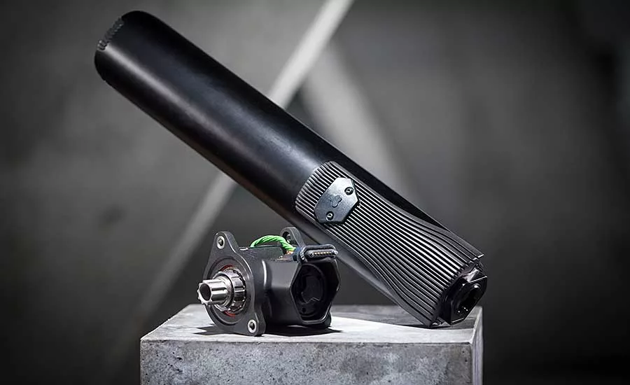

The Evation drive system consists of three components: the Drivepack, battery pack and angular gearbox. The Drivepack contains the electric motor and electronics. It also houses the 36-volt lithium-ion battery pack. The motor can generate 450 watts of peak power and weighs 4.2 pounds, without the battery pack. The battery provides 252 watt-hours of energy and weighs 3.1 pounds.
About the size of a water bottle, the battery slides into the Drivepack, and the whole unit is designed to fit into the down-tube of a bicycle frame. This allows OEMs to create e-bike frames with an elegant and discreet look. In addition, the rider can easily remove the Drivepack and use the bike as a normal, nonmotorized ride.

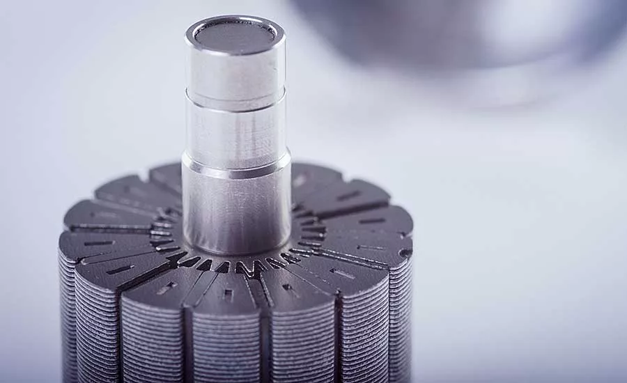

Design is crucial for a compact, yet powerful motor. Fazua uses motors with rare earth magnets, since they have the highest efficiency. Traditional methods for attaching the magnets to the rotors, such as mechanical clamping or banding, are reaching their limits. The manufacturing tolerances required for clamping can quickly drive up costs. In addition, clamping provides no protection against corrosion of the magnetic coating or the magnet itself. Banding the magnets is a complex process requiring precise control over tension, speed and temperature. The banding also increases the size of the motor assembly.
Fazua has opted for another method for assembling the motor—adhesive bonding. Adhesive bonding provides better protection of the magnets’ passivation, nickel or epoxy coatings during assembly than other methods. Bonding also ensures an optimal embedding of the magnets into the lamination stack, leaving the smallest gap possible between the magnet and coil.
Adhesives provide impact resistance, which is essential given the high dynamic forces of electric motors. Adhesives also offer vibration-damping characteristics for noise reduction. Another advantage of adhesive bonding is that it distributes tension over a wide area. That’s important for coping with different coefficients of thermal expansion between motor components.
Adhesives for Motors
All these benefits persuaded Fazua to choose adhesives for attaching the neodymium magnets in its e-bike motors. Pockets hold the passivated block magnet in place while the adhesive cures.
After testing and consultation on adhesives with Credimex, a Swiss adhesives distributor, Fazua chose DELO-ML DB135. This dual-curing, methacrylate-based adhesive for metal is suitable for small gaps of up to 100 microns and is often used in electric motors. This impact-resistant adhesive has a service temperature range from -60 to 180 C.
The anaerobic adhesive cures at room temperature with the exclusion of oxygen. Heat is not required. After just two minutes, the adhesive reaches its initial strength, and the component can be passed on to the next process step.
Curing time could be reduced to about 60 seconds if an activator is applied by either spraying the component or submerging it in a bath. The activator significantly improves adhesion to coated materials and increases the maximum thickness of the adhesive layer to 300 microns, which could compensate for higher tolerances of the components to be joined.
If even shorter cycle times are required in the future, Fazua can benefit from a light-fixation option offered with DELO-ML DB135. With this option, the adhesive cures in less than 10 seconds when exposed to high-intensity UV light. This allows the components to be fixed and processed immediately. Final strength will then be reached as usual, in the absence of oxygen.
