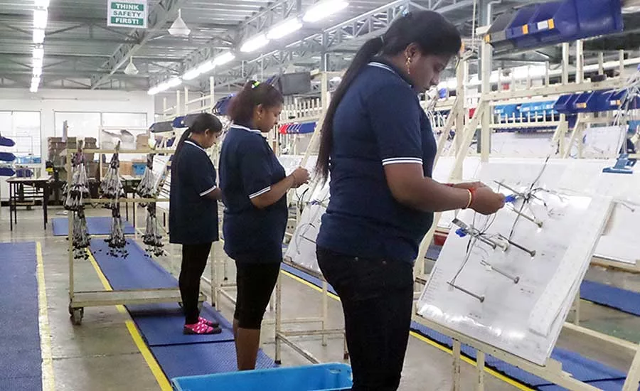

Poor postures are common with wire harness production, because most assemblers stand and bend over.

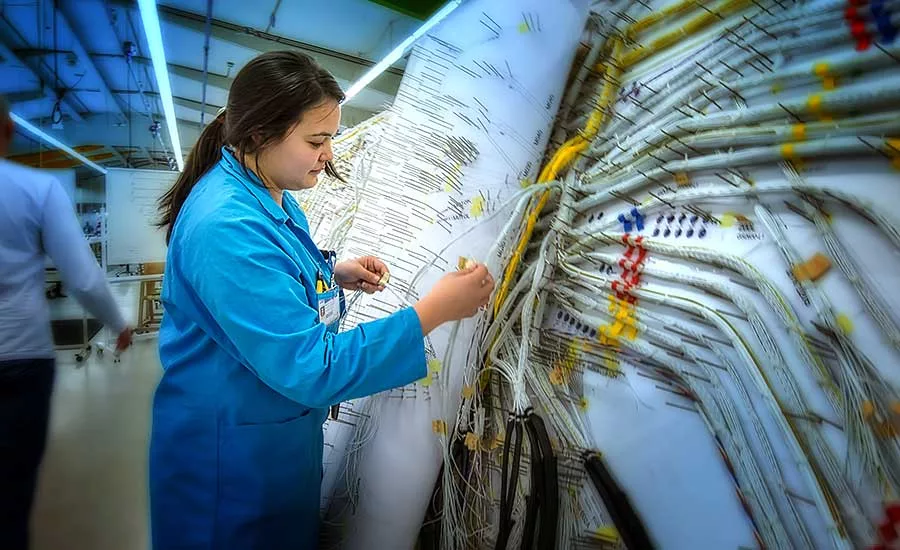

Carpel tunnel and tendonitis are two of the more common repetitive motion injuries associated with wire processing.

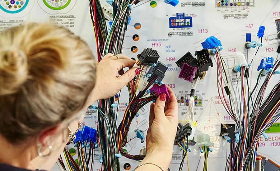

Inserting wires into connectors can cause finger and hand injuries.

“The body parts at the highest risk of injury are calves, hands, necks and shoulders,” notes Roth. “Poor postures are common. That’s because most assemblers stand, bend over at their necks and hunch their shoulders. Hands also have to perform a lot of repetitive tasks that require forceful movements.”
“Wire harness assembly is very hand intensive,” adds Julia Abate, executive director of the Ergonomic Center of North Carolina. “Anytime you’re doing any manual tasks that are repetitive, such as wire cutting, stripping, crimping or wrapping, there’s a greater risk for injury. Holding wires or fitting wires into connectors requires a lot of two-finger and lateral pinches, which can cause problems.
“Seated work is OK, as long as there’s not a lot of reaching,” explains Abate. “But, the majority of wire harness assembly work is done standing.”
According to Abate, engineers should also pay careful attention to how much force is required for insertion. Another often-overlooked fact is that a lot of women work in wire harness production.

“For high-volume, low-mix wire harness production, workstations equipped with a hand crank and a manual tilt mechanism work well,” explains Simmons. “But, electric height-adjustable tables are preferred by manufacturers that specialize in low-volume, high-mix production.
“That enables operators to easily access different corners or sides of a harness,” Simmons points out. “On large boards, they can easily raise it to work on the bottom or lower it to work on the top. It eliminates the need to bend down and reach up all day, which can impact productivity.”
