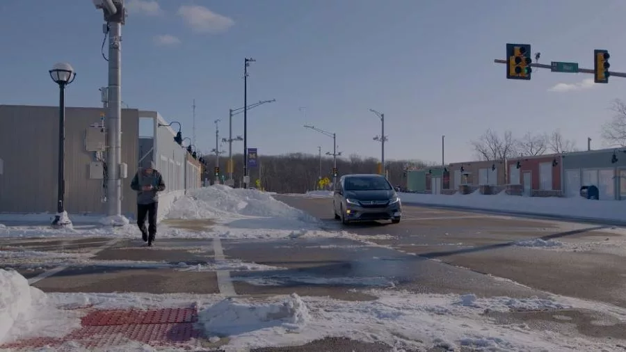

ANN ARBOR, MI—Engineers from Honda Motor Co. and Verizon Communications are testing 5G technology at the University of Michigan’s Mcity facility here. Mcity is a test bed for developing connected and autonomous vehicle technology.

  • Pedestrian Scenario. A pedestrian is crossing a street at an intersection. An approaching driver cannot see the pedestrian due to a building obstructing the view. Smart cameras mounted in the intersection relay information to MEC using the 5G network. Verizon’s MEC and V2X software platforms detect the pedestrian and vehicle and determine the precise location of road users assisted by Verizon’s hyper precise location services. A visual warning message is then sent alerting the driver of the potential danger.
