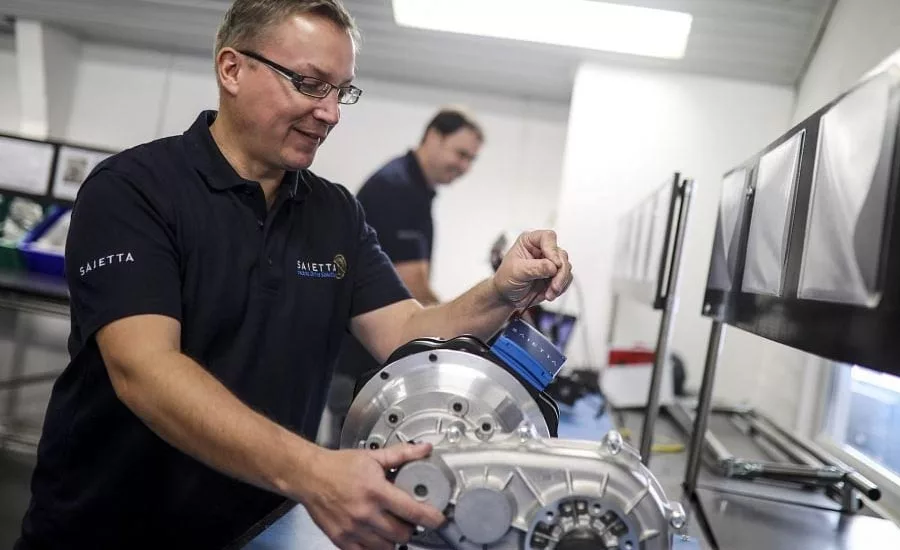

The Axial Flux Traction motor is modular, lightweight and affordable. Photo courtesy Saietta Group

Startup manufacturers of electric traction motors need to find a way to scale production as demand increases. Photo courtesy Saietta Group

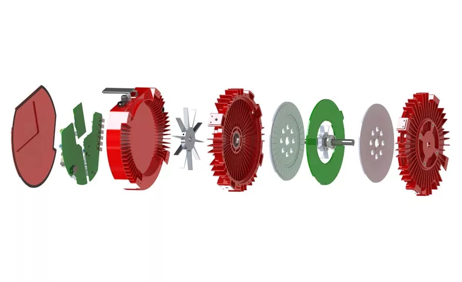

Easy-to-assemble components are critical to cutting-edge electric motors that will drive next-generation electric vehicles. Illustration courtesy Infinitum Electric
Assembling Electric Vehicle Motors
Electric motors are one of the most important parts of EV drivetrains. Illustration courtesy Infinitum Electric

Many entrepreneurs and start-up companies are scrambling to develop innovative EV motor technology. One of them is Saietta Group, a UK-based firm pinning its hopes on a new motor that is suitable to a wide range of electric vehicle applications.
Its Axial Flux Traction (AFT) motor is modular, lightweight and affordable. The unique design features a dual-rotor, axial-flux permanent magnet combined with distributed windings and a yokeless stator. Saietta’s first commercial offering, the AFT140, is designed for use in midsized motorcycles and final-mile delivery vehicles. But, the company claims that other versions of the AFT motor can be used in other types of EVs.
Thanks to a grant from the UK’s Advanced Propulsion Centre, the company is in discussion with a variety of automakers and Tier 1 suppliers. The grant enables production to be ramped up to 150,000 units a year at a pilot plant in Oxfordshire. But, Saietta’s long-range plan is to mass-produce millions of motors annually. To help achieve that goal, the company is collaborating with Brandauer and AEV Group.
“Brandauer specializes in stamping, and it is helping us scale up the cutting and packaging of grain-oriented steel,” says Wicher Kist, CEO of Saietta. “AEV specializes in potting electric components, which need to be conductive for heat rejection, but insulated from an electrical point of view.”
According to Kist, the unique design of the motor’s coil will affect how the AFT is mass-produced.
“Around 99 percent of electric motors have a steel structure, which is used as a bobbin to coil the copper around,” explains Kist. “But, we’ve created a discrete coil, which is similar to the coil of an antenna.
“With that, we kink it to make sure the current on one side is aligned with one magnet and aligned on the other side to make a circuit.” Kist points out. “We’ve done that 96 times, [then inserted] six busbars on each side to create the circle.
“The coils are then laid in a circle and arranged in a spiral,” adds Kist. “The assembly, at that point, is designed to be automated as we ramp into mass production, as opposed to hand built, which is the initial phase.”
Next, the individual discrete coils go down a conveyor belt and are paired up—to get the current in and out—before being dropped into a stator ring, potted in a curing machine and placed back onto the assembly line.
“One of the companies we’ve worked with is Royal Enfield, which makes motorcycles in India,” explains Kist. “However, it wants to make the motor slightly bigger and glue two together. The have also expressed an interest in keeping motor manufacturing in-house.”
To Infinitum and Beyond
Another fresh approach has been developed by engineers at Infinitum Electric, which has created an electric motor that uses a printed circuit board (PCB) stator. The company has developed a device for household appliances called the IEh series that is 50 percent lighter, 30 percent quieter and 10 percent more efficient than traditional electric motors. It also recently agreed to provide its IEm series motors to a North American supplier that is involved in the development of a hybrid vehicle.
“[We] pull out the iron and copper windings from the stator of every motor and etch copper conductors into a circuit board”, says Ben Schuler, CEO and founder. “The removal of the iron makes for a [much more efficient], smaller, lighter, quieter and more durable motor.
“Our contract with an automotive supplier is for R&D and applying oil-cooling techniques to the stator,” explains Schuler. “We’ve found throughout the process we can increase power density and performance of the stator by applying oil to cool the motor instead of air, like we do on other products.”
“We build the whole motor, but the IEm Series—unlike [our] general purpose product—is not a standard product line, because we don’t have a standard mobility offering,” he explains. “Although we design products to our customer’s needs, there are a lot of off-the-shelf solutions. A lot of the cars are different, so they have different power and voltage requirements.”
Schuler says the long-term goal for his company is to become an e-motor supplier to large automotive OEMs. He’s confident vehicles equipped with Infinitum motors will be on the road in the next two to three years.
“[Our unique attribute is something] that no one else has done on the EV side of the market,” claims Schuler. “That’s removing the iron and using a circuit board that is already in the car. With that, we can get higher efficiency and remove the core losses.”
Another advantage is in raw material savings. “Our electric motors are smaller and lighter than most others, which is important, as the whole movement to electric vehicles is built around climate change and being more efficient,” says Schuler. “Transportation of raw materials is a massive contributor to climate change and something that we want to reduce.”
According to Schuler, the biggest challenge to EV motor manufacturing is the long development times. “It’s more about OEM development cycles and less about motor [production], although you still have to create and approve the motor,” he points out.
“We have a proprietary design software platform where we can input the specifications of the user, hit enter and our design file can then be sent to PCB shops all over the world,” explains Schuler. “We can create samples in days or weeks, as opposed to months or years, which some products take.”
Another advantage of Infinitum Electric’s innovative design is that is doesn’t need the traditional capital investment required for a traditional motor assembly line.
“They go through a lot of different production stages, but ours is a simple PCB and we can print out thousands of them very easily,” claims Schuler. “It is a drastically streamlined production process.
“Our process is fabless,” says Schuler. “Much like some of the models of some semiconductor manufacturers, we’re ordering off-the-shelf components, and the only capital costs are the molds and castings for the housing. And, if a customer wants us to use their housing, we’ll do that.
“We’re really only aggregating the components, testing them and shipping to the customer, as opposed to a traditional electric motor manufacturer that has to stamp the laminations, wind the windings and everything else,’” adds Schuler. “Their way is much more labor-intensive.”
Infinitum Electric’s production is currently around 5,000 units, but through a combination of scaling up its own facility and also using contract manufacturing partnerships, Schuler says the company will reach “hundreds of thousands of units a year” by 2023.
