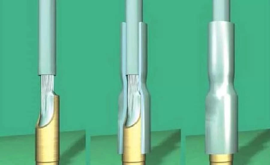

Section 4.6 of the A-620D standard provides a detailed explanation of how insulation sleeving should be applied to a wire within a harness. Graphic courtesy IPC

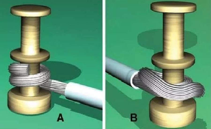

Proper terminal wire wrapping is covered in section 4.8 of the A-620D standard. Graphic courtesy IPC
