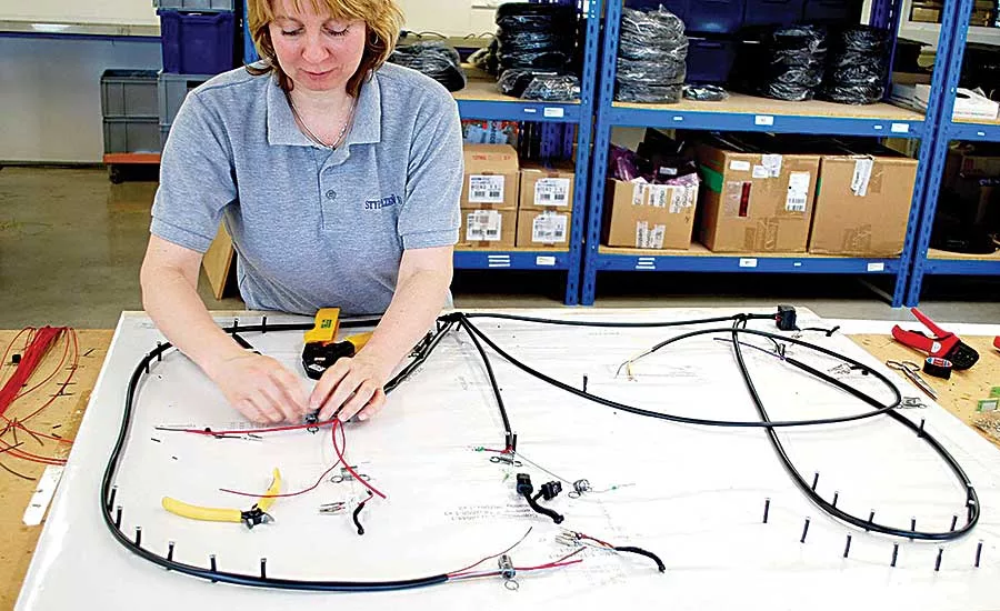

The A-620 standard is being followed by harness assemblers in 42 countries. Photo courtesy Styl Plzen

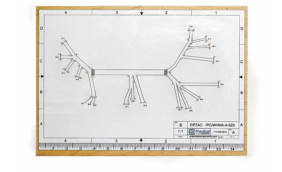

Certification training on the IPC-WHMA-A-620 standard often involves hands-on harness assembly on dummy boards like this one. Photo courtesy Practical Components Inc.

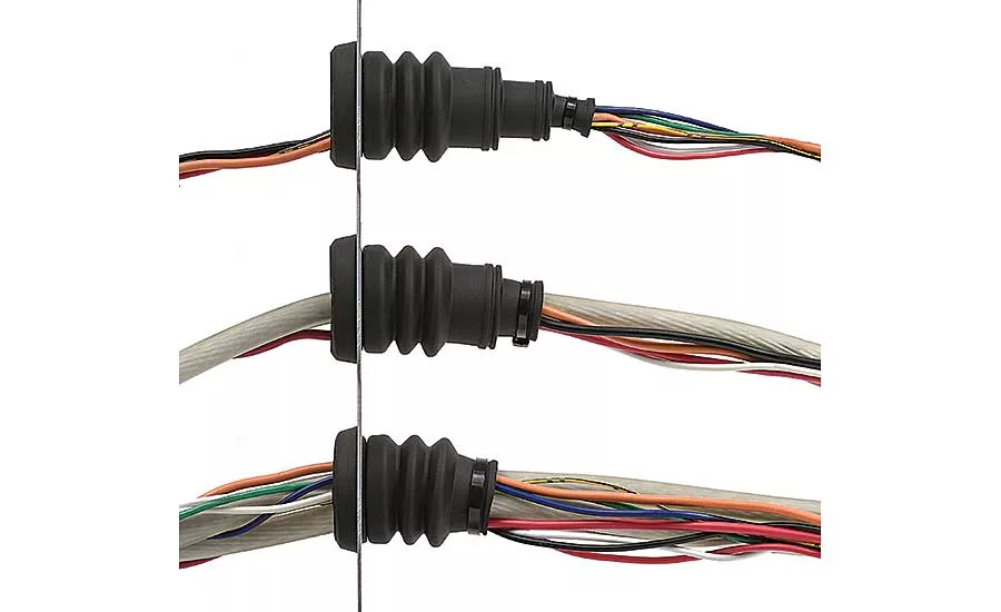

Revision C of A-620 includes entirely new sections covering safety wiring, safety cable, wire seals, grommets and raceways. Photo courtesy Daystar Products International
