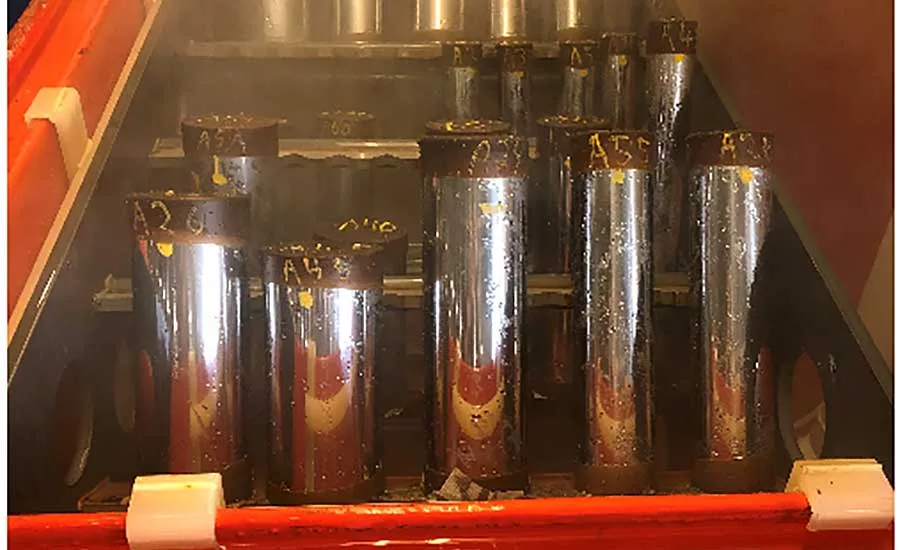

Within every skid-steer, side loader, forklift and snow plow are multiple lift-cylinder rods made of steel. And on the outside of each of these rods is a chrome plating that prevents corrosion and extends wear life. Geneva, IL-based Industrial Hard Chrome Ltd. (IHC) specializes in applying chrome plating to these rods, as well as tubing and machine-cut blanks.
“The worst thing you can do to an installed rod is to not use it,” notes Bruce Tucker, quality manager at IHC. “Depending on the machine, the rod may sit engulfed in hydraulic oil at times. But, often it’s exposed to the elements. Chrome plating keeps the rod from corroding due to exposure.”

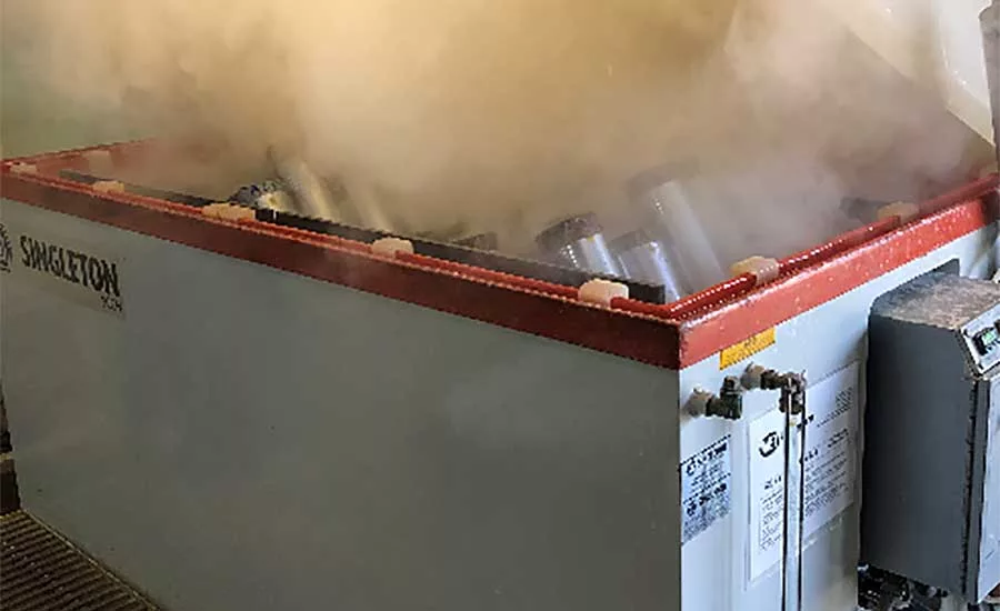

After plating, the rods undergo ALT based on ASTM B117, Standard Practice for Operating Salt Spray (Fog) Apparatus. IHC owns, and uses daily, three specially designed chambers (made by Singleton Corp.) for this type of testing.
Up to 50 16-inch-long rods at a time are placed in each chamber to see how well the chrome plating withstands accelerated exposure to a salt fog and extreme temperatures. Each rod is cut from a 24-foot-long plated steel bar, according to Tucker.
Before testing begins, a stainless steel bubble Humidifying Tower is filled with deionized water and mounted on the outside of the chamber. A premixed 5 percent saline solution is poured into two other beakers with internal funnels. These beakers are attached to different towers, which are placed inside the chamber at designated locations.
Next, the operator sets the air pressure, pH and temperature parameters. Finally, he places two PVC racks into place, puts the rods on top (each at a 15-degree angle with some space in between) and closes the chamber.
When the operator turns the chamber on, the air goes into the Humidifying Tower before picking up the 5 percent saline solution and spraying it through the two internal towers. A salt fog mist is evenly applied to the rods during testing.
“Each chamber is opened every 24 hours, but only for the shortest time,” explains Tucker. “The technician first checks the beakers to see how much saline has been collected. Collecting about 1 to 2 milliliters per hour is standard. Then he rechecks the parameters to make sure they’re correct.”
This cycle is repeated until the rods have been tested for at least 200 hours. Nearly every IHC customer requires a testing time less than 200 hours, but Tucker uses this number as a barometer to make sure the chrome plating is the highest quality possible.
When testing is complete, the technician opens the chamber and removes the beakers. He manually records the amount of saline collected and other related data on a log sheet. Shortly thereafter, he enters this data into a proprietary software program for sorting and analysis.
“The rods are then removed and carefully examined for any signs of corrosion,” says Tucker. “Only when the data verifies that the chrome plating has passed the ALT and each rod has no sign of corrosion does the order get shipped.”

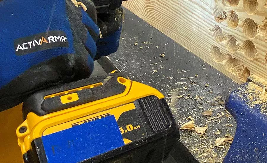

As the world’s largest manufacturer of power tools, SBD faces a unique daily challenge: Maintaining and expanding its customer base to stay at the top. The way the company meets this challenge is by producing high-quality tools.
Testing has been an essential part of making such tools for more than a century, notes Brendel, although not all current tool brands made by the company have been around that long. These include Stanley, DEWALT, Black & Decker, Craftsman, Porter Cable, Mac Tools, Proto and FACOM.
“We make many different power tools, in various versions, and each of them undergoes many tests, including ALT,” says Brendel. “To handle this volume, we operate several large test centers globally, where new product development takes place as well. SBD also has a test lab in each of its manufacturing plants throughout North America, South America, Europe and Asia.”
A power drill, for example, may go through up to 20 different tests as part of an ALT program. These tests are done at every stage of development—from prototyping to final production—and can include the tool enduring many thousand cycles of operation.
One common drill test involves applying a simulated load with a braking device to the tool. SBD engineers then determine how much current the motor draws in such a situation, and how much additional load is placed on the motor and transmission.
“In general, every tool and every system has a unique test method we’ve developed based on years of data and refinement,” says Brendel. “All of our products go through ALT during new product development, after any design changes, and on an ongoing basis when in production. End-user research always directs our development of test specs and methods, to make sure we’re designing the products to meet the customer’s needs.”

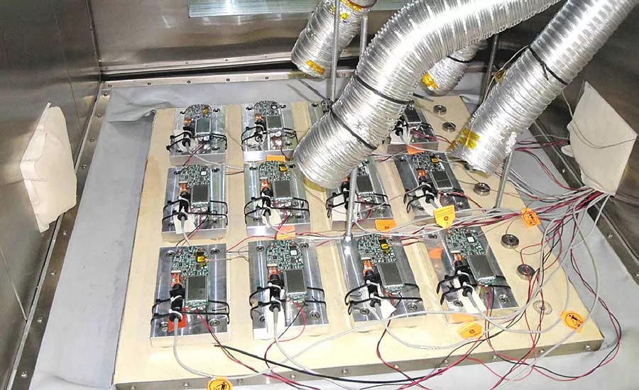

One customer recently asked DES to perform HALT on a new circuit board design that featured potted componentry. This test involved exposing several boards to hot and cold temperatures, followed by rapid temperature ramping, vibration and combined temperature and vibration stresses.
According to Delserro, the hot and cold temperature step exposed one hard failure (design weakness) and multiple soft failures, such as power resets and lack of communication. The boards did function properly during the rapid thermal ramping and vibration steps.
However, the combined temperature and vibration stage revealed the same problem as that shown during the hot-cold test. In addition, the potted componentry cracked on multiple boards during testing and caused communication problems.
DES completed its testing in three days. A relatively short time, objectively speaking, but long enough to show the customer a product design weakness that most likely would have caused several warranty and reliability issues down the road.
