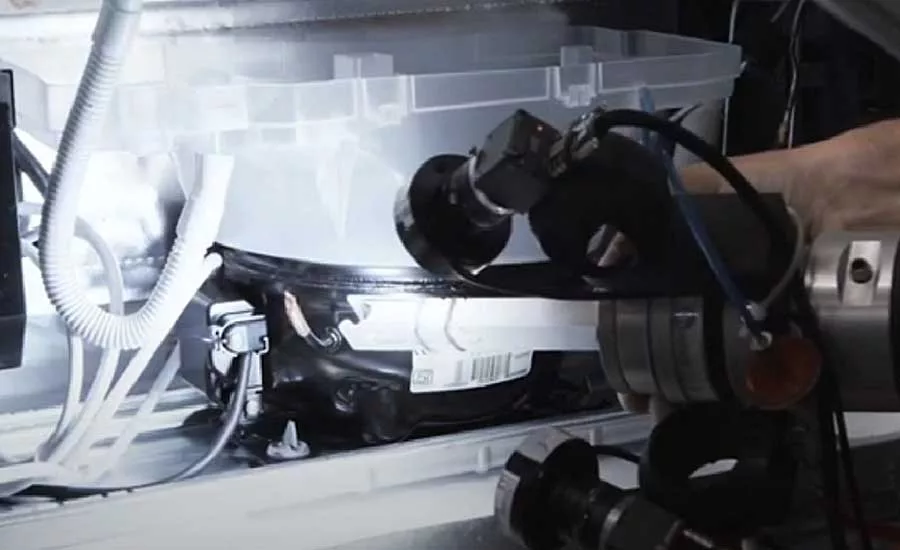

This automated testing system involves running a unique sniffer probe (white piece) along metal pipes and compressors at the back of the refrigerator to check for leaking coolant at the solder joints. Photo courtesy Micropsi Industries

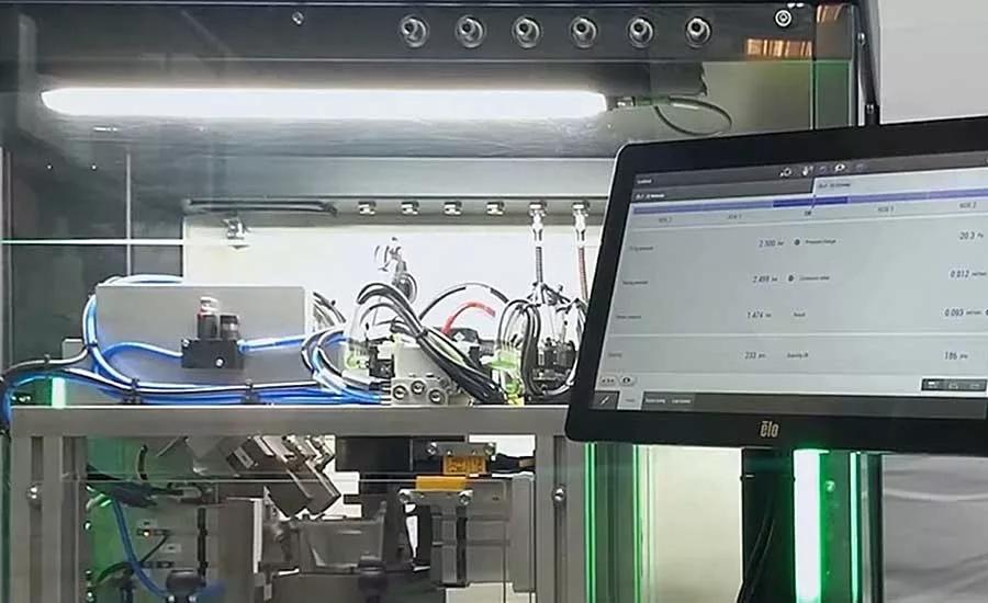

After a part is automatically leak tested in the ZEDstation, a green or red light indicates if the part has passed or failed. Photo courtesy Zeltwanger Leak Testing & Automation

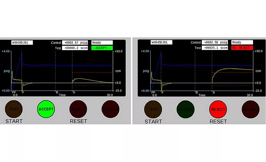

The M1075 leak tester is equipped with a multi-function control panel, and a small mass-flow sensor that can speed up testing by as much as 30 percent. Photo courtesy InterTech Development Co.

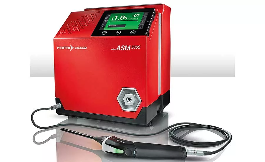

Fast, precise and repeatable testing is possible with the ASM 306S leak detector. Photo courtesy Pfeiffer Vacuum Inc.

BSH Hausgeräte GmbH (BSH Home Appliances Corp.) is one of the largest home appliance manufacturers in Europe. Recently, it implemented automated leak testing of each refrigerator made at the company’s plant in Esquíroz, Spain.
The automated system provided by Micropsi Industries consists of an Inficon E3000 multi-gas leak detector connected to a Universal Robots cobot arm. The detector uses an in-house-designed sniffer probe, and MIRAI controls the arm using artificial intelligence (AI) and vision cameras.
Leak testing involves running the probe along metal pipes and compressors at the back of the fridge to check for leaking coolant at the solder joints. Because the back of each model is unique in terms of position, color, shape and amount of soldering points, the process was performed manually until early in 2021.
"MIRAI’s machine learning technology [helped us] solve a challenge we could not solve with standard automation technology," notes Javier Chasco Echeverria, Industry 4.0 engineer at BSH. "All cycle time, accuracy and key performance indicators have been reached, improving our productivity and quality."
MIRAI helps a robot perceive its workspace and correct its movement while performing a task. Echeverria says the benefits of using MIRAI at BSH include reliable identification of all inspected solder joints; and real-time response and millimeter-level precision placement of the probe regardless of joint position, shape or color.

The M1075 leak tester from InterTech is equipped with a small mass-flow sensor that can speed up testing by as much as 30 percent. Hoffmann says this is because the sensor has a much faster reaction and recovery time back to zero than larger sensors, and it requires a much lower pressure drop across the sensor to obtain a measurable flow. FastFill and Ex-Heat features speed-up testing of large volumes.
The tester stores 40 million test results and 99 test programs, and it can be operated as a stand-alone instrument or interfaced with a PLC or PC. Other standard features include a bar code scanner interface, simplified calibration, Ethernet/IP connectivity, real-time test cycle displays, and a touchscreen control panel.

Fast, precise and repeatable testing is possible with the Pfeiffer ASM 306S leak detector, regardless of whether helium or forming gas is used as the tracer gas. It is designed for continuous use on production lines, and offers a high sensitivity of 10-7 mbar l/s.
McLaren says the device helps refrigerator and air conditioner manufacturers perform leakage control using sniffing measurements before the final refrigerant gas charge. Another benefit is its ergonomic high-flow sniffer probe, which an operator can comfortably hold during an entire work shift. The probe comes with various hose lengths to easily adapt to any application, and cables can be independently exchanged from the probe itself.
The ZEDstation, by Zeltwanger, enables high-volume leak testing of components as varied as water distributors, pumps, valves and fittings, and compressors. Measuring methods include relative pressure (single or multi channel), mass flow rate and differential pressure, in combination with fixtures, a bell test or accumulation chambers.
“Customers can combine leak and functional tests as they need to, using air or tracer gas, and the station’s modular design allows for quick changeover with different test parts,” explains Schwoerer. “Each part is loaded in the fixture manually or by a robot for a fully automated test. A green or red light is then displayed, indicating that the part has either passed or failed. After the part is ejected, leak rate data is displayed on the station’s large touchscreen. More than 1 million test results can be stored for future reference, or transmitted via Industrial Internet of Things protocols for full traceability.”
