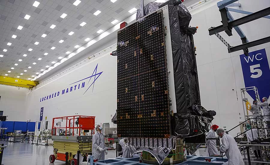

For the last several years, LMC has used AI to enhance the manufacturing, inspection and testing processes on several of its satellite programs. Caldwell says the technology significantly helps the accuracy of inspection and analysis during the critical testing stage before a satellite is launched. AI has also been applied to stages like PCB assemblies and the thermal vacuum testing of parts, subsystems or a complete object, like a satellite.
Another area where AI currently benefits LMC is in satellite production. Caldwell cites the example of it needing a way to speed production of new satellites—and AI being a necessary tool to achieve this speed. In 2018, the GPS III satellite customer extended its contract. As a result, LMC needed to ramp up production.
By applying AI, the engineering team was able to maintain the satellite production schedule of the customer’s current and follow-on contracts. It also gave the team more time to focus on developing next-generation GPS technology rather than monitoring repetitive data.

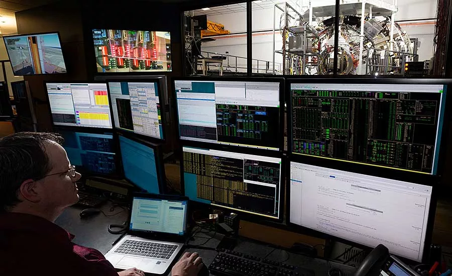

Since 2017, LMC has worked closely with NEC Corp. of America to apply AI and machine learning (ML) for system diagnostics to spacecraft production. This collaboration covers applications on NASA’s new Orion spaceship for the Artemis missions that LMC is building. The same AI and ML technology will be used for real-time analysis of Artemis III during its mission, which is scheduled for 2024 as a dry run for a Mars mission sometime after 2028.
According to Caldwell, the project involves the integration of NEC’s System Invariant Analysis Technology (SIAT) software into LMC’s Technology for Telemetry Analytics for Universal Artificial Intelligence (T-TAURI) AI platform. T-TAURI has been used to analyze data throughout various production processes with great success.
The goal is to achieve “‘proactive anomaly detection” during the design, development, production, and testing of spacecraft, notes Caldwell. Data from IIoT sensors placed in sundry industrial systems (computers, power plants, factories, buildings) is used by the SIAT analytics engine to automatically detect inconsistencies and prescribe resolutions.

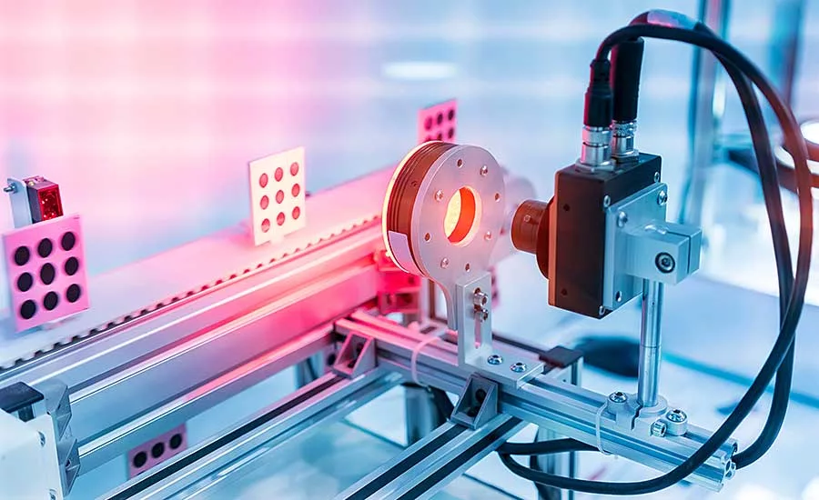

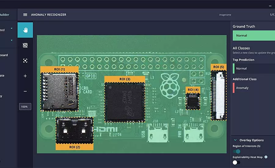

Long-term users of VIA include large electronics contract manufacturers that assemble integrated circuits (IC). These manufacturers produce a high mix of both standard and custom ICs in small batches for their customers. The batches consist of frequently changing components, which are notoriously difficult to inspect with traditional machine vision. Assembly, inspection and testing are done at their facilities, along with manufacturing product prototypes.
Visual inspection is often performed in conjunction with X-ray inspection and functional testing, notes Versace. VIA enables the companies to carefully inspect ICs for any body markings, and to identify incomplete solder traces, missing components or those in the wrong orientation.
Some prefer using VIA only on custom products made at a lower volume. In that case, the software collects images through an application interface, rather than a standard GigE Vision one.
Injection molding companies are another common user of VIA. They use the technology to inspect plastic parts after molding and post-processing.
“Typically, visual inspection for part quality is done by a human operator when it involves large customers,” explains Versace. “However, this only ensures that, in general, the molder is sending good parts. The customer then does [its own] manual inspection of every part before using it in any assembly.”
VIA-based inspection requires a GigE camera installed on the assembly line, and a switch to control the conveyor that transfers parts after deburring. As each part moves under the camera, it takes multiple photos of the part and the software quickly analyzes them.
When the VIA spots a defective part, the PLC flashes a signal. This tells the operator to remove the defective parts from the conveyor, carefully inspect them and determine which ones to scrap and which ones can be reworked.
“All of this happens without the operator needing to understand anything about AI,” adds Versace. “And, that’s a huge plus.”

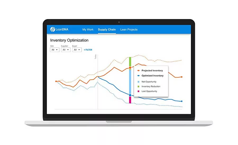

LeanDNA is a software as a service (SaaS) platform that integrates with a plant’s existing ERP software to optimize the management of inventory used in assembly. Photo courtesy LeanDNA
Acronyms abound where AI implementation is concerned, so why not add another one: SaaS, which stands for software as a service. LeanDNA is a SaaS platform that integrates with a plant’s existing ERP software to optimize the management of inventory used in assembly.
Manufacturers in many industries have implemented LeanDNA since 2014, according to Lebovitz. One company is UK-based Safran Seats GB, which is a world leader in the aircraft-interior-products market.
A couple years ago, Safran managers in operations supply and purchasing realized the need to replace antiquated material procurement processes. The original processes regularly resulted in Safran’s three facilities not having enough of the correct parts at the correct time, and too many of the wrong parts sitting in inventory.
“The operations supply team was spending 10 to 15 hours per week creating manual reports in Excel spreadsheets,” says Lebovitz. “The problem with this is it limited the accuracy of inventory data and resulted in deliveries being three to six months late, on average.”
Safran turned to LeanDNA to automate and standardize its shortage management workflows. Within a few months, Safran achieved a 36 percent inventory reduction. Another benefit is increased efficiency and responsiveness of the overall procurement teams. Safran analysts can now easily check on the inventory needs at each facility before transferring excess or obsolete inventory to other divisions or aftermarket operations.
LeanDNA also helps Safran identify opportunities to correct item master data, supplier lead times and bills of materials. Any anomalies to these items are now immediately flagged, tagged and corrected—enabling teams to accurately forecast future demands and find their just-right inventory.
“Each inventory action in LeanDNA is prioritized by the amount of value it will bring,” explains Lebovitz. “This makes buyers compete to see who can deliver the most value to the business and be at the top of the inventory actions metric.”
